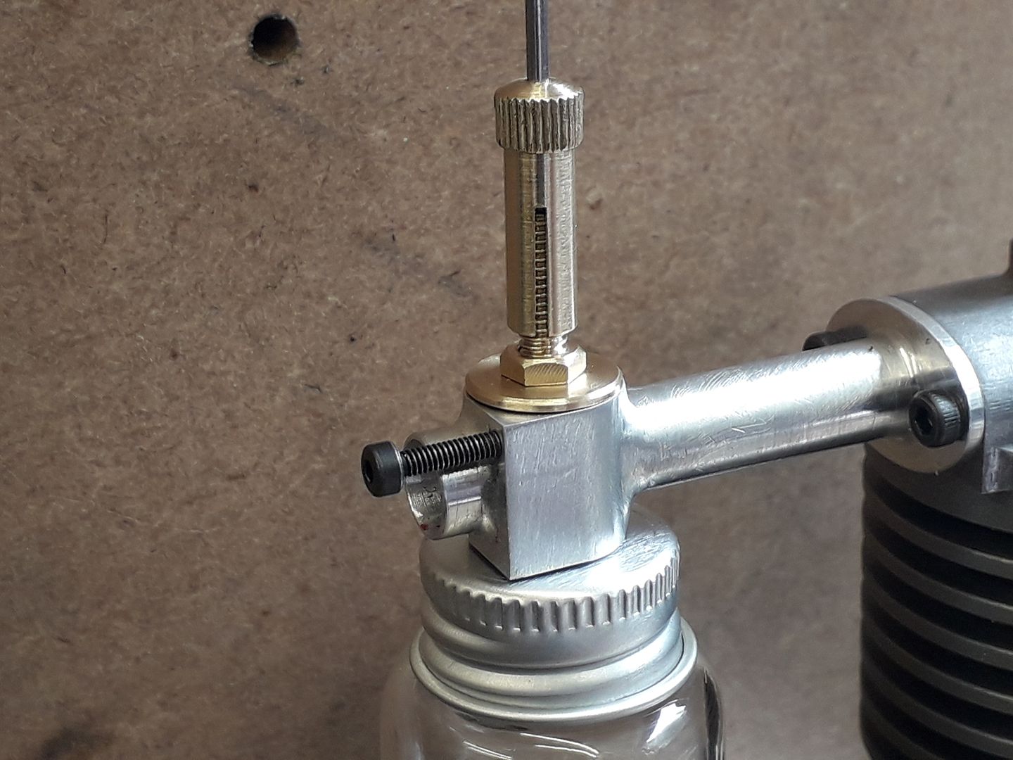

The carb body was carved from a length of 20mm 6082 aluminium, after facing off and drilling the ctr hole it was over to the  CNC using that to cut the elliptical flange and drill the two mounting holes under size.
I then tapped the holes so that a piece of 1.5mm thick stainless steel could be held and cut to a similar shape, this was used as the mounting flange for the exhaust.
It was then back to the lathe to complete the turning of the long central section which was done with a 1.0mm radius grooving tool as I wanted a fillet in the two internal corners.
Then with the part reversed in the chuck the same tool was used to form the inlet spigot.
The remaining 20mm dia section was then milled down to a 12mm square and a hole reamed through it for the carb's barrel to rotate in. The rough looking area at the upper far side of the hole is a tapped hole for the slow speed adjustment screw.
Not the best photo of the barrel which has been cross drilled for the airway and a flat milled at right angles for the above mentioned slow speed adjusting screw to bear on
The rest of the parts were fairly straight forward turning jobs so no photos taken. From a while I have wanted to use a jam jar for a fuel tank as a lot of trawling through e-bay finally found some suitable jars that could be built into the design. The throttle is controlled by twisting the jar rather than having a separate arm though one could easily be added.

Jason the engine sounded great. I am curious about your twisting the glass fuel bulb?

The jam jar is connected to the throttle barrel so I turn that rather than the usual lever. There is not that much throttle response unless I lean it out a bit more but then it soon gets hot with no air movement so I was running it a bit rich and tweaking the advance/retard to get the slow lumpy tickover I wanted.
