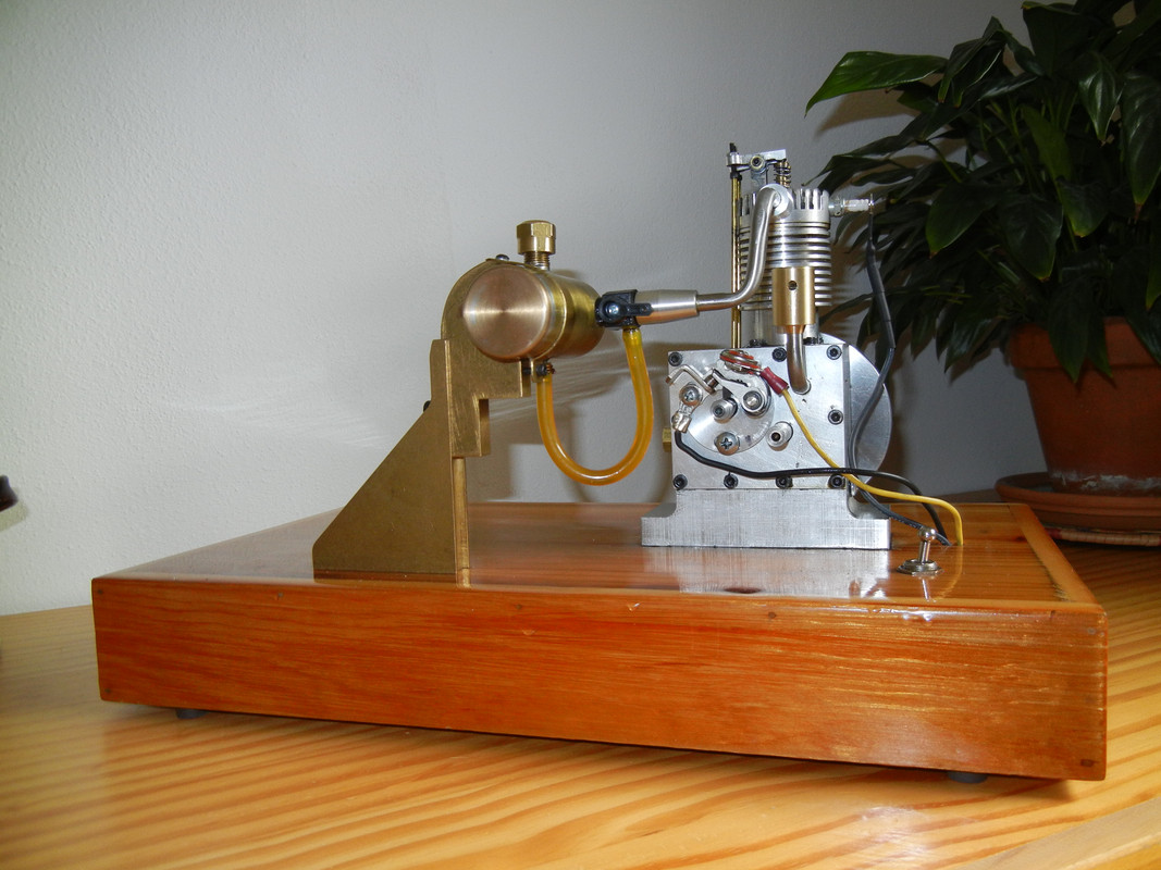

Hi everyone,
Some of you who were at the Zanesville engine show know that I had my Upshur single apart for repairs. Over the last year or so I had been noticing that it was running worse & worse. Before the show I took the head off to see what was wrong and found about a 16th of an inch of carbon built up on everything in the combustion chamber. Then yesterday I took apart the crankcase, this is what I discovered.
The Piston looks much worse in the photo than it really is. But as you can probably see the rod journal is very rough, and the rod bearing is oblong about .040". There are scuff marks on both sides of the connecting rod from it hitting the cylinder. Also it shifted up enough to hit the center of the cam.
This Is what it looked like in its prime. I think at the least a new rod and crank are needed. I had redesigned the head already, had hoped to have that in time for the show but the computer for my mill died so that has been postponed till my computer guy has healed up from surgery after his vacation. No I didn't ask.

No you aren't in left field. It was designed to run aluminum on steel, apparently it has fairly good lubricant qualities as a bearing. There is a center drill hole at the end of the cap which lubes the crank. Any question is a good? I think bronze would wear better but be more of a PITA to make.

Also I might add It was originally designed with less cooling. I modified that when I was told it would idle all day but overheated when the RPM was higher. I did at one point in time run it at about 6000RPM for 20 minutes and melted the Perry carb I was using, it didn't ever stall from overheating. I must admit in the last few years it hasn't run very well, now I know why.
