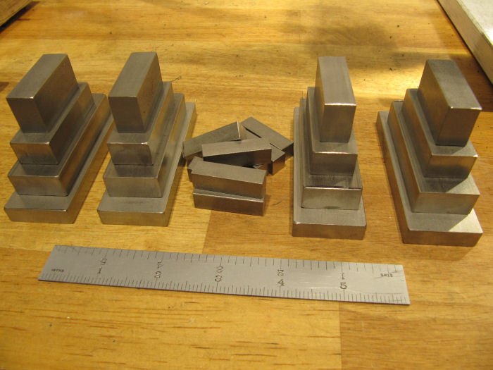

Its a touch over 4 pounds of flywheel with 1.5 inch pistons, so it needs good support. The stack next to the ruler is what the pillars will look like, screwed together from underneath. The two small squares on top are the bearing holders, once shaped. There will be one pillar each side of each crank, like in the drawing in the first post of the thread. Should have first assemblies by Thursday.

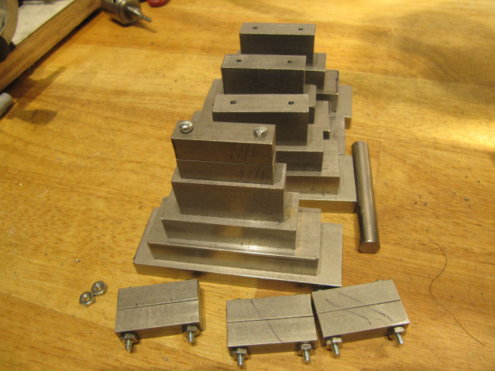

More work done today on the crankshaft support pillars, all the ends were trimmed off and the holes for the screws to hold them together drilled/tapped. These pictures should give a better idea of how they are going together, with some 1-1/2" long 10-32 SHCS in from the bottom.
The smaller square blocks will be drilled/shaped to form the bearing holders/caps, and will screw down onto the top of the pillars. Still need to drill the holes in the corners of the largest bottom blocks to mount them all to the floor plate.
The shape of the pillars and the steps were nothing special, worked out that way from the sizes of the bar stock I had handy - tried different combinations till I found one that was the correct total height.

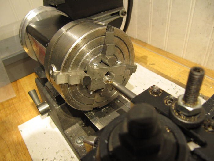

While waiting for sundown to go see the Marion lights, finally got some metal-shop time in today. Drilled the bearing blocks/pillars for the mounting screws:
and drilled/bored the holes in the blocks for the bronze bearings:
