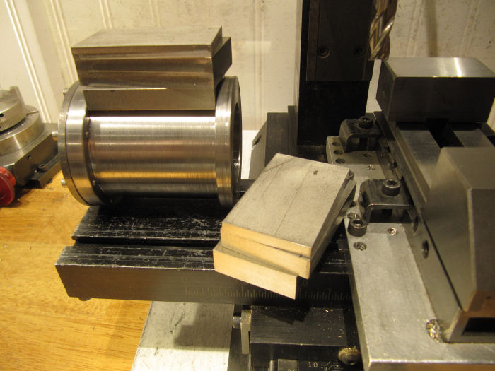

This morning got the blanks for the steam chest bases, chests, and lids cut out from larger bar stock and milled down to size (leaving room for bosses needed for connections).
With that done, will probably mill out the center of the steam chest next, then start drilling holes...

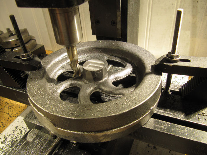

While examining/fondling the flywheel, noticed that the hub had some taper to it which would make holding it with the 4-jaw chuck un-secure, so was playing around with the faceplates to figure out a good way to secure it for truing up and hub boring. I was curious to see how the cast iron in the flywheel would cut, so clamped it down on the mill table to flatten off the casting sprue remnant, and also milled in some little flats on all four sides for the 4-jaw to hang onto.
The alloy Martin uses cuts like butter, very nice and smooth (just like the metal in the little vise kit did) - very happy with that. The last big flywheel I did was on the MEM Corliss build, where I used a cut-off of a large bit of iron plumbing pipe - that stuff was nasty to cut, lots of variation in hardness.

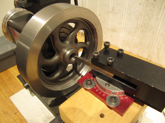

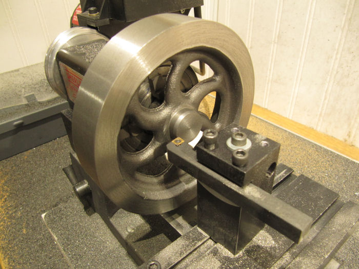

Today I got on a roll  ::)   with the flywheel. Put the riser blocks back on the lathe, and got the flywheel mounted in the 4-jaw chuck. It took a little experimenting to find a happy medium spot for it, since the two sides of the casting were slightly mis-aligned from each other (plenty of extra material is there to true it up, so no problem there). Started cutting on the rim first, evening up the outside then moved in to true up the hub.
Several places where the 'skin' on the casting was a little tough to cut through, the inside was nice and even, cuts nicely. Then put the other tool in to do the inside of the rim:

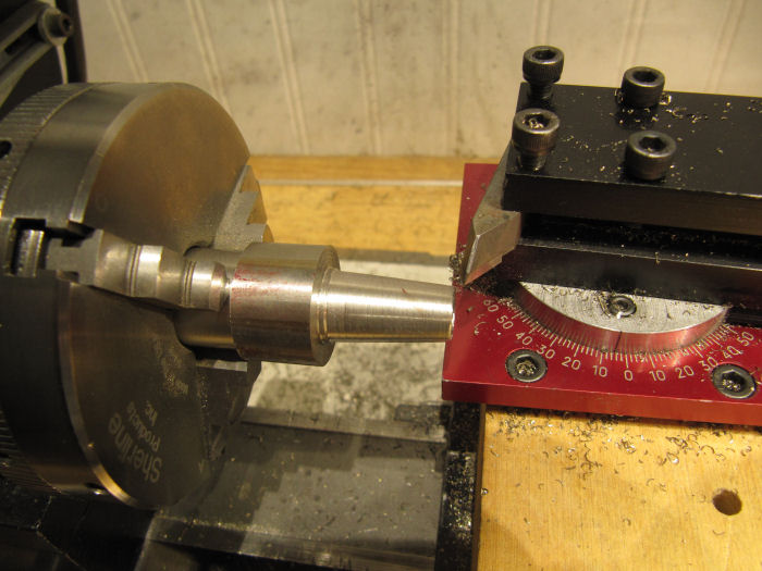

Put on the compound cross-slide (don't have Sherlines riser for that, but a hardwood block sufficed) and set it to 6 degrees, cut the taper through the center hole:
Took the 4-jaw and wheel off, and chucked up a piece of stainless bar to make the locking part of the hub - turned that to a matching taper, with a little of the taper still sticking out of the hub. Doesn't show well in this picture, but this piece is drilled to match the crankshaft too - the taper runs down to the hole.

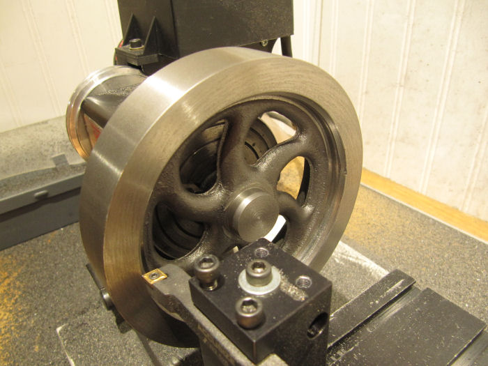

Here is what it looks like in the flywheel:
Next time I will put the flywheel on the mill (will screw the 4-jaw onto the rotary table) to drill/tap the holes through the lock and into the flywheel hub for the screws that will tighten the lock into the hole, compressing it around the crankshaft (there will be a slit made down one side of the lock so it can flex). One thing I learned years ago from Chuck (basically learned this whole setup from him) is to also put screws in to push the lock back out of the flywheel, since once tightened it is very hard to pop it back out again without damaging anything. It may work out that on this one I can put nuts on the tightening screws, between the lock and the hub, to perform that function. If so, then I'll just need two screws. This type of mount works very well, and does not tend to tip the flywheel like a grub screw would. The only downside is that it requires a large enough diameter on the hub for the lock and the screws - this casting was picked partly since it had a larger hub than some of the other choices.
