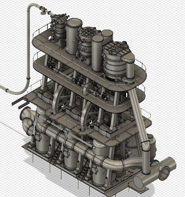

Another option is the Ward Pumping Station engine(s) - there are 5 there, would only build one! I have a copy of the original builders blueprints, and have been converting them to a 3D CAD model:
This engine is ginormous, about 60 feet tall, triple expansion. I was thinking of a cutaway version to show the innards and valves/pumps, like you would see in a museum display, with a hidden motor to turn it to show the motion. Or maybe have two cylinders cut away, third driving the model? Whichever way, this would be a very large model to get all the parts functional.

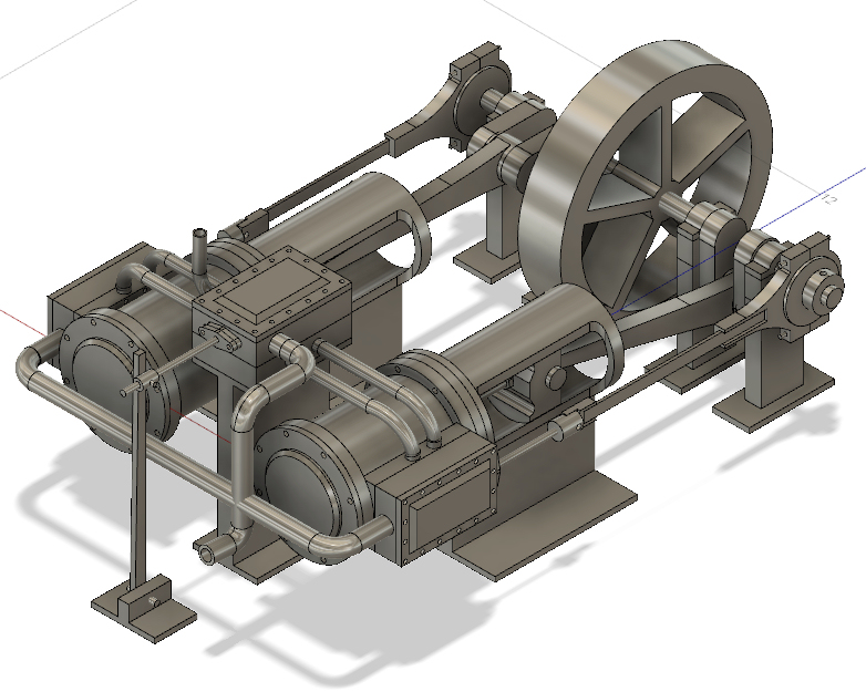

Other option, more likely to build since it would be a shorter-term project, is a design I've drawn up that combines the Marion slew/crowd engine valve design with a mill or winding engine style. This valve setup makes a reversing engine with no extra eccentrics or external linkages, it does it all with internal porting. By making a winding engine style, the cylinders are separate so I could make them larger - a 1.5" bore x 2" stroke, which should make for a nice slow running engine. The center block is the throttle/reversing valve.

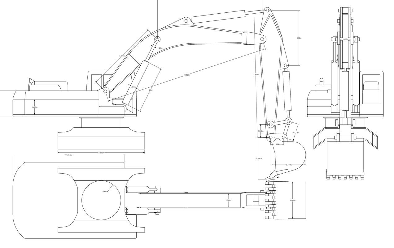

Another background project is an RC version of a Caterpillar 340D excavator - a modern hydraulic digger, that will have electric motors geared down to leadscrews inside the booms to simulate the hydraulic rams. There ARE true hydraulics available on the market, but they are quite pricey and VERY messy when a hose leaks. So far I have the motor/leadscrews 90% built, couple more parts and I can do some mockups and force tests to see if they will have enough strength for real work. This will be at about 1:15 scale, maybe 1:14 or 1:12, have to see what fits. More on this as it develops. Or, maybe dropped if the force is not enough - should work out, using 172:1 gearmotors hooked to 4 lead leadscrews, initial tests show lots of power when trying to hold it back by hand. The tracks, not shown in this drawing, will use some RC tank tracks that are the right size.

It looks like the port faces on the Stanley could have been done with a shaper on the full size but the issue for the one off builder is the ports which would have been cored during casting and would be very hard to machine on a miniature let alone full size.
If you do go with "Big Marion" My personal thoughts are that the crankshaft bearing supports look to be on the light side and compared to the cylinder/trunk guide part of the engine they look small, if doing it as a mill engine then I also think a larger flywheel would be more in keeping, what looks like a 4" flywheel is quite small for a 1.5x2 twin, possibly drop the whole engine down and have a slot in your display base or model a brick or stone base which would also reduce the need to have the engine raised on those legs.
A lot of the RC truck and heavy plant model makers do use mini hydralic rams, it is a very popular hobby on mainland Europe particularly in Germany. Even some of the ready to run stuff is packed with functions that you could possibly transfer to yours rather than start from scratch
