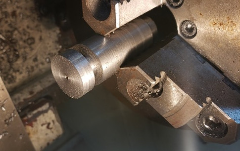

In this picture I’m just starting on the ratchet.  This is the gizmo that is fixed to the mandrel on the secondary shaft and helps control the cycling of the slide valve and ignition of the engine.  Both the ratchet and the secondary shaft drive gear are fixed to the mandrel.  This mandrel free wheels on the secondary shaft until the pawl engages the ratchet to carry the whole secondary shaft around.  Hopefully, the video at the bottom of this thread will help explain this operation.
Below is a follow-up photo of the ratchet, a bit further along.
And below, a final photo of the completed ratchet (actually not quite complete; it still needs the keyway broached but I didn’t have the broach when I took the photo).

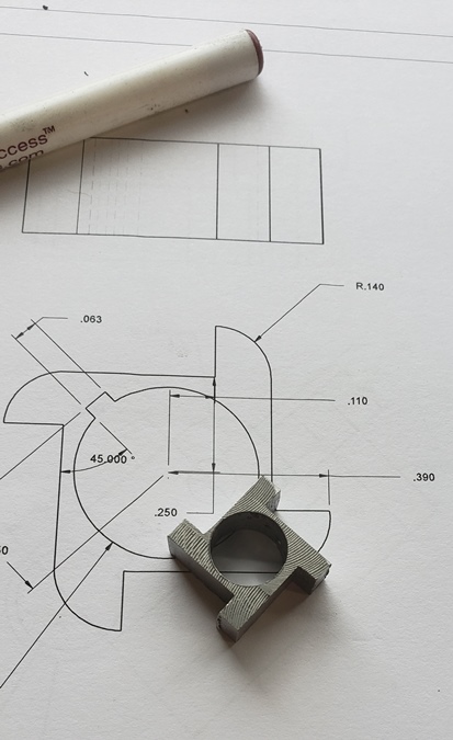

In this photo I’m starting on fabrication of the first part of the pawl.  Here I’m reaming the opening where the pawl will attach to the secondary shaft.
Below is a much further along photo of this pawl part.

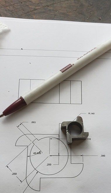

In this photo I’m starting work on the second part that comprises the pawl.

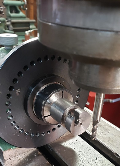

Moving to my indexing head I’m continuing work.
And here I’m nibbling away material I can’t really address any other way.
The remainder of the work was completed with the piece mounted vertically on the mill, using my rotary milling head.  This is a photo of the completed second part of the pawl mechanism.

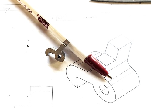

Below is a picture of the components that make up the secondary shaft.  Some you’ve seen before while others are new.  Top left is the mandrel and to its immediate right is the ratchet.  Further right is the driven gear.  Both the gear and the ratchet are mounted on the mandrel and keyed to the keyway in the mandrel.  The mandrel rides the secondary shaft at the bottom of the photo.
At the bottom, far left is the starting gear which you’ve seen before.  To its right is a lift link that attaches to the secondary shaft and lifts the rack and piston.  Further to the right is the pawl mechanism.  Two brass bearings you’ve seen before fill out the parts list.
