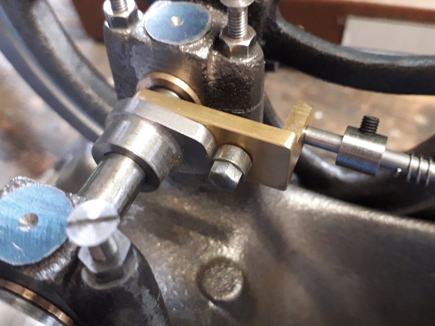

I think it's time I let you know about an improvement that was tried on CHUK 4. This engine is still not finished, but the idea is sound.
Instead of the cam pushing against a roller and spring to operate the shutter CHUK 4 lifts the roller that is mounted to some 1mm by 15mm Flat Ground Stock. This has a 10 mm slot milled lengthwise ( Scotch yoke like ) and uses the crankshaft as a guide. The improvement lies in the fact that a compression spring isn't there to sap energy from the system.
The choice is yours however Jo, but that's what I'll be doing.
I'd suggest using small precision ball races for the roller, big end and gudgeon pin as it makes quite a difference to the overall output power that's pretty low from the start.
Almost the home straight in sight Jo, pretty sure you'll win.
Cheers Graham.
I had been thinking about a pull rather that a push shutter mechanism: I would like it to have a look/feel more like the original Planck mechanism and have been reviewing some other Flammenfresser designs but none were a inverted engine :noidea:
As I've stated many times, I have a " thing " for inverted engines Jo, look at my Avatar. CHUK 2 is a
" ME " engine.
Ultimately the choice is yours, the compression spring offers little resistance to the overall running.
My friend Mike Rodgers from Nantwich had several cam discs produced via the relatively new CNC process, where the profile was milled as a slot. A small roller was made to follow the slot, we called it a " Desmo " drive. He nearly died when he went to pick up the finished parts, never got a price, nigh on £200.00 for 10 cams. A small fortune 20+ years ago! Backyard stuff these days.

The slot option sounds good Graham, I was wondering how the lifted shutter would close again if there was no spring to pull it back down onto the cam. Jo you can send me a drawing if you want a CNC groove
For the scotch yoke option is the horizontal slot larger than the pin to give some time where the shutter is stationary much like you had on Nattie
Ah, but there's no need for a slotted cam on CHUK 2 Jason. We have good old gravity acting for us, the mass of linkage, shutter and roller all help to reclose the port as the cam rotates.
I'm wondering if my term " Scotch yoke " is perhaps a little misleading here? I'll try and get out to the workshop and grab one to photograph.
Cheers Graham.
  • Posts: 9493
Re: Two little CHUK's
« Reply #86 on: September 09, 2019, 04:19:51 PM »
Graham, if you mean that the slot is vertical to go around the crankshaft and keep the rod vertical then I know what you mean. Very similar to this arrangement on my RMC engine except the pin or roller would be on the left of the crankshaft to lift it rather than as shown on the right where it is pushed down.
You can stay in the warm now ;)

Or even this
LOL
That's exactly what I meant Jason, spot on.. :ThumbsUp:

So the next question is will the shape of the cam need altering?
That cam would have held the shutter down for longer when pushing but will hold it up for longer now it is lifting.
