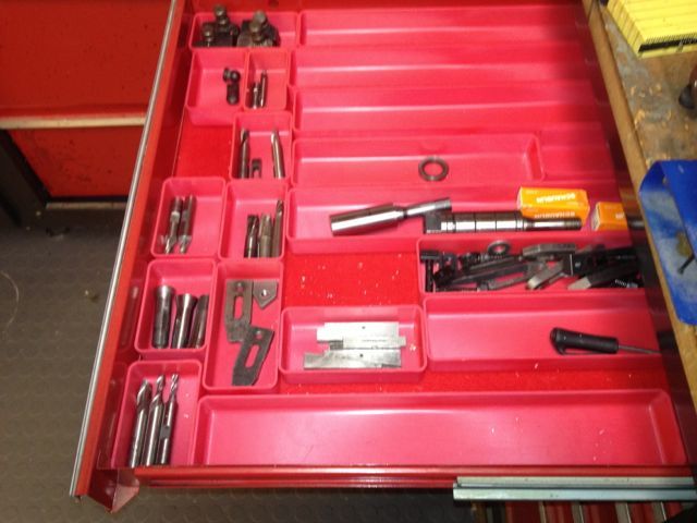

My trivial problem with drills is how do you affordably store the dozens of loose extras rolling around in a drawer in an organized, sorted way? Is there some simple trick storage cabinet, little envelopes, etc.,??? after you spend hours sorting them into impossibly close sizes of numbered, fractional, metric, lettered, ugh.? After all, you need a hundred or more slots x 5 or 10 extras of a size.
