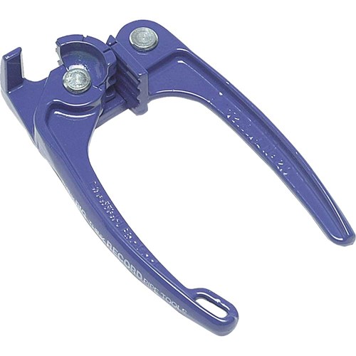

A bit of a saga with the manifolds. I was going to do them all in stainless, I had plenty of seamed ¼” tube and a shortish length of seamless. The seamed tube doesn’t bend very well and certainly not tight bends. With our dairy and wine industries one thing we don’t have a shortage of is stainless steel but the minimum I could purchase was 6metres for NZ$150. Malcolm’s write up for the Bobcat suggests copper so I decided to try that.
I made sure I had the dimensions correct for the jig plate for soldering. I did it in CAD and then checked the job. Drilled the plate and you’ll see it all ready to go in my previous photo. Soldered it up and then came in for dinner. After dinner, the job had cooled down, I took it off the jig and checked it against the engine. Too short by 7mm!! I’d used the dimension for the inner set of holes between the and inner and outer row. I am getting error prone these days and its beginning to bother me. Anyway, it all had to come apart and be done again, fortunately I managed to recover the central manifold.
As for the exhaust the short length of seamless tube was sufficient so I didn’t need to purchase any more. You’ll notice that I haven’t done the double bends as in my original CAD design as the pipework would have ended up too close the carburettor to be comfortable. If you are careful the 1/4" seamless stainless tube can be bent with one of these

I am always tempted to buy some Cerobond. It is a solid metal at room temperature, but liquefies at about 180 degrees. Supposed to be the cat's meow for bending small diameter tubing without kinking. You heat it up with boiling water until it turns to liquid, pour it into the tubes, wait for it to cool off and solidify, bend your tubes, then heat the tubes up in boiling water to pour the Cerobond out. It's like a lot of things---I've heard about it but never actually used it.

I've used pipe bending springs for 12mm/0.5" upwards, when doing plumbing. I recently obtained some small dia tube springs at a club auction but they don't go up to 0.25" although 0.25" springs are available.
Cerobond I guess is Woods Alloy. I imagine that it would make the bending a bit harder so you still need a suitably sized bending tool
The other trick, with larger diameters, is sand.
