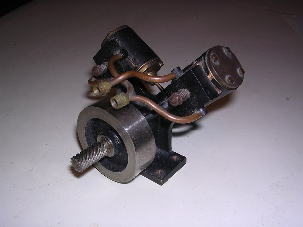

Coming on nicely, Jo. You have just reminded me that I made one whilst I was at school and this is it! It could do with a good clean though, rather than the cursory dusting it has just had. This was my solution to the plumbing challenge. Many ways of skinning a cat!
What's next?
Steve   :)
