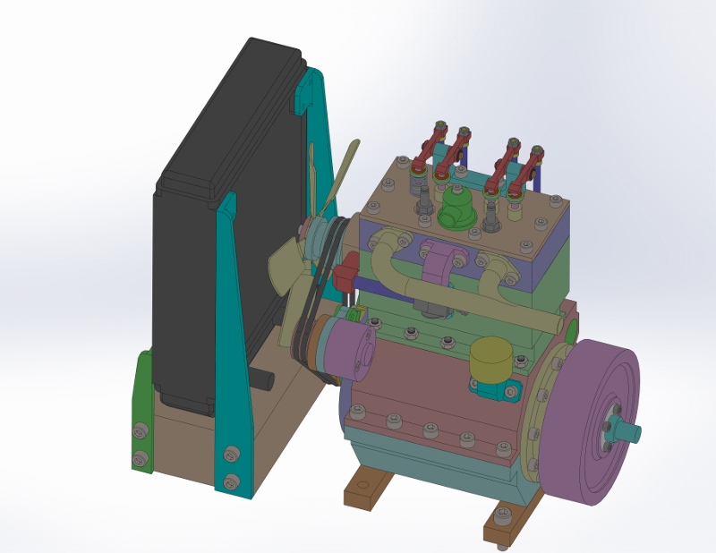

Hello,
I've inserted your Otto, Jason.  ;)
He is really tall.
I made something on your model again. I think that with a 49 teeth clutch gear comes better than with the 46 teeth gear.
For 49 teeth, the rack is exactly in the middle of the hole and the two shafts are the same distance from the hole.
In addition, the rack is the same thickness as the long guides.
I do not know if it's that easy to mill a rack thinner.
I found racks M1.5 in 17x17mm, 15x15mm and 10x10mm.
Then I found a coupling HF1816, with the dimensions 18x24x16. At first I thought to take a HF1616 16x22x16.
However, I think that the larger leadership of the clutch is advantageous if you take a 15mm shaft.
Greeting Toby

Hi Toby, I find it quite interesting how these computer generated drawings depicts the 3 dimensional aspects of the components !! as i only use pen and paper i am always conscious of making my drawings spring to life  !! I have a lot of books with varying examples of how other people tackle this........ .Good luck with your future builds also.....
Willy

Hi
Jason, I have to redraw the bearing block because the imported file has no sketches.
Willy, the great thing about the 3D models is that you can see if everything fits together. If not, you can change it.
So you can recognize errors in drawings.

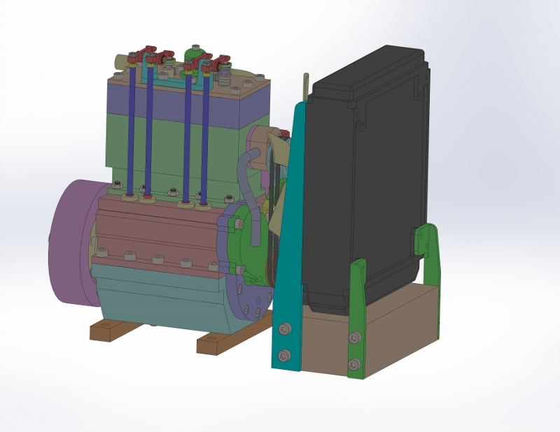

« Reply #9 on: April 14, 2019, 05:35:21 PM »
Hello,
I did something about Otto Langen's drawings.
Now comes the difficult part:
I have to understand how the eccentrics play with the valve.
The following is written in the drawings of Phlil_L:
The High Point of the Slide Valve Eccentric should be in horizontal position with the high point towards the rack. Srew the yoke with the valve slide up and down on the valve rod.
I hope I got it right.
Figure A01 shows the eccentric in this position.
Figure A02 shows the appropriately set valve.
Figures B01 and B02 show the position where the ratchet is fixed and B03 the moment when the rack releases the ratchet via the lever.
The exhaust is slightly open.
The window in the slide valve is above the gas and air inlet.
Figures C01 and C02.
The eccentric rotates 90 degrees further.
The valve goes down.
The exhaust is closed.
The window in the slide valve is above the gas and air inlet and now also above the inlet to the cylinder.
Figures D01 and D02.
The eccentric continues to turn 90 degrees.
The valve goes up.
The exhaust is open again? Why that?
The window in the slide valve is located above air inlet. The inlet to the cylinder is closed again.
Picture E01 and E02.
The valve continues up.
All channels to the cylinder are closed.
The breaker of ignition is released, it is detonated.
Picture F01 and F02.
The lever that blocks the ratchet is free because the piston is up.
The ratchet is stuck again. The eccentric can not turn further.
The engine should generate a vacuum. How can that be with the exhaust open?
So far, so good, but I do not understand it.
Something else that I do not understand.
In the drawings of Lenaz, Phil_L and Julius, the holes and windows in the valve gate are always slightly offset in the port face.
Is this a typographical error or is it intentional?
Maybe someone knows advice, my head is already smoking.
Greeting Toby
