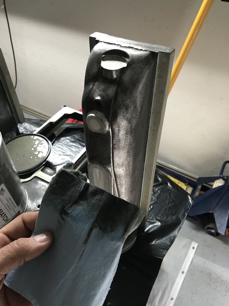

What a momentous occasion.  Today is a day of firsts.  Not only am I posting same day pics of my progress, but I've also delved into a fairly proper job of painting!   :cartwheel:
Being that this has been my first foray with "proper" painting, I was quite happy with the results thus far.
The paint is a "direct to metal" alkyd enamel.  I did a fair bit of research, and the overwhelming census was that an alkyd enamel is the most appropriate paint to be using for such an application.
However, I began looking for paint locally at Sherwin Williams, and I was quickly talked down.  My only alkyd enamel option required a minimum of 1 gallon, when I only needed a quart, and I was only presented with the single option of primer + paint.
I include this only in the hopes that it might help others.  Youtube user "BasementShopGuy" aka Brad was kind enough to offer a paint code for some Benjamin Moore DTM (direct to metal) paint, which I could purchase in a quart size.  Well, everything worked out here.
Then..  b.lindsey had to come along and suggest powder coating!   :hammerbash:
All kidding aside, I'm now infected with this notion of finding a place to try some powder coating.  Since I had already purchased paint, and worked myself into relative preparedness for painting, I decided to forge ahead!
I love these sawhorses, but I'll try not to run down a tangent.  I had a sheet of MDF, and some trash bags, and this was how my adventure began.
I began preparing the metal using acetone on mechanics shop towels.  However, it didn't take me long to realize this was leaving bits of towel behind, and possibly compromising the quality of the paint job.
The ram was apparently my first application, and I felt like it went really well.

Thank you very much for the kind words.  I'm hoping it will all show well in the end.  I just had to rescue the parts from rain dripping from my garage door again.  I decided to very carefully relocate the parts on the end, which are prone to being dripped on.
