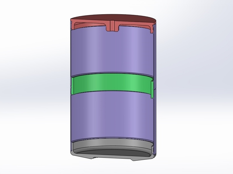

The last parts needed are the displacer pistons. I have been contemplating these pistons for quite some time, but I couldn't push them off any longer. Ideally the dispacer is made from a material that doesn't transfer heat easily and isn't too heavy. Thin wall stainless tubing comes to mind. Of course, finding stainless tubing in the right dimension is next to impossible.
What I came up with instead, is to assemble the piston out of multiple parts. The tubing will be machined from stainless steel with 0.5mm wall and will be threaded at both ends. To make machining more manageable, the tube will be assembled of two pieces. The top and bottom will be made from aluminum. I allow for a 1mm gap between the hot cap and the displacer.
To better illustrate my plan, see the CAD rendering below:
I sourced a piece of 312 stainless steel tubing off eBay that had pretty close dimension of what I needed.

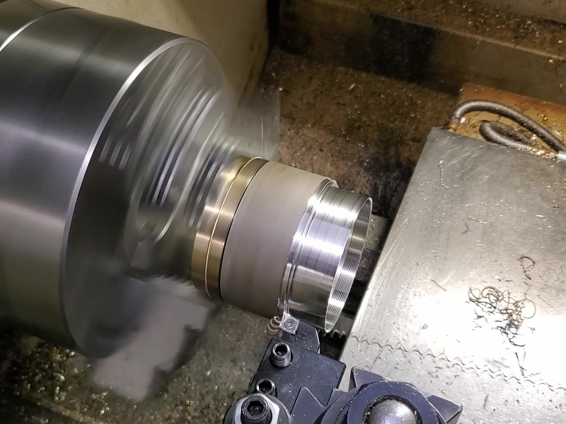

First operation was to finish the inside diameter and thread one end.
To hold the part for the second side machining, I cut a thread on a scrap piece.
Ready to machine the second side.
Now the tricky bit. As I was machining most of the material away, down to 0.5mm wall thickness. I decided to machine to final dimension only short sections at the time. This will leave a bit of a mark on the transition of each section. Since the displacer is not going to be seen, I was more than willing to accept that.
Success! I was quite skeptical at first and was relieved that my plan worked.
