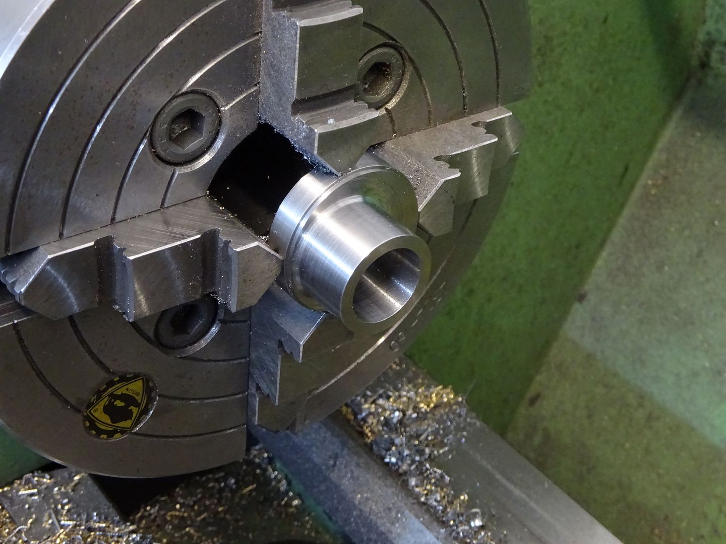

Cheers Craig.....it WILL work :)     Next bit is the piston. It will be cast iron, originally thought of a 3 piece piston with 2 rings. Overkill? next thought was a 2 piece with 1 ring. At present I lack a boiler so this engine may never run on steam :'(     so what about o rings and if so what sort....silicon, viton, etc?  I need help here please.          Terry

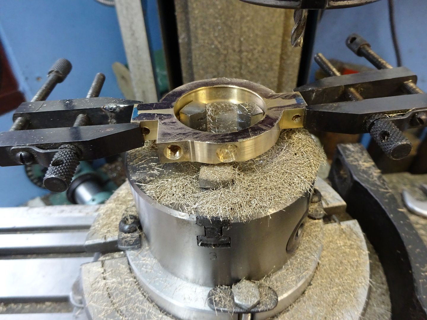

As no  o-ring information is apparent I have decided to go for 1 cast iron ring, after all it may run on steam one day.    Another problem I have to sort is the eccentric sheave.  It can be seen in the photo that is an awkward shape. It could do with a casting or(shhh) cnc!    The bit that travels
in the eccentric is 0.170 wide and 1.070 dia. I have some brass that thick to which I could solder lumps each side :help:  and I have some CI from which to hack it.  If anyone reads this and can offer advice I would appreciate it :shrug:       Regards            Terry

Missed the request for O ring info, what's the finished bore dia.
Brass would give you the option to make it in two halves from flat bar, the oil box and two webs could be milled with the aid of a rotary table after plunge drilling a hole with an end mill to take a turned boss which could be silver soldered into place.
Same could be done with CI machined from a slice of round stock and the boss JBWelded in as there is no real load on it. Could even solder/stick the oil box on if you wanted.

This is the sort of sequence I was thinking of for the eccentric, did not show hollowing out the oil box or maybe threading it if using a drip feed which does not look right in the photo. You will need a small amount of hand filing where the radius of the cutter stops it getting into all the corners.

Swarf making after digression :)  I finished the piston to final size today, had to use some super glue to stop it revolving on the piston rod. I couldn't resist a temporary assembly to see if it will all work. I suspect I need to take about 3 thou of the base of the slide bars as it begins to bind slightly if I press the cylinder hard down onto the base.
Next job was the eccentric sheave. When I first looked at it a few days ago my mind went blank :headscratch: an appeal on here brought an instant solution from Jason and a "of course, why didn't I think of that response from me :Doh:  Good progress was made and another chance to use my new! soldering hearth.  One day I might get a better camera, then you can see my cockups in finer detail.           Terry :cheers:
