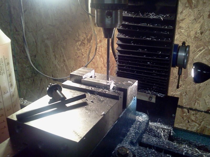

I did get a couple of relaxing hours of machining time this afternoon. So I managed to get the upright and cylinder completed. I took a couple of photos to document.
Drilling and reaming the pivot for the cylinder.
How to drill a 1/16" hole when your drill chuck won't hold that small. I picked up a 1/16" drill meant to be used in a quick change chuck for cordless drills. Only cost me $1.50US.
Edge finding the end of the cylinder to find center for the bore.
I did manage to get a relatively flat bottom hole. I agree with the knowledge here that it isn't really necessary for these engines, but I decided to take the challenge. I rummaged up a damaged 3/8" drill and reground the end to flat. Add a bit of relief at the lips and I was good to go. I used a standard point 3/8" drill to drill to depth and then used the modified drill to flatten the bottom. I had some reservations about re-drilling the hole because the second drill often does bad things to the hole because of rubbing on the sides. I got pretty lucky and it turned out well. Just .002" over the nominal size of .375" and no ballooned out center from side rub. And the finish, while not ground, is pretty good and should clean up pretty easily. I will probably hone it smooth with black85vette suggestion. And my depth is just .0015" short of print. I am quite satisfied.

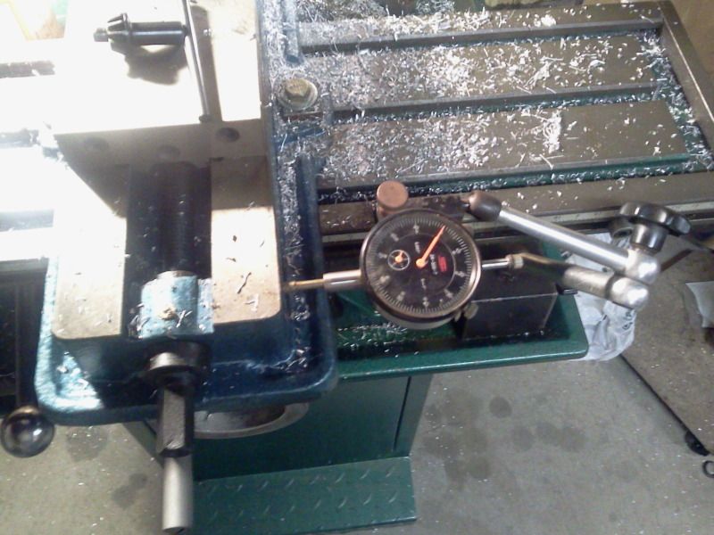

Old school analog DRO

Almost the easiest way to get your flat bottomed hole is to use a trick that is frowned upon, but can get you to where you need to be.
Drill down as far as the hole needs to be with one size smaller drill than what is needed, then, horror of horrors, mount up a milling cutter of the correct diameter into the chuck and just drill down to the overall depth required. If you take it very steady, that will clean up the bore enough for a little engine such as this, and give you the flat bottom hole that you desire.
I do this a lot when I am putting in counter bores for cap head screws.
I mention this because if you are not taking a lot of material out, then there is not much force on the cutter to cause it to slip in the chuck, which is what would happen if you tried to do full scale milling with a mill cutter in a drill chuck.
Another point, if you do use this tip, if you can, always try to use a centre cutting mill cutter.

Yeah using an endmill to make a flat bottom was my first thought also. But the hole depth is just a bit shy of 1.375" deep, (which I didn't mention - my fault  :-[ ). None of my 3/8" end mills are near long enough to reach. I did briefly consider relieving the shank of an endmill, but I wasn't sure I would have enough good shank left to grip properly.
