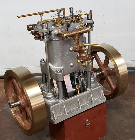

I haven’t posted on this project for a while but I’ve been slowly slogging along toward its completion.  It’s pretty much together at this point, sans the water pump and accessories (such as stand, fuel tank, water tank, electrics, etc.).
I’ve run into many more drawing errors; but errors on fabricated parts.  I also had to make modifications to the mixer in order to fabricate it and assemble it.  I have some silver soldering to do, mostly plugging the intake and exhaust manifolds where “drill throughs” were required in order to machine them.
Here’s a photo of the “mixer” side of the engine.  In this photo the intake manifold and mixer are evident.  I managed to fabricate the needle and spray bar in the opposite direction from where the drawings show, but then I’m left handed- so I figure it’s handier for me that way anyway. :shrug:

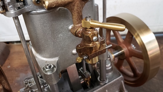

In this photo you get a better look at the mixer.  I really like the design of this mixer, I think it will work well.  The needle adjustment is the knurled knob on the left.  The throttle is the big lever on the top.

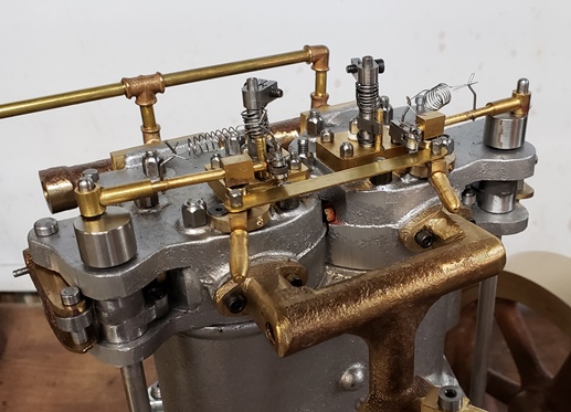

Here is a close look at the top of the engine from the mixer side.  The dual levers allow running adjustments to the igniters.  They are going to be a bear to set up but I’m thinking they may actually serve a function after all.

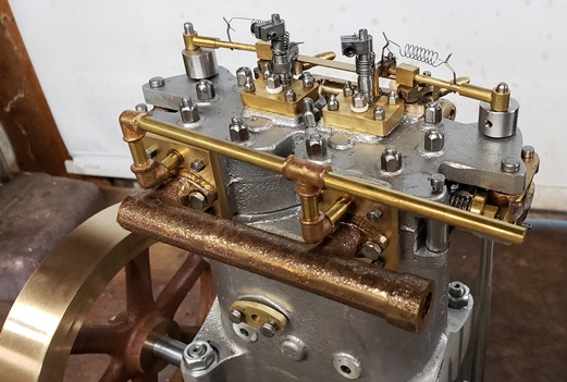

Here is a photo of the exhaust side of the engine.  The brass flange is the water inlet.  The two threaded openings in the cylinder walls are for lubricators- yet to be installed.
Here is a close look at the top exhaust side of the engine.  The large brass piping is the exhaust.  The smaller copper piping is the water outlet.
