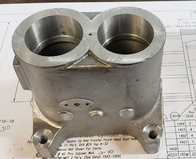

If you remember with the last update, I had uncovered an error in the drawings and was trying to determine what to do about it.  I finally decided that another casting was the only solution so I contacted Bob Banke.
Bob wouldn’t really confirm that the drawings were in error, but stated that he wanted the people that bought his models to have a good experience and if I needed another casting, he would send me one; free of charge.

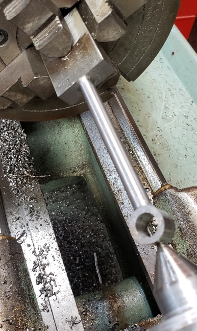

Finished up the lathe work on one of the connecting rods
but held off with the other.  I really wanted to get back to where I was with this cylinder casing and after a few days work, here’s the result.
Everyone’s been so nice, but many of you MUST be thinking it: so I’ll say it.  “You’d think that when the guy started boring the cylinders, and the bores were SO FAR OFF CENTER IN THE CASTING AND WERE SO FAR OUT OF ALIGNMENT WITH THE CORES, he would have checked the dimension????”  Yep, you’d think wouldn’t ya; well live and learn; won’t make that mistake again.
So as you can see, using the correct dimension, the cylinder bores center nicely in the casting.  Now I can finish the cylinder liners, one of which has been waiting patiently in the lathe, partially finished, since the beginning of this cylinder dimension fiasco.

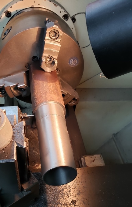

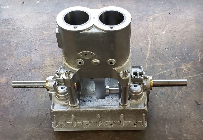

Yesterday I finished up the first cylinder liner and installed it.  Here I'm about to part it of the base sock.
Today I did likewise with the second.  I used a .001 inch interference fit and the liners pressed into place a bit harder than I thought they would; still they fit the cylinder bores nicely.  When I blow into the water inlet and close of the two water outlets I don’t feel any leaks.

Looking great now Craig.  Just a little hitch, but good to hear the casting issue was resolved with such good service. Onward and upward now.
« Reply #129 on: February 21, 2019, 12:27:46 AM »
That is a sweet looking engine!

You can see the liner has a shoulder at the top to prevent the liner from working down the cylinder bore.  The shoulder is 7/8th inch long.  With the casting overbored in the center to form the water jacket, the liner is in contact with the casting for only around one inch on top and around another inch at the bottom.
The liner is 4.155 inch in length and the wall thickness at the bottom is 1/16th inch, at the top, a bit more.

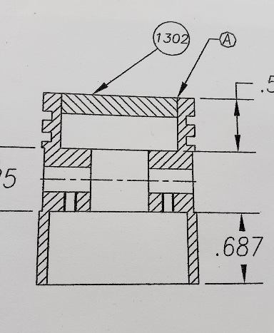

I’m looking at the drawings for the pistons and, really, I need your opinion.  Here is a segment of the drawing:
The supplied material is a cast iron round.  The drawing specifies that you bore out the top of the piston (I assume to reduce the weight), then silver solder in a round disk to seal the top surface.  The builders’ notes specify that after this is done, you are to turn the piston to size and form the ring groves.
To me, this seems a bit convoluted when you could just make the piston directly out of aluminum (with a solid top) and still end up with a lighter piston.  Since the crankshaft has no counter weights, I would think a lighter, aluminum piston might be preferred.  I’ve made lots of aluminum pistons for IC engines and had no trouble with them.
Your thoughts ?  :help:
