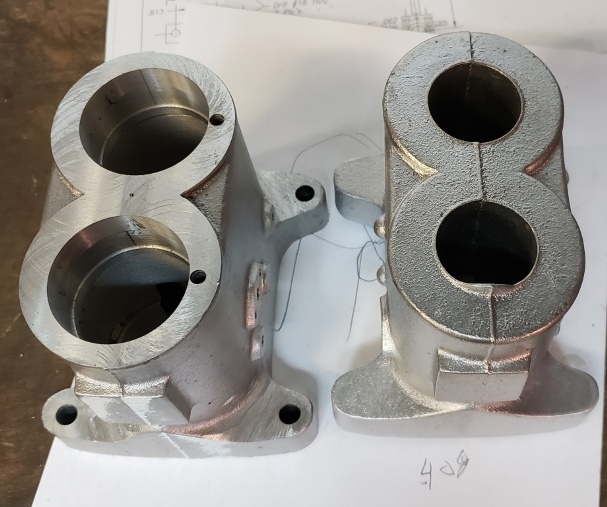

If you remember with the last update, I had uncovered an error in the drawings and was trying to determine what to do about it.  I finally decided that another casting was the only solution so I contacted Bob Banke.   We had an interesting conversation.
Bob informed me that he had sold around 60 casting sets for the Frisco Standard and I was the first person to mention that the drawings might have an error in regard to the cylinder dimension.  He wouldn’t really confirm that the drawings were in error, but stated that he wanted the people that bought his models to have a good experience and if I needed another casting, he would send me one; free of charge.
I thanked him profusely; then pressed him regarding the measurement that was in error.  His response was that he no longer had access to the drawings.  The template used for the drawings appear to be a “Solid Works” template (thanks Brian) so I assume he means he no longer has access to a copy of “Solid Works” to make a change. (The drawings were signed by a “W. Austin” and possibly Mr. Austin is no longer available?)
The take away from all this is that I got a new casting (free of charge) and the dimension on the drawing probably isn’t going to get changed; so those in the future, who purchase this model, might fall into the same trap I did if they aren’t attentive (as I was not).
Before you take what I’m saying the wrong way, I have a lot of respect for Bob.  He sincerely wants his customers to be happy: even to the extent of supplying the occasional replacement casting for free. I would purchase another of his models without a second thought (and probably will since he has another I really like and as Jo would say: (paraphrase) “How can you live without a cache of castings to build?”.
So, while all this was going on, I have one of the cast iron sleeves in my big lathe and If I remove it, I’ll never get the rough stock centered again, so there it will stay until I get the outside diameter for the sleeve (after I bore the replacement cylinders).

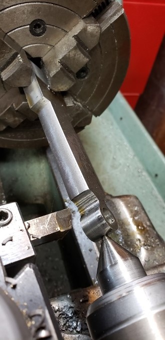

I thought I’d start on the connecting rods.  The bottom crankshaft journals are brass castings with steel rods attached.  The drawings call for the casting to be drilled for the bolts and then cut through the center.
I attempted the cut through the center with a .018 slitting saw but the casting seized the saw and shattered it (actually two of them). :hammerbash:  I ended up buggering the job :facepalm:, but fortunately there was enough material in the casting to clean up the rough center so all is well. :insane:
If anyone can tell me how I should have split this casting in two, I’d appreciate it.  With some things, I’m still quite the novice. :help:
Here are the castings, complete and ready to receive the steel shafts.

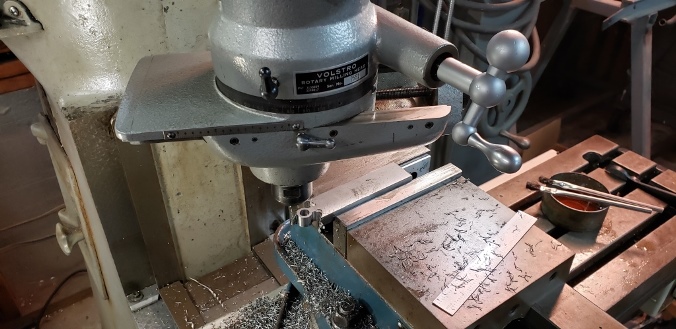

On with the steel part.  After cutting a piece of stock to size I’m forming the wrist pin journal with my rotary milling head. (I really love this thing. :Love:)
With my big lathe tied up, the connecting rods are small enough I can use my tired old 9 inch Southbend which I’m doing here.
And here is how I left things at the close of the day; working down the diameter of the shaft.

that casting is a challenge...gripping in the vise with the part sitting in some soft aluminum or lead flashing so it doesn't move around, and saw cutting it would be my first choice.
« Reply #117 on: February 15, 2019, 12:13:10 AM »
Dave.  Holding the casting wasn't a problem.  The casting was solid (before boring it for the crankshaft journal).  My problem was that the casting kept closing down on the slitting saw, seizing it, and jamming it in the cut slot.  I was using a very slow speed, around 150 RPM.  I guess heat was the culprit but I thought I was going slow enough and was using Plenty of cutting oil.
It was a block of brass around one half inch by one inch cross section.
Ahh   got to wonder if its under stress.   Perhaps a cycle to red heat under the torch before you start might get the stress out.
