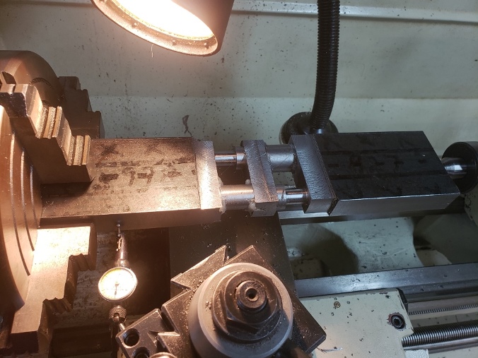

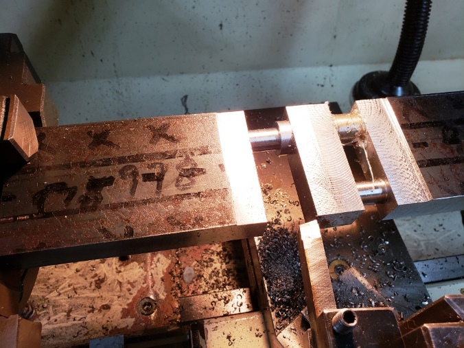

Art: your estimate was spot on.  I have around two inches of tooling reaching into the throw.  I couldn’t do much more.  I purchased some ½ inch tooling specifically for this task since my 3/8th inch tooling wasn’t long enough.

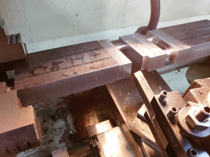

You know, you really need to refer to the drawings every once in a while. :stickpoke:  After I finished the first throw and had setup for the second, I remembered that I needed to add this profile in the piece between the throws.  Since I have the 2nd throw already set up, might as well address that one and then go back and do the first.
Here I’m just getting started.
And here I’ve just finished this detail for the second throw.
A detail I need to finish on this side of the throw is cutting a curve in the top of the minor and major throws.  Since we all like videos and I was getting kind-a bored here’s a video of the process.
<a href="https://www.youtube.com/watch?v=UT1UnW3OkBg" target="_blank">http://www.youtube.com/watch?v=UT1UnW3OkBg</a>

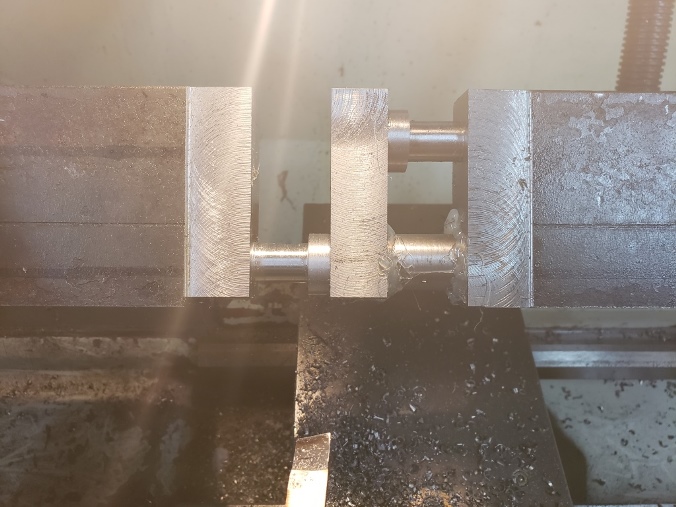

With the crankshaft turned around and back in the lathe where it was for the first setup, :facepalm2: I’m starting on the detail for the first throw as I did above.  Since this is cosmetic, I’m not too concerned about not having this detail exactly concentric to the connecting rod journal.
A video of the same.  Since someone is bound to comment :stickpoke: on the small divot in the connecting rod journal I guess I need to explain.  Just a moment of inattention while on the mill and my end mill took this divot out of the journal. :disappointed:  It’s very small and shouldn’t affect operation of the engine; in fact it might help it in that it probably will retain oil in the journal.  If you press me on it I’m going to claim that I did it on purpose. :naughty:
<a href="https://www.youtube.com/watch?v=OUWp6t4tBcU" target="_blank">http://www.youtube.com/watch?v=OUWp6t4tBcU</a>
All done working inside these throws.  Only outside work remaining to complete. :pinkelephant:

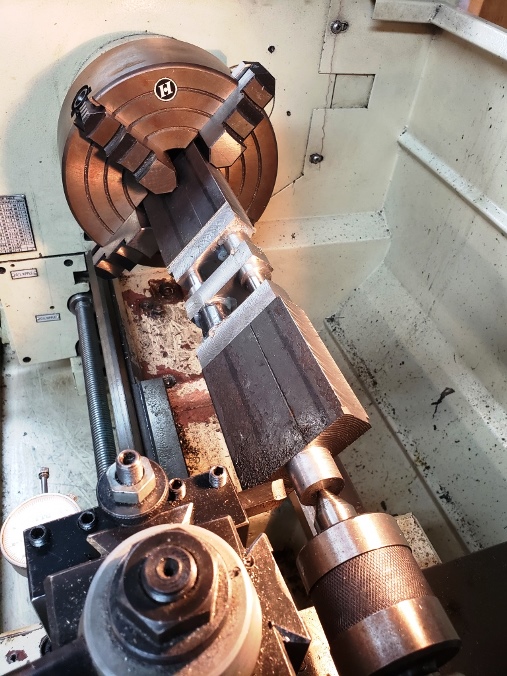

It was a PLEASURE to be working outside the crankshaft throws today.  First order of business was to mill off these two bosses I machined into the stock to assist milling the crankshaft throws.  Don’t need them anymore and in fact, they’re in the way now.

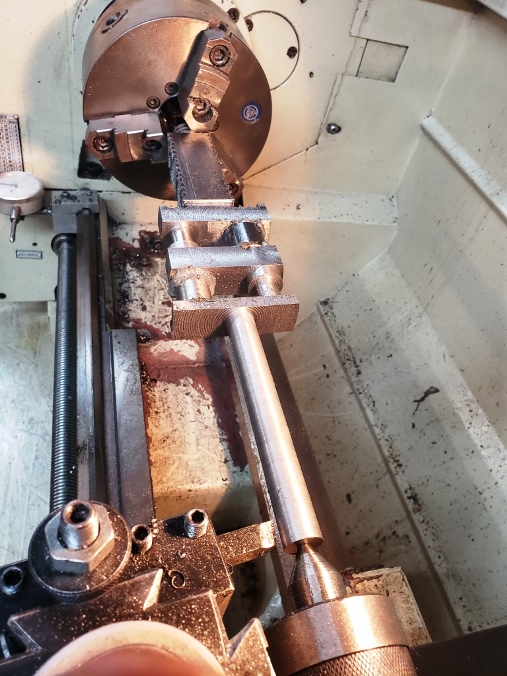

This is the last time I’ll be locating the work piece in the 4-jaw chuck and laboriously centering it.

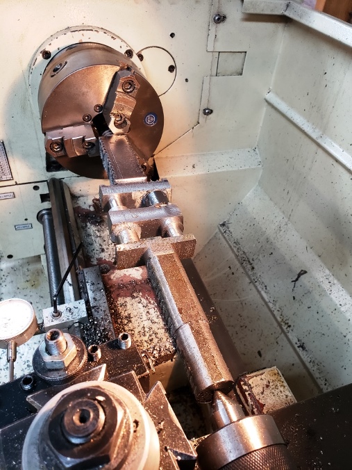

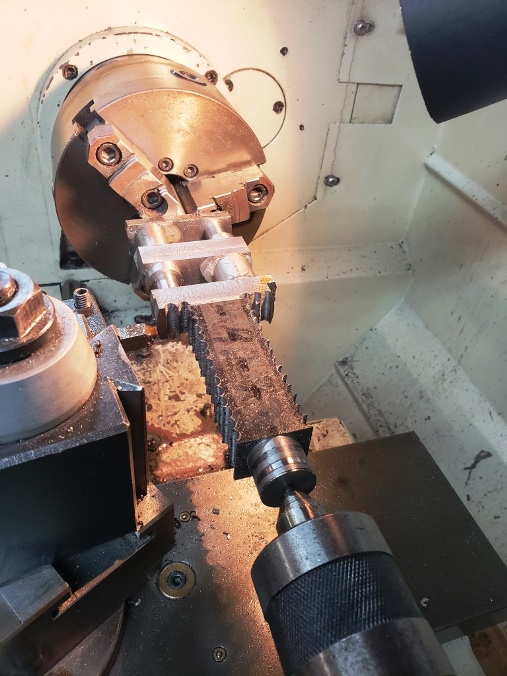

With the piece centered, I’m turning a round end to grip with the 3-jaw chuck.  I’ll be working the piece on it’s true center from now forward.
With an appropriate fixture turned to accept the 3-jaw chuck, I’ve removed lots of excess material.  I have to say, the piece, after nearly a week of work, looks like it’s ready for the scrap bin.  Let’s hope that changes in the next few days.

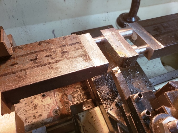

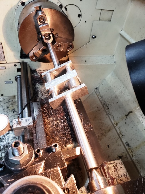

I can see the light at the end of the tunnel with this crankshaft now.  Mounted between centers (those center holes I drilled so long ago ;)), I’m starting to whittle on an outside throw side.
With the outside throw side roughed out, I’m working one side of the shaft down.
Here I have the first shaft nearly complete.  I leave the first shaft a little over size, turn the other, then come back and finish this first one.  Maybe overkill, but I don’t want a little material movement while I’m removing lots of material on the other shaft side to shift this side out of alignment.

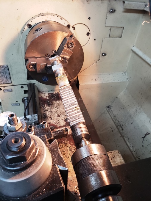

After turning the piece around in the lathe, I’m repeating the procedure on this final side.  Here, again, I’m roughing in the outside throw side.
With the outside throw side roughed in, I’m starting to work down this shaft side toward the final diameter.

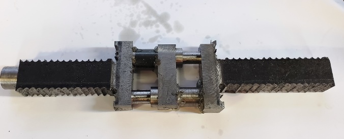

Thanks for those of you hanging in with me on this build, especially with this crankshaft fabrication; it was a long slog… but completed today (well, not really, I still need to cut the key ways)

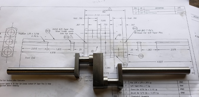

Today was spent turning the two shafts down to their finished diameters.  I took my time with light cuts and probably made more passes than I needed, but after all that work I really didn’t want to mess up here at the end.
And so, after cutting away a few pieces that were left over from the way in which I fabricated this crankshaft, and after filing and polishing away the tool marks, I give you a picture of the completed part.
Of course, the “proof in the pudding” is to install the thing and see if it fits, and turns freely with no binding.
