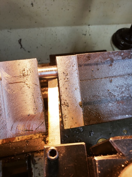

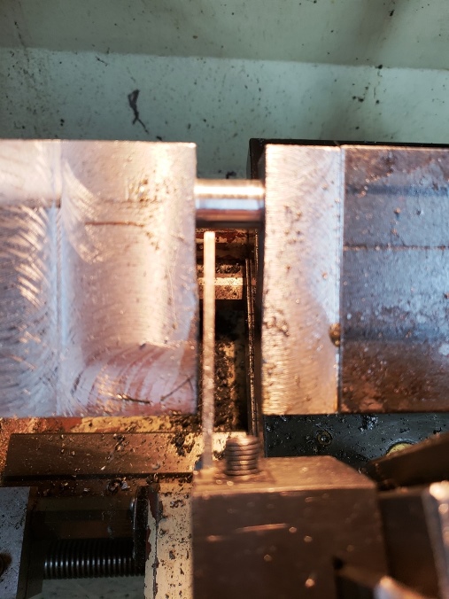

Dave, Chris, Art, Pete; thanks for your comments.  I’ll give you another option that I use for temporarily fastening the support between the throw webs for support… hot glue.  I’ve used it numerous times, easy to install and cleanup is a breeze.
UPS usually delivers to residences in my neighborhood at dark-30 but today the UPS delivery showed up mid-afternoon, so I got some work in after all.  That probably was as well because tomorrow is supposed to be C…..O…..L…..D and there probably won’t be any shop time.
After grinding this ½ inch shank down to 3/8th inch I got busy finishing the throw.  Didn’t take any pictures, so after I was all done, I caught-up with the photos, you’ll get the idea.
Cleaning up the left (center) throw
  Cleaning up the right throw
Working down to the final diameter
A little final sanding to remove a few tool marks
Next I’ll move on to the left-hand throw.

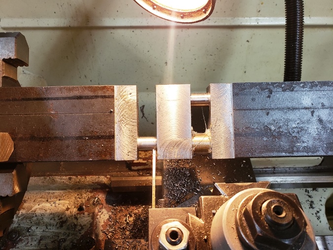

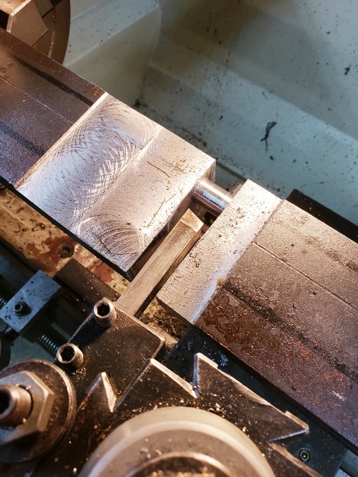

Dave, Chris; thanks for stopping by.  It is a large piece to be swinging in the lathe.  I’ll be glad when I have these throws complete and I can be working outside instead of inside the throws.  One little lapse of concentration and have the throw come around and strike the tooling and UGLY things will happen. :hammerbash:
I braved the cold North Carolina weather (yea- you guys in Canada are laughing yourself silly now :lolb:) and worked on the other throw.   It was pretty much the same procedure.
Here I’m milling out between the throw shoulders (stuck to the way I did the first one- if it ain’t broke, don’t fix it)
Finishing up on the mill
And the lathe work

Craig,
I have to ask, how far out is that lathe tool sticking out. It looks to be about 2 inches. The one lathe tool I have for that sort of thing I used on the cooling fins on Val, I needed .720 depth of cut to clear the corners of the cylinder, clears the tool by .03". A friend used the wire EDM to cut it .5 tall .25 wide blank. I should design on with radiused corners relieved in the center, for turning crank throws. Then when he has time on the machine he can make me a new one to use on a crankshaft.
