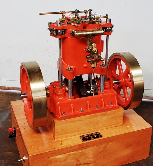

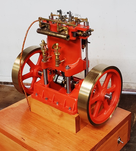

Progress continues with this model.  I have it together now where it should run.  I haven’t built the water tank, plumbed up the water, or built the water pump yet; but for short runs it ought to be ok without coolant.
I just ordered enough brass tubing to make the water tank and fuel tank, it should show up today.  Has anybody priced brass tubing lately… yikes :o- it was sticker shock.  I’m REALLY gonna be bummed if I can’t get this thing to run (yea, I shouldn’t tempt the gods by even mentioning it) :embarassed:.
I haven’t really tried to start it yet; I have verified that the valves are timed properly and I’ve discerned that the igniters are operating correctly so it ought to go.  The reason I haven’t tried to start it yet is that it has little no compression.  There are lots of opportunities for compression to leak out and when I turn the engine over I can hear the compression leaking away with a hiss around the head area.  I'll need to locate where this is and correct it before I can expect the model to run.  It might take a while so… meanwhile. I’ll tantalize y’all with a few current pictures. :mischief:

« Reply #184 on: May 13, 2019, 08:16:46 PM »
Craig--That is indeed a thing of beauty. If you are trying to determine exactly where your compression is leaking, take the guts out of a sparkplug and braze a bit of tubing onto the exposed end to hook an airline to. At 15 to 20 psi, you will be able to isolate the leaking feature.
« Reply #185 on: May 13, 2019, 10:21:12 PM »
It's igniter ignition so no spark plug socket, but if push comes to shove I've thought of drilling in a threaded hole for a fake primer cup and then using that.

Igniters are the predecessors to spark plug ignition.  With an igniter, you have two electrodes in the cylinder; a fixed-insulated electrode (insulated from the block) and a moveable electrode.  A mechanical mechanism is developed to move the electrodes together, and then draw them apart.  Electrically, a circuit is built with a battery, a “low tension” coil, and the “points” of the igniter all in series.  When the igniter “points” close, a circuit is completed and the coil builds an internal magnetic field.  When the igniter “points” are opened, the circuit is broken, the magnetic field in the coil collapses.  This results in a large voltage spike driven through the circuit and the voltage is high enough to arc across the “points” in the igniter as they open, thus firing the fuel/air mixture in the engine cylinder.  I’ve bought my coils from Bob Herder because his are the cheapest that I’ve found.  These appear to be made for some type of neon light fixture and with the numbers on the coil I probably could just get them from an electric supply house.
Thanks for those of you following along.  The journey is turning out to be long and arduous.  I thought it was time for an update; if for no other reason than to let y’all know I haven’t given up on this model… yet.  I’m making slow progress.  One step forward and two back sometimes; but progress none the less.
My compression issue has gone from NO compression to enough compression that I need to give the flywheel a spin by hand or my drill can’t take either cylinder over the compression stroke.  Resolving the specific lack-of-compression issue I accredit my good friend Gordon Miner.  He and his Dad have built dozens of these hit and miss models and his experience is a great asset to turn to when I run out of ideas.
My compression issue turned out to be a leak between the insulator and the electrode on the igniters.  I’ve built three models with igniters and never had this problem, but these igniters were leaking.  I remade the insulator and the electrode both and the issue still wasn’t resolved.  Finally I smeared a bit of high temperature Permatex gasket sealer on the electrode shaft before installing it in the insulator; this fixed the problem.
At this point the engine will intermittently fire; almost enough to sustain running.  I’ve noticed that all the valves open late and close early so probably fabricating the cams with a new profile would help.  I seem to be getting a little blow-back into the intake manifold from when the exhaust of the first cylinder closes early and the intake of the second cylinder opens late.  This might/does  :noidea: interrupt the fuel/air mixture to the second cylinder that fires at 180 degrees after the first cylinder and maybe prevents it getting a proper fuel /air mixture.  I’ve tried to set the valves so that this is minimized.
I’m really looking toward a carburetion/intake problem at this point as to why the engine won’t fire consistently.  Obviously there are still a few problems to work out before it’s a runner.
I'm going to need to address the water pump soon as the heads can get pretty warm, even without the engine running consistently.
A photo of the model to date with it's new, snazzy water tank with fuel tank atop.
