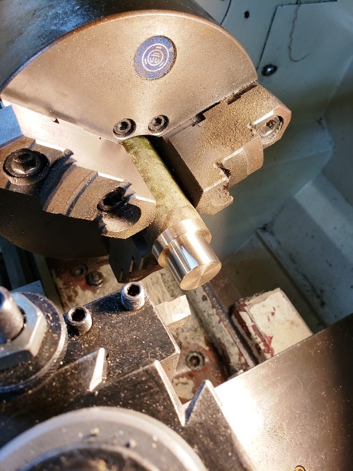

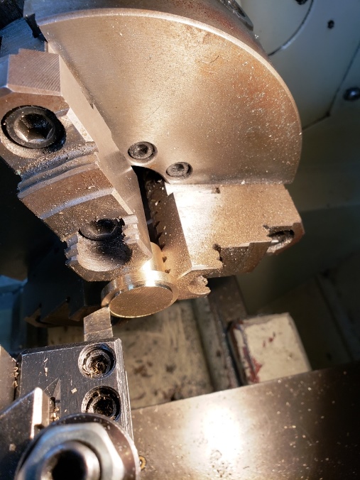

Dave, Dave, Tim, and Art; thanks for your comments and encouragement.  Again, thanks for those of you silently stopping by.
Got a little done today.  I thought I’d get the main bearings out of the way.  In this photo I’m sizing one of the bearings.
After cutting it off the stock, I’ve turned it around in the lathe and am facing the outside face.
I then drilled a starting hole in all four bearings.  This isn’t the final size; I thought I’d leave that till I have the crankshaft finished.
Even though the drawings don’t call for it; I thought I’d stake the bearings to the block.  Were one of these bearings to “catch” and start spinning in the aluminum casting, I don’t believe the casting would last long. :o

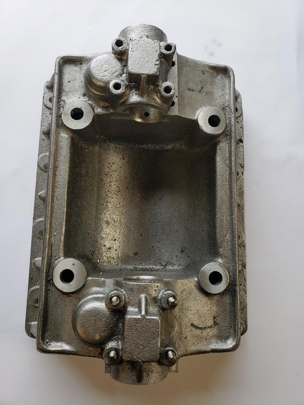

Craig, Just tuned in. I noticed you have a very nice collection of engines. You are a very accomplished builder. My Hat's off to you.
I have one of these kits under my bench, and have had a false start on it. It's a very early one of the production, and the drawings had a LOT of problems, so I set it aside. Since then, I understand the drawings have been redone with the problems fixed, and I have received some of the updates. I'm in a bit of a backlog now, so the kit will have to wait it's turn, but I'm still very interested in your build. This is a very hansom engine. I saw an original at Portland Indiana several years ago.
I'm not being critical of your work, but I have a few questions. I have noticed from your pictures that some of the mounting holes and bearing cap holes have missed the center of the bosses. It's just I'd like to understand what happened. Is it the drawings, is it a build up of tolerances, or are the castings actually off? If it's just a mistake, I understand, I've made more than my share if these.

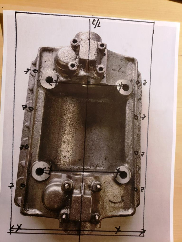

« Reply #22 on: January 04, 2019, 07:29:02 PM »
Maury.  Good catch.  I was going to discuss this later, when I addressed the gears but now that you’ve observed the problem, I’ll address it now.  Hopefully this discussion will help someone who follows and who builds this engine.
As I stated earlier, Bob Banke specifically states in his building notes that there are close tolerances that must be observed.  I didn’t fully understand this till I ran afoul of a problem.
As we all know; castings are irregular blobs upon which we impose a specific order.  No two castings are the same so someone else, building this engine, may or may not see difficulties similar to those I encountered.
As I interpreted the drawings, I established the centerline for the crankshaft by halving the distance between the two sides of the casting (x in the following diagram).  I then located the locations for the pedestals (Y).  Lastly, the locations for the base mounting holes (Z) were located.  All this seemed good.
I proceeded to drill the holes as per the drawing specifications.

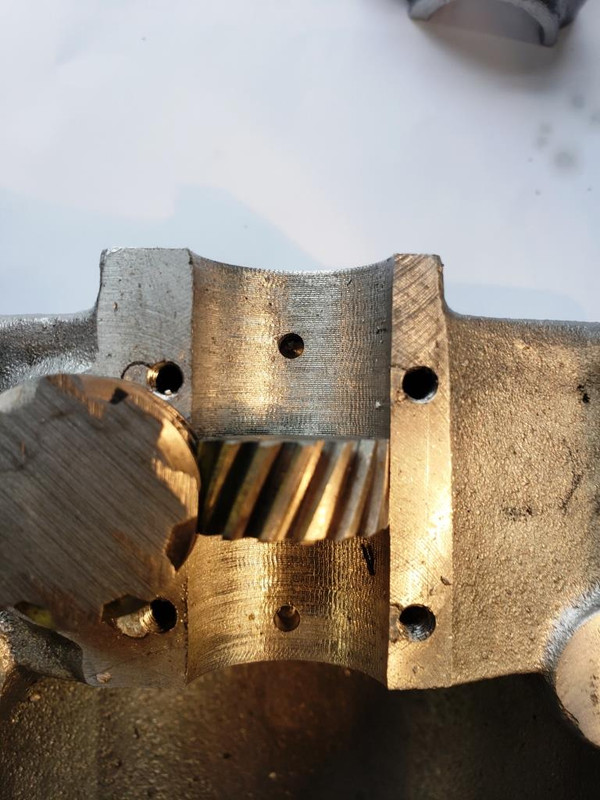

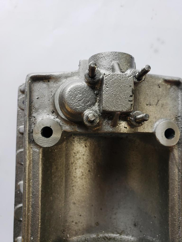

When I went to position the journal caps on the base, the bottom casting lined up well with the base; the casting on the top did not line up well at all.  Rather than hold to the dimensions on the drawings, I chose to position the upper bearing cap as shown below.
Normally, this might have been ok, but with the tight tolerances required by this model, the location of the two left most threaded stanchions interfered with the position of the helical gears that drive the vertical side shaft.  You can see in this photo below.
The best remedy for this I could discern was to fill the original tapped holes in the base casting with aluminum threaded rods and re-drill the holes, holding to the dimensions given in the drawing.  The result of this is that, though the gears now have the necessary clearance, journal cap is no longer centered on the engine base casting.
As a result of my error, I needed to bore the base and bearing caps for the crankshaft bearings around .040 in. over size to get the bore “true”.  I’ve compensated for this by making the bearing OD oversize also and I believe this isn’t going to cause any residual problems.   Hopefully, I can move forward without any additional error.
Hindsight being 20-20, I’m thinking that my initial measurement layout was flawed.  Were I to do this again, I might proceed as follows:
I would locate the crankshaft centerline by placing the journal caps on the base and drawing a line down through the center of the two as shown by C/L.
I would the spot drill the eight frame mounts by center of boss, regardless of the dimensions on the drawing.  I would use these frame mounts to mount the base to a builders plate and then mill the side plate edges parallel to the C/L at a known distance, and then mill the top and bottom of the builders plate perpendicular to the C/L.
Using the C/L I would locate and drill the four pedestal mount holes (Y) and then the eight Journal cap mounts.  The location for the crankshaft main bearings could then be located and bored as I did above.
This would result (at least for my casting) in the casting for the engine base being a degree (probably no more) askew from the centerline of the crankshaft.  I doubt this would result in a problem.
« Last Edit: October 17, 2022, 05:49:09 PM by Craig DeShong »

Craig, thanks for the analysis. I'd be interested in seeing the corrected build. Might even be worth trying to get another bearing cap casting. I know when I was selling kits, a number of builders wanted an extra part now and then. Was always happy to help them get a successful build.
It may be that a little pattern work is needed to properly address the problem. Are you sure you have the crank bore centered on the features of the base casting?
maury
« Reply #24 on: January 04, 2019, 10:36:21 PM »
Well, that's the problem Maury, at least with these castings.  I have the crank bore centered on the base casting features and with that, the one bearing cap won't align.  As I describe above, with the crankshaft aligned with the bearing covers, then the other measurements, as given in the drawings, won't come in align without a little fudging.
« Reply #25 on: January 04, 2019, 10:45:58 PM »
That is a shame Craig. Hope your work around will turn out ok. It's a very nice engine. One would hope that castings would be prover better before release, but not always the case I guess.
