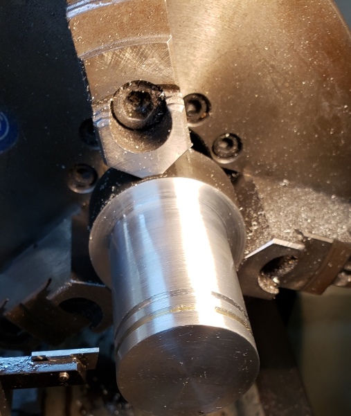

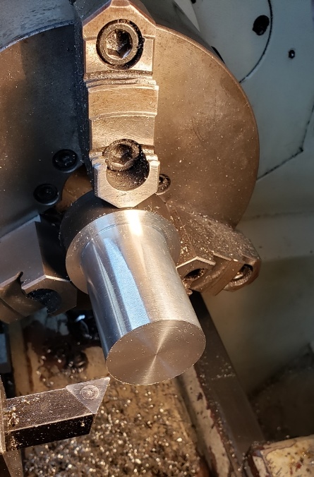

I decided to make the pistons out of aluminum.  I have the stock and this way I don’t need to silver solder them together (have I mentioned that I ABHOR silver soldering.. basically because I can’t do it well?).
Any hoo, here I am, gleefully turning a blank of aluminum to the OD of the piston.
Cutting the ring groves.  I have a friend who was walking with me around the Cabin Fever Expo a few years ago.  He’s a great modeler, so when he talks I tend to listen.  As we were walking by the Arthur Warner booth he pointed out a set of slitting tools and said “You need those”.  At the time I couldn’t really see a use for them but I’ve learned to listen.  He was right they REALLY do come in handy from time to time, like for cutting these piston ring groves.
Now with the piece parted from the stock and turned around in the lathe, I’m facing the piston to the correct length.

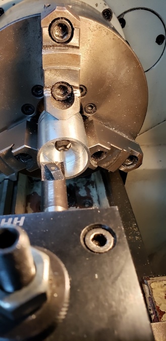

In this photo I’m forming the skirt.

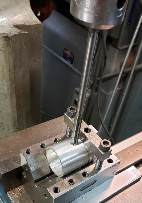

Time to move to the mill and drill and ream the hole for the wrist pin

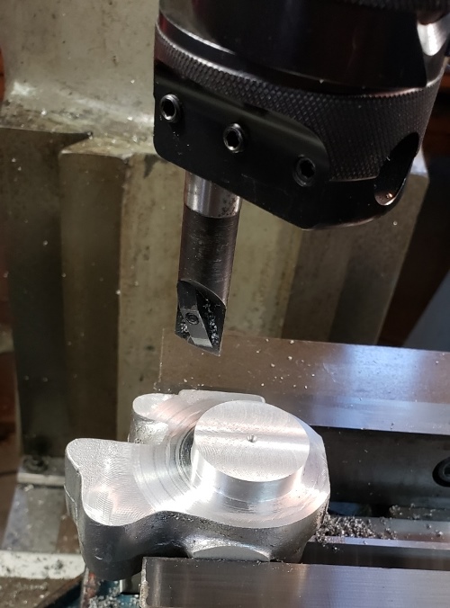

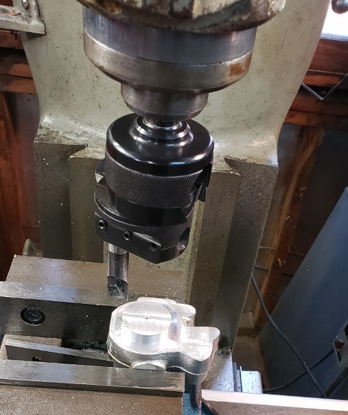

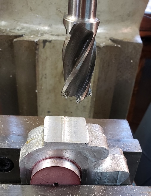

I started working on the heads today.  These are irregular shaped castings with no really good way to hold them.  I decided to file some flats to give me some purchase on the casting and then milled a flat surface on the bottom (that mates the top of the cylinders).  Once this was attained I outside bored the cylinder protrusion.  I would have preferred to do this on the lathe, however I couldn’t really figure out how to hold the casting and align it properly.  On the mill I could run my indicator back and forth and get a reasonable alignment of this irregular surface.
The two heads are mirror images of each other; here’s the same operation on the other head.

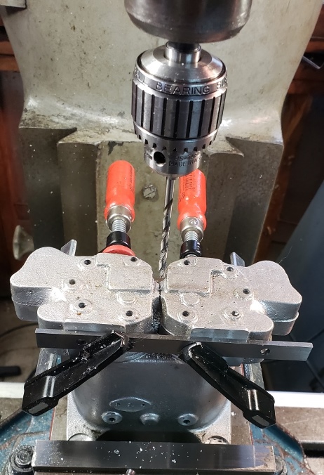

With the two datum references established I could locate the cylinder center from the top of the casting.   This allows me to locate and drill the head mount bolt holes.  The drawings indicate these should be drilled at the center of boss.  I wanted to verify that these holes wouldn’t pierce the cylinder liner.  I decided I wanted each hole center should be at least .950 inches from the cylinder centerline.  This allowed the cylinder bolt to be located well within the aluminum casting so it would not interfere with the cylinder liner.  I did have to offset a few bolt holes away from center of casting to achieve this.

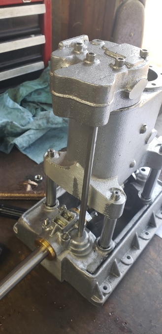

With the heads drilled for the head bolts, I affixed them to the cylinder casting and spotted the bolt hole locations.
With the bolt hole locations spotted I could drill and thread the cylinder for the head bolts.

Craig, I have never outside bored like that, does it require a cutter with edge on other side, or running the mill backwards?
  • Posts: 15294
« Reply #146 on: February 26, 2019, 08:17:56 AM »
 :thinking:
Positioning those heads bolt holes looked to be a tricky job to balance things out I bet you are pleased it worked ok  :).
« Reply #147 on: February 26, 2019, 11:00:13 PM »
Chris- just ran the mill backwards (and set the down feed to up-feed since the mill was running backwards).

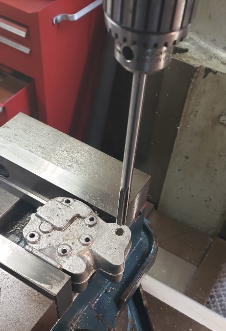

Today I started out locating the hole in each head for the vertical cam shaft.  The building notes instruct the builder to make a pointed shaft (slightly longer than the allowed space) and fit it to the base, then attach the head and “spot” the location for the hole.  I’m doing this in the photo below.
Once the location of the hole was spotted I took measurements on the mill from the two X and Y datum, turned the head over and then re-located the location for the bearing hole.  I then center drilled, drilled and finally reamed the hole.  The drawings call for this steel camshaft to run in the aluminum casting.  I’m again choosing to use a brass bushing so I over bored the hole in preparation for installing the bushing.
An assembly check shows both upper camshaft bearing holes to be located correctly.  WHEW!

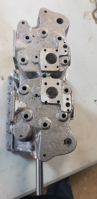

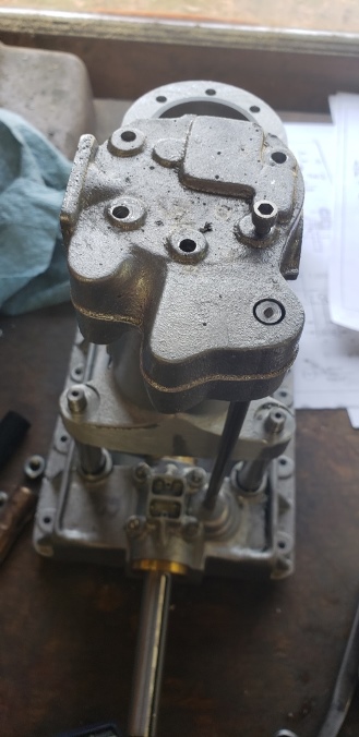

Work progressed on the heads today.  It was a busy day and I missed taking “in progress” pictures.  I guess I was too busy concentrating on all the steps.
The clearances between some of the holes is tight and I was concerned I might get some interference, especially since I didn’t hold exactly to the drawings in my work yesterday.  Turns out I have only one minor interference in one of the heads; It’s with one of the valve guides and I believe once I install the guides I can touch-up the hole and everything will be ok.  The interference isn’t enough to reach the valve stem.
I’ve included a few photos of the completed heads, sans the holes through to the valve guides which I’ll need to drill after I fabricate and install the guides.
