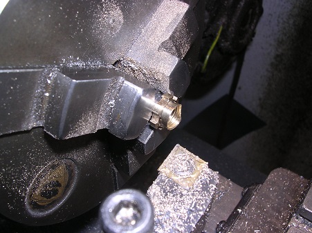

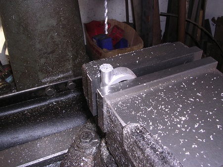

Welcome along Lars! This seems to be a fairly uncommon engine and it is nice to see another one. Yours does look good and I wish I had been able to ask you about the crankshaft before I did mine! Please could you post a few more pictures of it? Are you running on glow plugs or spark ignition? I am coming to that stage fairly soon but the drawings are a bit thin on detail. They do show a contact breaker and distributor but no clues as to how to produce the HT. I could really do with some guidance in that area. The contact breaker is a hall switch but I know it doesn't have the capacity to drive a coil directly so I should very much appreciate your thoughts. In fact, I shall make that a general question for all of my friends here. Someone will know!

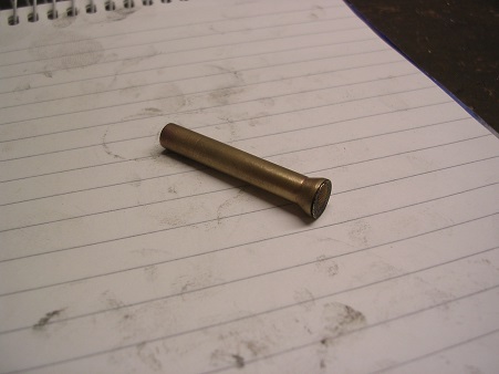

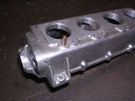

On to an update. Slow progress again but some. I turned up the breather tube and sweated a piece of gauze across the top by first tinning the end of the tube and then just warming it whilst pressed onto the gauze.
I didn't completely block the gauze with solder and just trimmed the edges. so I was pleased with that result. I need to drill a hole for it in the top half of the crank case but the position is undefined on the drawing so will have to give it some thought.

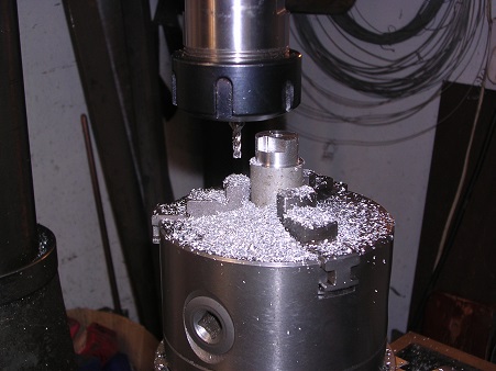

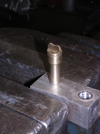

Then the oil filler tube and cap. Another nice little milling exercise followed by a needle file to give it some shape.

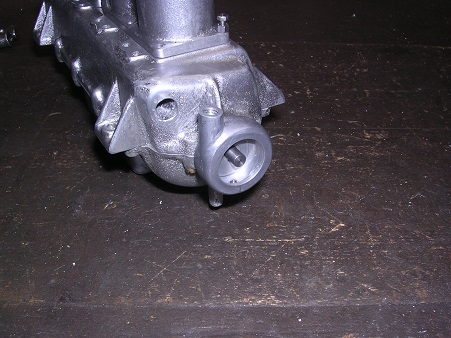

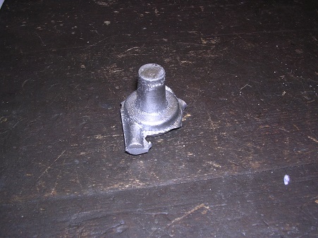

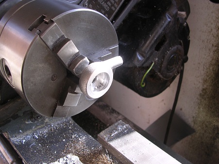

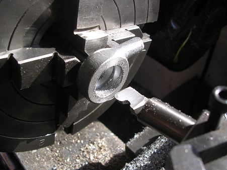

Water pump next. This is a casting with a thoughtfully provided chucking piece.
After facing and boring, I mounted it in the four-jaw a bit eccentric and bored the water way such that it got wider towards the pump exit. Not quite a volute but giving the same effect.
In the model, the pump is mounted on the end of the crankshaft. The drawing shows two M2 tapped holes in the back but I cannot see what they might be for. They are aligned with the joint line between bush and housing and there is no way of getting a bolt through from the back. Lars, how have you mounted your pump?

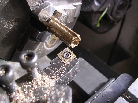

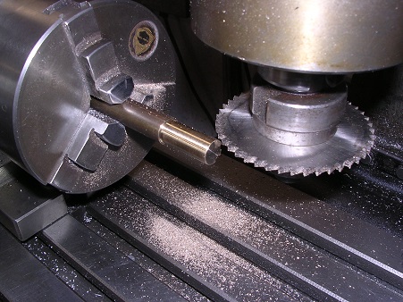

Then the impellor, mounted in the dividing head to have the vanes milled.

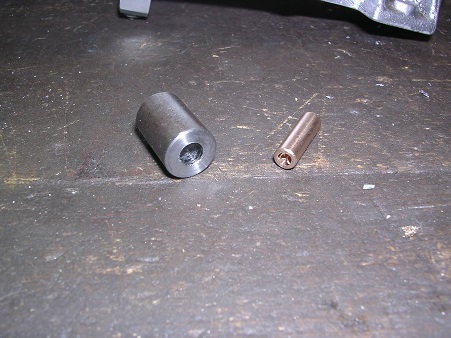

Cam follower bushes next with a press jig to push them into the casing all the same amount.
And the followers, a relaxing turning job.

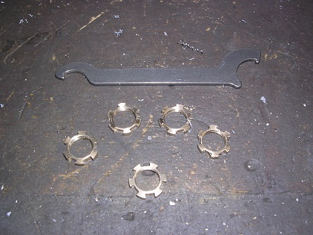

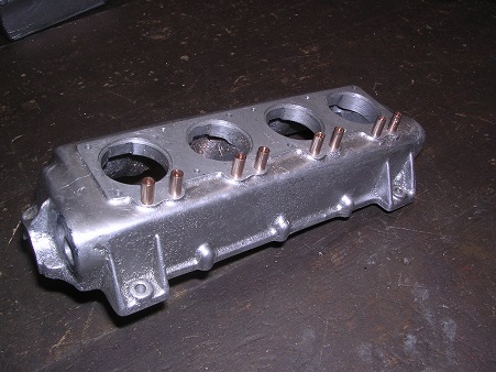

The exhaust pipes are mounted by screwing into the block and securing with a brass collar slotted for a C-spanner.
A perfect fit for my micrometer spanner!
