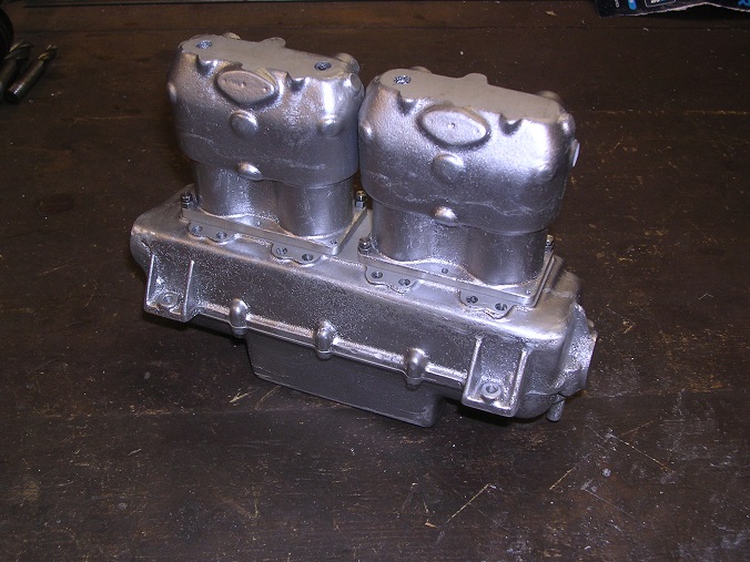

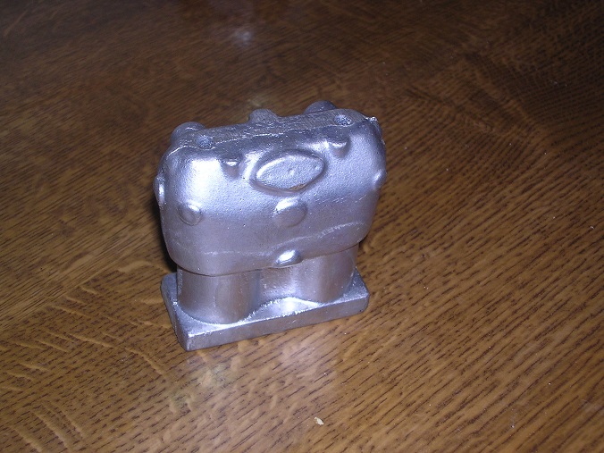

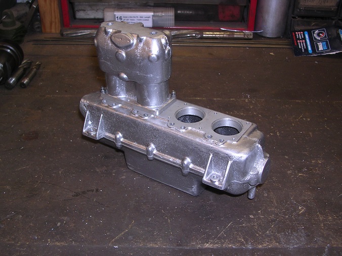

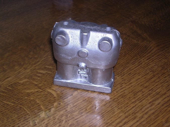

Now that I have a crank case, I thought I would have a go at the cylinder blocks. Again, these are most awkward castings to hold!
There are very few good datum faces on the things so I held them by the base flange in the vice and took a skim across the top.
Then turned them upside down and dogged them to the table. This worked out OK but there is very little meat on the base flange so  so I had little room to manoeuvre.
I skimmed them to height across the base and then ran around the periphery to clean to size. Using the wonderful edge finder, I datumned off the corner and drilled the stud holes. Then it was simply a case of boring to depth, or so I thought....
One core was slightly off-set so the casting only just had enough metal to clean. What I didn't realise until later was that I hadn't quite got the casting upright when I skimmed the top and, of course, this compounded the core problem. To clean up properly, I have bored it oversize by 1.5mm and will have to make a thick liner. Not insurmountable but annoying carelessness on my part.
Still, at least the stud holes lined up!
Then the next googly. The dummy core-plug bosses fouled so that I couldn't put the blocks close enough to bolt them both down.
These were removed and I polished the ends with a needle file so that you wouldn't know they were missing.
Well, it is beginning to look like an engine, anyway!

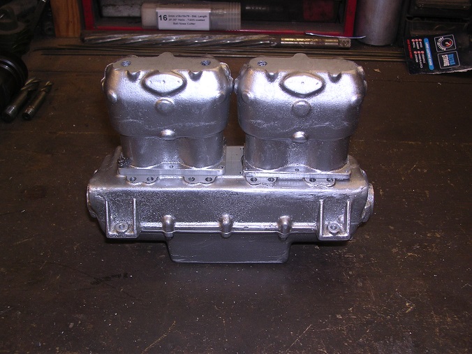

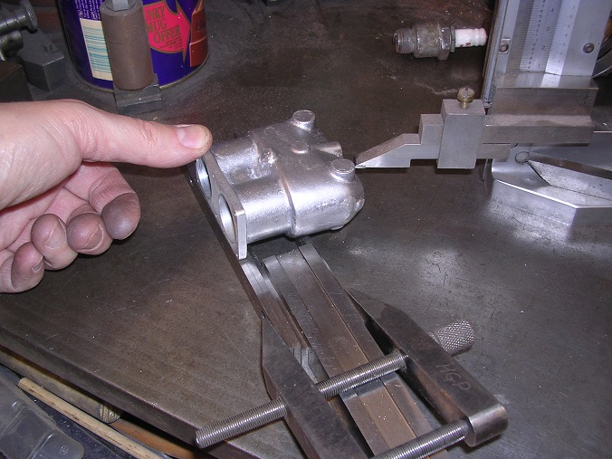

The centres of the blocks need to be in line so that the rocker shaft lines up across the tops. First job was to find a centre line. This was another puzzle due to the difficult shape. However, With the base flange on one parallel and a second underneath a clean part of the water jacket, I scribed an approximate centre line before turning the block over and repeating from the other side giving me two lines quite close together.
At least I can see the problem. One block lies 1.3mm out of line with the other.
Whilst I ponder what to do about it, I have removed the pattern marks.
Five minutes with the Dremel and that is something else ticked off.
I have been out playing trains today and have guests tomorrow but hope to pick the job up again in the week.
Steve   :)

« Reply #39 on: December 02, 2018, 09:36:19 AM »
 :thinking: Could you gently file the bottom clamping surface to adjust the angle to pull the top of the cylinder over in line?
I was allowed to fondle my cylinder castings this morning and there seems to be about 5mm top to bottom spare and 2mm on the clamping flange along its length. The width has nothing spare  :ShakeHead:
I know you have been aging your castings for a while Steve, I seem to recall the earlier cylinders did not have the water jacket cast in does yours? I don't think the slightly thicker liners will effect the water jacket  :)

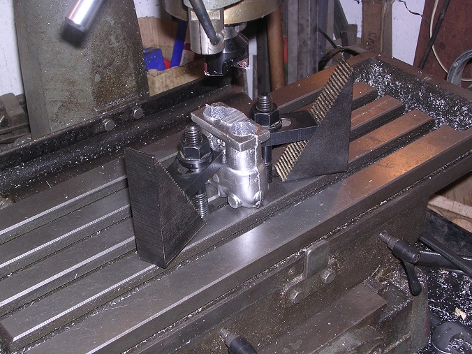

I had been thinking about just filing a slight run across the base but I would rather machine it if I can work out how to hold it.
These castings have the water space cast in and the liners are pressed in to seal. (Wet liners). The thicker liner will be fine and even if it is left a whisker leaning once I have skimmed the base, then that will be of no consequence. I hope to have an evening in the shed this week so we can see how it goes.
Steve  :)
  • Posts: 9466
Re: 1909 Mercedes Aero Engine
« Reply #42 on: December 02, 2018, 08:15:08 PM »

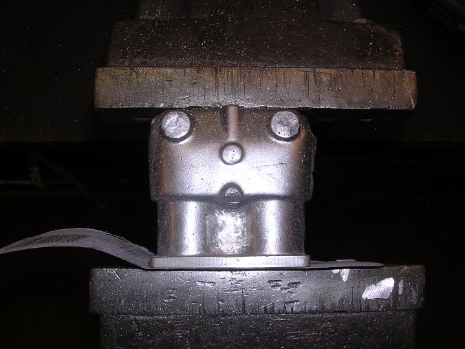

machine a bit of 1/4 flat with the desired angle which can be done easily by packing in the vice or pack the base of the vice.
Now clamp it down onto your tapered packer as you had it for machining the underside and bores.
Alternative would clamp it down to the mill table with a feeler gauge under one side to give it some tilt. Or pack a solid steel plate with feeler gauge/shim stock to get teh angle an dclamp the head down onto that, less likely to mark the top as it will be supported over whole area.
Agree machining will give a far flatter surface then filing.

« Reply #43 on: December 07, 2018, 05:46:41 PM »
Well, I have managed to find a couple of workshop hours this week and took the opportunity to bring the blocks into line. As Jason suggested, I took a piece out of the drawer and machined a run across it using some shim stock under the edge.
Then set it up and checked with the DTI to make sure it was right. (It wasn't!)
After that, it was quite simple.
Success!

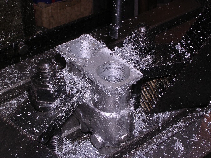

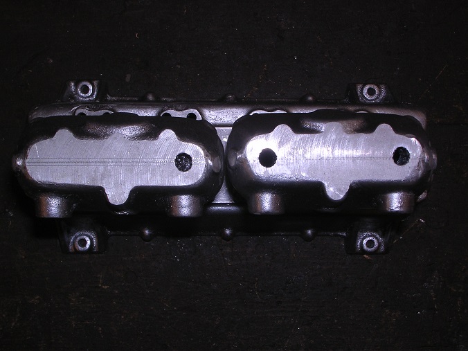

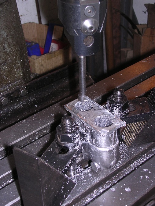

Next job is to start putting some holes in the top so I have clamped a datum to the table to allow for quick setting up and movement should it be necessary.
The valve holes are partially cored in so I used a nice new slot drill as a pilot. One of the nicest things I am finding with this job is that I have put away a number of brand new cutters over the years and saved them for 'best'. Well, this is 'best'!
I have also treated myself to some new reamers as I don't have any metric tools. This one turned up on Wednesday, just in time. I am doing something wrong with it though as it 'picked up' in two of the holes despite my best endeavours to keep the flutes clear.
I also managed to mis-read my dials and get one hole 0.010" out of position which is annoying for the sheer carelessness. I should know better by now. Oh well. I shall have to take Jo's advice and treat myself to a DRO.
