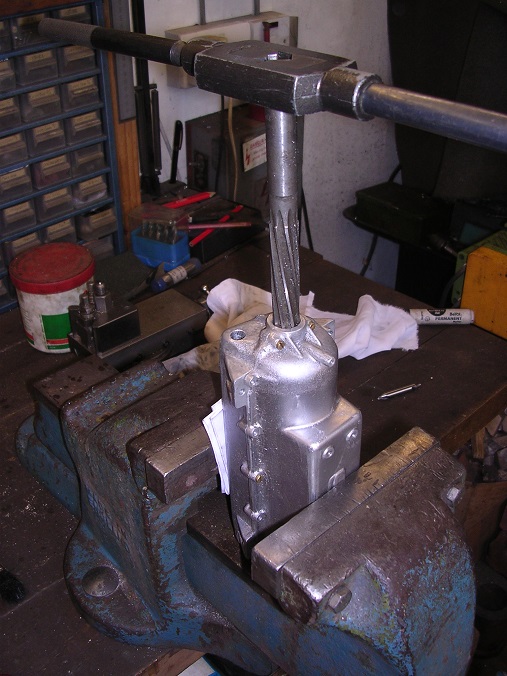

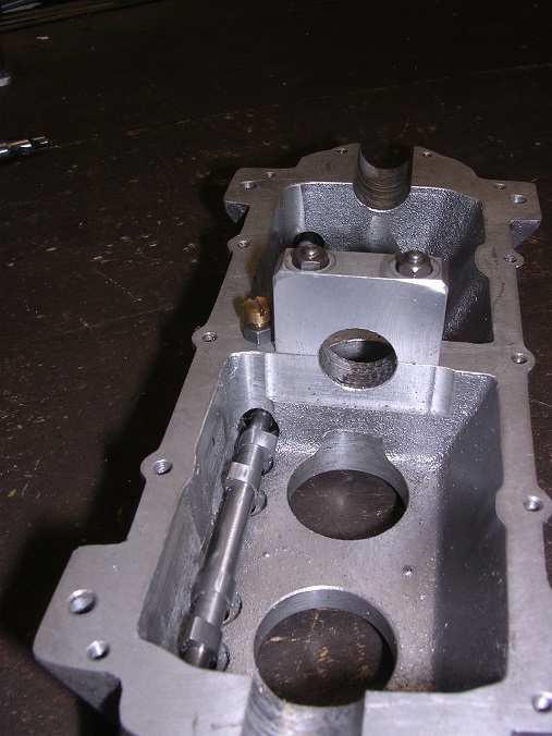

Many thanks for your thoughts Chaps. All very much appreciated. I have played games with the speed, tool angles, depth of cut and feed rates but to no avail. I kept going in the hope that I would strike the 'sweet spot' but alas and I am now 1.2mm oversize. I did a couple of spring cuts but each time, it just picked up the resonance. All extremely frustrating! Perhaps I should have made the shaft longer to change its frequency.
Mind you, this is the most amazingly rough bored finish I have ever seen!
The only plus side is that at least the hole is in the right place.
The hole is just shy of 9/16" so perhaps I will try an expanding reamer just to tidy it up a bit.

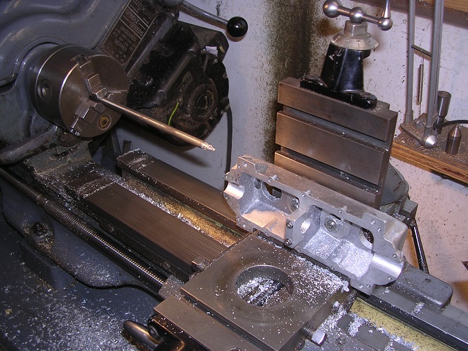

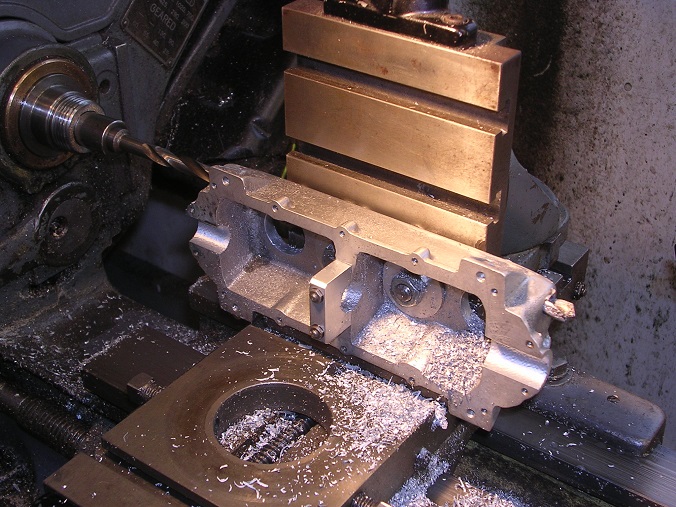

To get it low enough for the camshaft hole, I had to make sure that the casting hung over the edges of the cross slide. Drilling that hole will be the next challenge.
There is not much satisfaction in this one.
Steve    :-\

I find that if I get some chatter I cut spindle speed in half. If it chatters again cut in half. Just today I had to use a boring bar to bore a 2 inch bore 6-1/2 deep blind hole. I was down to 150RPM but got a good finish. Took forever!

could you use a shorter bar .set tool cross hole closer to  the hole so it just goes through the one hole have the a different tool for each hole that way the tool is supported near the chuck for that first hole the last hole is closer to the last hole the centre bore it would be a shorter bar over all ,if you could mont a bush next to the centre hole
make a bracket mount of that tee slot.that would help could the centre  be done before the sump is put back.
just some thoughts from a automotive machinist that has done a bit of line boring on line boring machines
they had arms which could be moved and placed next to the hole.but a bit hard for the centre  when the sump is on.
at least use three separate tools one for each hole so the bar can be much shorter.
looking again could you while the sump is of mount a support bush on a bar across the tapped holes on the lower face

I know it's a bit late now :( but Jason B used a much shorter boring bar mounted between centers so he could turn it around to cut either end without disturbing the cutting tool setting (you wil need to reverse the lathe I think  :headscratch: )

using the long bar the fixed steady could have been used as close as possible to the cutting tool shift to the other end when cutting that but the centre would need more support the shorter bar would be better.
i would set it up again and try again with a shorter bar.

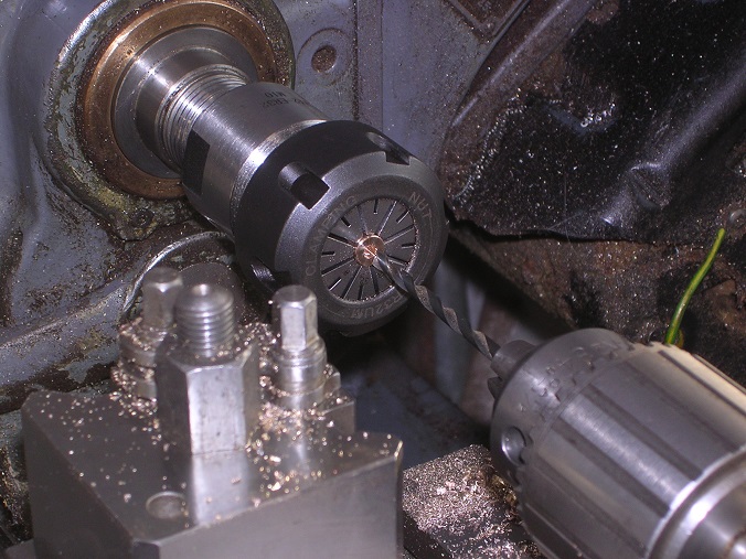

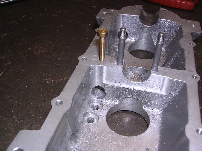

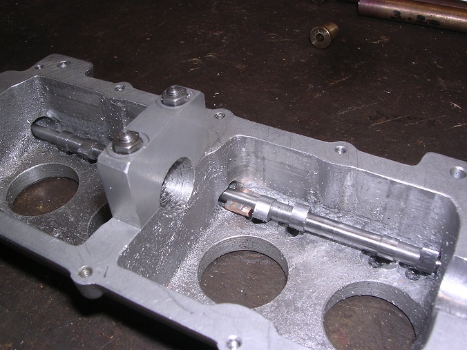

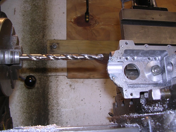

Back to engine building. I indexed the case down and across and centred for the camshaft hole. A nice new drill soon sorted that.
Then I used my extended centre drill and very gingerly marked the centre bearing hole. My new drill sorted that one out.
I pulled the centre drill right out of the chuck to get the last hole through but found that it hit the inside of the crank case, pushing it over.
I tickled that out with the Dremel before centring that one as well.
The extra long drill I was given finally went through there.
Now, the moment of truth. My 8mm reamer fell through the first hole (0.007" oversize) but cleaned the other two nicely. I found in stock, a 9/16" reamer so I put that through the crank holes and it cleaned them up a bit. As they will be bushed they will be fine although the quality is a bit of a dent to my pride, to say the least. Oh well.

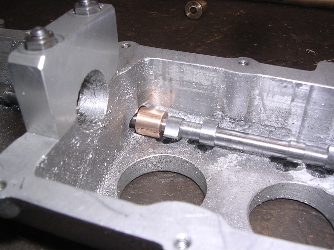

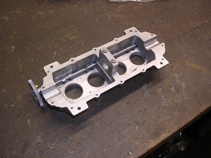

I made a couple of temporary camshaft bushes to try the installation.
The shaft wangled in OK but the cams actualy foul the inside of the crank case. More work with the Dremel sorted that.

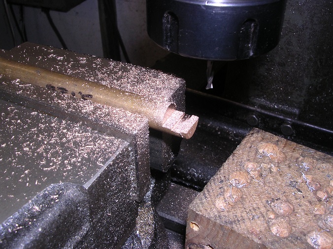

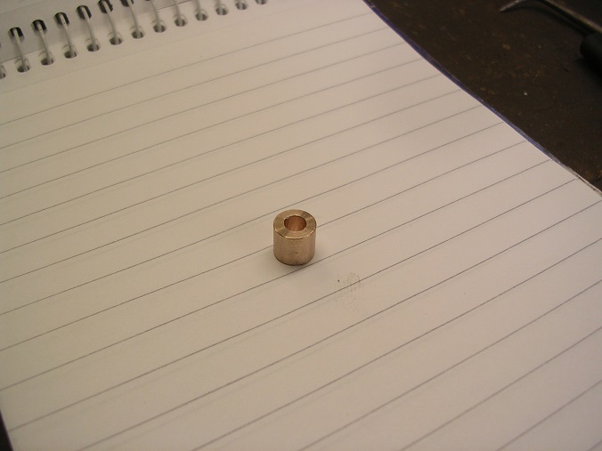

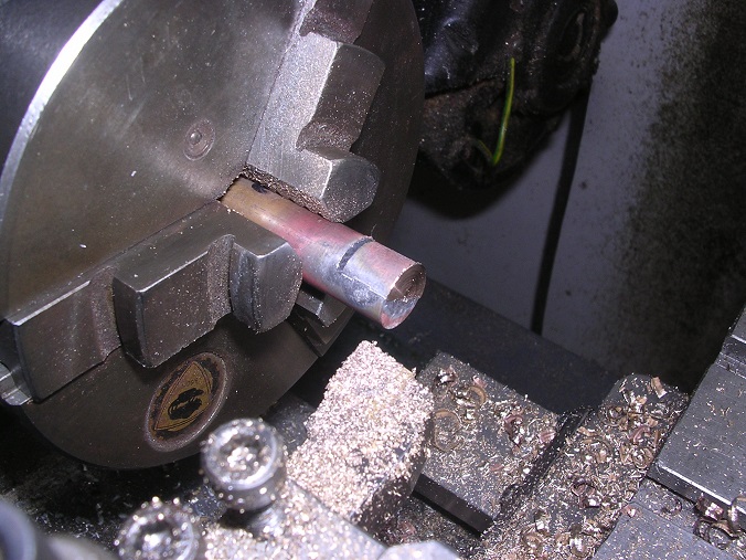

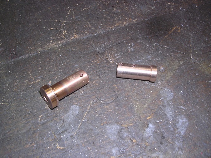

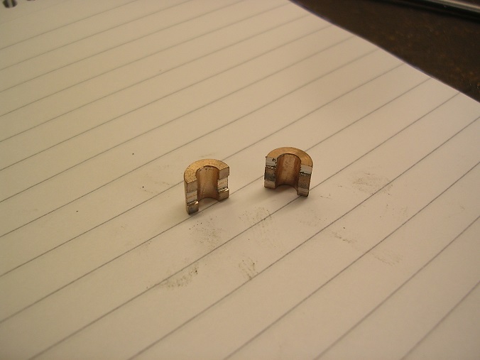

Next challenge was the centre bearing as I needed this to see how true the holes are. As I have made the camshaft in one piece (the drawings show a Loctited assembly) the bearing must be split. However, it has no flange to retain it so I was concerned that one half might walk out in use. I have therefore keyed the two halves together. I cut a bit of bronze to the centre line and then a 0.015" deep key slot across the middle
I did the same for the other half but raised it in the middle instead.
These were soft-soldered together and then turned to size.

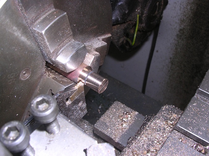

I drilled the hole, holding the bush in the collet chuck so that I would't burst the joint.
Warm it up to melt the solder and bingo!
Now a trial fit.
I was pleased with the result but as it could only be a push fit, I was concerned that it would walk out of position again. I have therefore dimpled the bush and added a locking screw.
Now I had the problem that if I screw it tight enough to stay in place, the bearing binds! I added a locknut so that, hopefully, it will stay in place. Interrestingly, this is the solution that Thornycrofts used in my lorry engine although the two halves of the bushing were bolted together around the camshaft in that case. The joys of a crank case you can get both hands in at once.

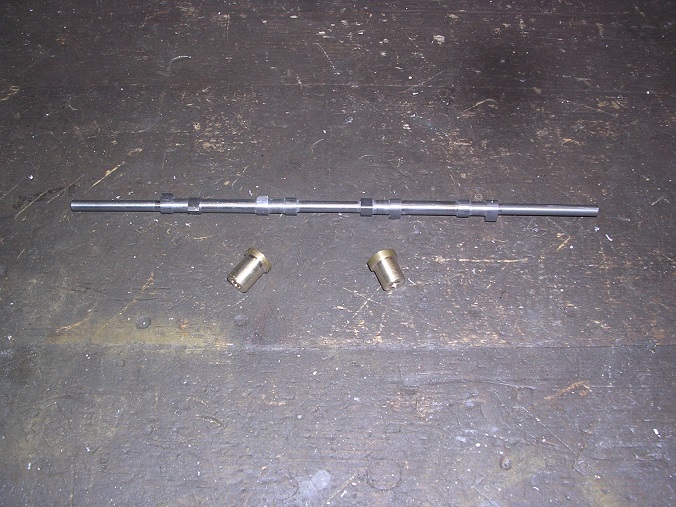

I have also turned up the final camshaft end bushings.

Fantastic fix for perhaps one of the ugliest jobs there is. Why they don't cast the cam area with extra metal that can be later machined out I have no idea. I would pay whatever it cost in extra aluminum not to go through the extra work involved.
The Holt castings are like that.
A method that I used seemed to help a bit. You put the first hole in (finished diameter) then make a guide bushing that fits snugly in the hole. The bushing is long enough to go from the end of the block up to the next bearing. You then take a piece of shaft that fits nicely in the bushing and drill the end to lightly press in a center drill. Oil up the shaft, slide it into the bushing and center drill the next hole.

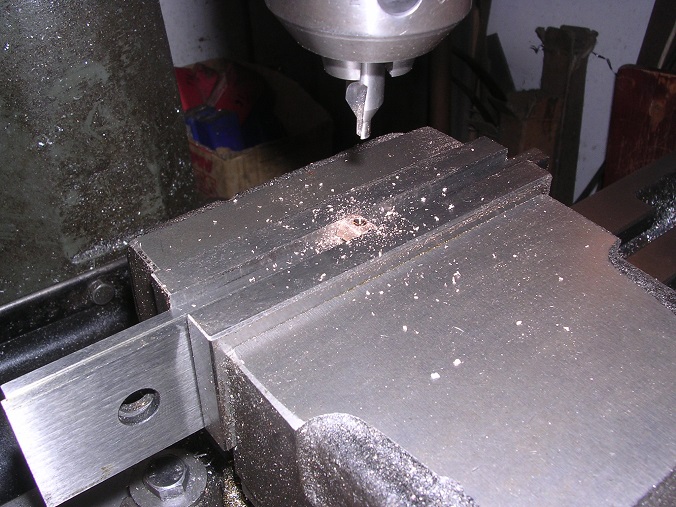

Yesterday, I made a start on the connecting rods. The drawings specify 'Dural' which I am told is a generic term for high tensile aluminium alloys. I managed to obtain some 2014/HE15 which my supplier recommended. The first challenge was how to hold and machine the things and I did spend a long time puzzling. When in doubt, start with some datum holes!
I took a skim off the face as well so that everything was flat and square.
I turned them over, skimmed to thickness and positioned the other holes using the leadscrew dials to get the right pitch.
Then a block in the vice with pegs to locate the big and little ends.
Last cut of the day, a moment's lapse in concentration and I moved the power feed the wrong way. The mill bit in, the vice moved the milling head moved and I smashed my new end mill whilst wrecking the job. I was not a happy bunny!
