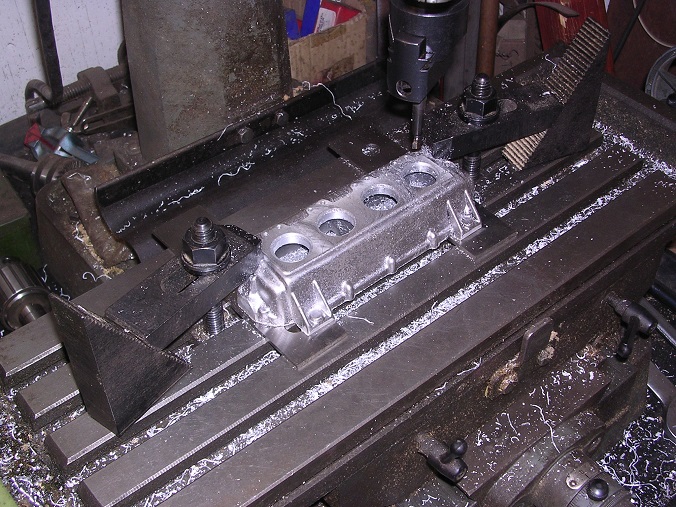

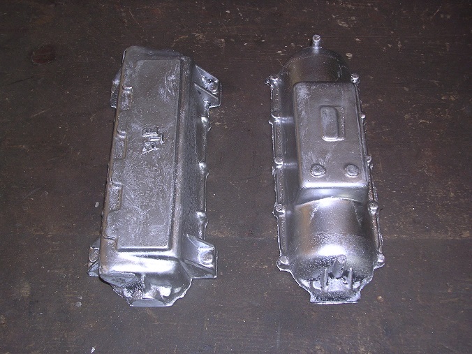

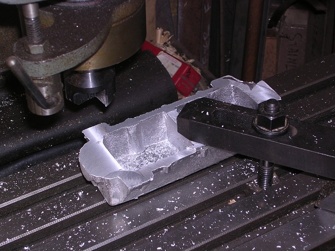

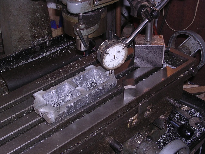

I decided to start with the crank case. Now, all of the castings for this engine are a devil to hold.
I dogged the top half to my Taiwanese mill and skimmed the ends to give myself a datum. I also ran a mill along the feet for another straight edge.

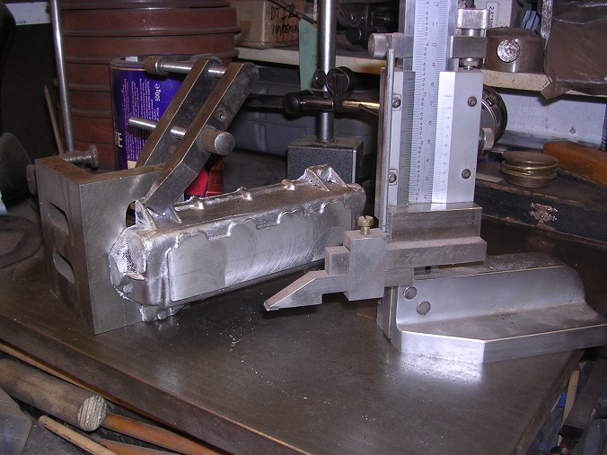

The a bit of messing with the height gauge to find the centres.

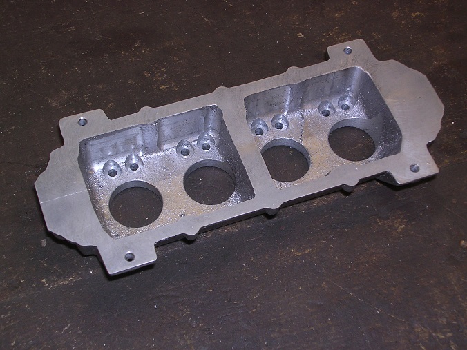

Then drill and bore for the con rods. Now, the drawings for this engine could be a bit clearer and show more of the detail. Fortunately, I was switched-on enough to think of the block hold-down studs and took the opportunity to centre for them and the push rod bushes by coordinate drilling. In other words, by counting the numbers on the dials. One day, I am going to invest in a DRO!
Then I turned it over and skimmed it to thickness using a pile of slips and a clock gauge to measure it.

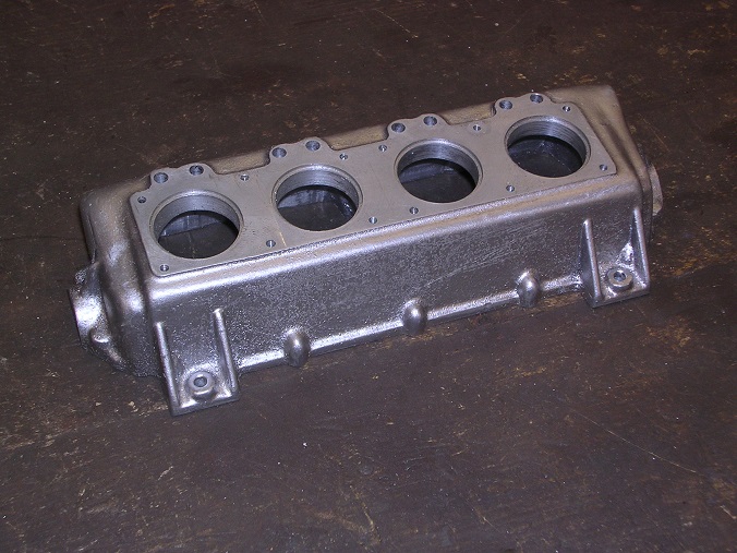

Spot face and hold-down holes.
First component well on the way!
I must admit that I am enjoying this one. It is so nice to be able to lift everything and to be able to fit it onto the machine with space to spare! Sump next. Then I am going to be looking for some advice as to how to drill the crank and camshaft holes.

Looks like some nice castings Bill and I can appreciate the challenge in holding them for machining.  Are the drawings in metric or imperial?
The castings are quite nice and haven't been over-fettled. I would much rather clean them up myself as foundries tend to be a bit brutal to say the least! The drawings are all metric. However, my workshop is imperial so my calculator is now sitting on the bench. I am making the engine in metric units to drawing but am using BA threads as they are what I have and am tooled up to handle.
