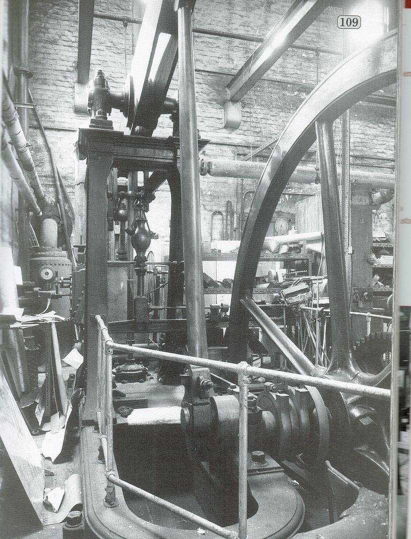

Just in case you feel the urge to do a JL and model the engine room this is the engine when it was in it's original working place at Banstead which is not too far from me. Then again you would really have to model the pair :LittleDevil:

Hi Jason, thanks so much for the photo it is good to see it i situ. is this one of George Watkins  photos ? I do have some of his books. It still has the railings around it that i thought Bressingham had installed but apparently not  ! You don't have the other engine perchance !!

Yes it is in his London & South East volume. Just the one engine, maybe the other had already been removed by the time the photo was take.
I hope you are not planning to include the Kee-Klamp handrail.
