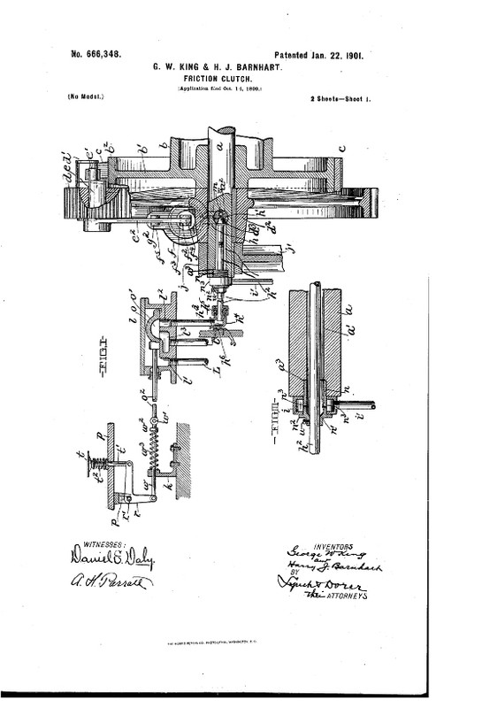

To (badly) paraphrase the movie CrockaSteamDial Dundee:  Thats not a clutch,  This is a clutch!Steam actuated through the axle!
Offline Steam Haulage
  • Posts: 222
  • Notts UK
Re: Over Center manual cone clutch
« Reply #10 on: October 21, 2018, 08:43:50 AM »
The give-away is King & Barnhart at the top of the patent! Weren't they the Marion designers?
Jerry
Dogs look up to you, cats look down on you, pigs treat you as equal.
  • Posts: 18554
« Reply #11 on: October 21, 2018, 03:52:01 PM »
Jerry
Yes, brilliant inventors.
