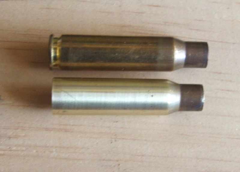

Oops - a bit of resizing in order. Having problems with my photo hosting service - attachments for the time being I'm afraid.
Step 1; turn away the extractor groove in the bottom of the case and drill what is left of the flash hole out to 6mm.
Step 2; trim the case body down to 25mm length

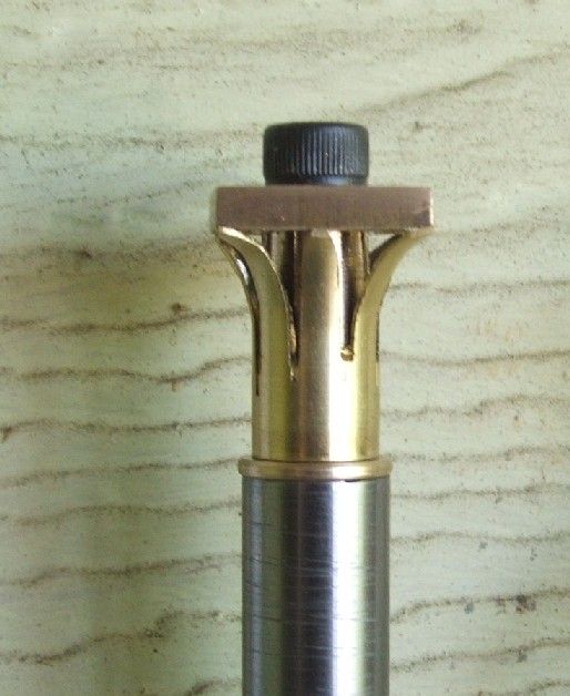

Step 6. The insert was turned (reasonable fit inside case) from a piece of 20mm square brass.
Step 7; ... and shoved into the case, seated home with an M6 bolt and nut.
« Last Edit: October 20, 2012, 08:50:41 PM by tel »
Offline tel
  • Posts: 1657
  • Bathurst District, NSW, Oz.
Re: Experiments with capitals for the S&P beam
« Reply #5 on: October 19, 2012, 09:52:24 AM »
Right way up! Ready for trimming and shaping of the 'petals' - gonna all be hand filing I suspect.
Watch this space.
« Last Edit: October 20, 2012, 02:23:09 AM by tel »

A long way short of perfect, but on the right track, I think.

 ;D Well, getting somewhere near it. Now I need to try one with some decent set-ups for the cutting and shaping - that was just knocked out more or less freehand.

« Reply #20 on: October 21, 2012, 02:19:34 AM »
Exp #2 has commenced. First, the recipe as before - turn and trim the case to length.
Second, dig this doohickey out of the drawer and set up the Dremel for a bit of controlled movenement.
Third, slit the case. This time I also managed to remove a bit of the excess material with a bit of manipulation. Now to knock up some sort of profiling tool.

OK, the body needs to be a bit shorter, the slots not quite as deep and a bit better shaping up of the 'leaves' but this is getting very close to a capital that I could live with.
