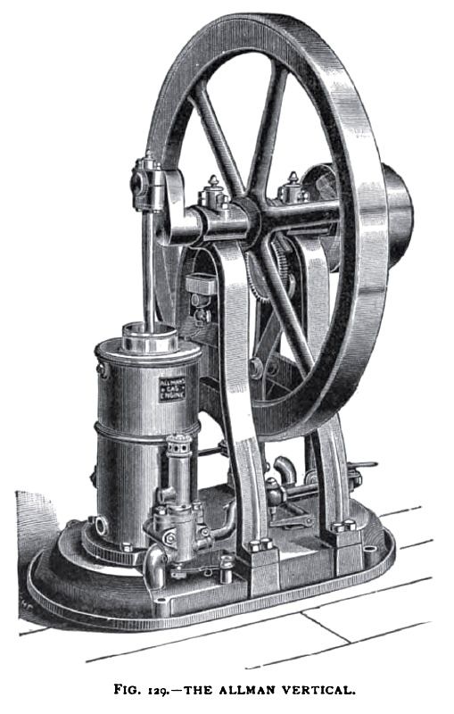

Thank's Graham that will give me a height to add onto the top of this
I was aiming for 7 1/16" high but found that the Bangood cutter does not do a vertical edge so after this the A frame had a slight sideways lean >:(
I'll have a play around with the gear sizes as some of the smaller tooth counts are not so easy to cut as the ones from the likes of HPC have the right undercut as they are cut on a proper gear cutting machine.

I would have thought the original engine used whole unit imperial measurements JB  :noidea:
I have run the numbers on the original 24/12 tooth gears and the two options I have are: 20 DP which gives 34.3mm between centres or 24DP gives 28.56 between centres. I might try cutting them to see if they would run true  :thinking:
7.045 about as near as I could get to a WHOLE 179mm Jo  :LittleDevil: But if you want to do your own drawings then I'll just let Andy and Graham have copies of mine.
I wanted to keep as much metal on the casting as possible so that the pivot for the larger gear will be able to fit the top web of the A- Frame, as you can see there is not much to play with.  Attached is what there is to play with assuming I can get the bearing castings to finish up at 7/16", if I had come down to 7" that would leave me even less to play with.  Still need to decide whether to just tap and spot face the web or add a boss to give a more substantial fixing. This is why I am machining parts as I go along, not worth drawing something that can't be made from the castings we have.
I am also finding that the castings generally have about 1/32" machining allowance so again 1/32" off top and bottom would have given me 7 1/16" to get down to a nominal 7" would have been a lot more off the top so not consistant with the other castings and therefor probably not what Graham made it to. Any more off the bottom and the foot would have been too thin.

Don't waste your time. You did not read what I said about the distance between the bore and the valley being too small.
12T 24DP gear is 0.580" OD Addendum 0.041, dedendum 0.052 so 0.186 off that mean the root to root distance across the gear is 0.394 so it's not going to fit a 1/2" crankshaft without all the teeth falling on the floor :insane:

I'll assume a 1/8" throw on the eccentric with 7/8" OD and leave a boss to suit cutting it afterwards I've just realised a slight change in design is needed to assist the timing because of the spacing of the gear teeth

7/8" eccentric will leave you rather thin on the strap maybe 0.050" after it's been cleaned up ::)
Don't see why you would need the eccentric so large, the bigger timing gear could run on a 1/4 or 5/16" pivot so 5/8" OD would do.

I suppose we should also bear in mind that what is shown on a patent drawing does not actually reflect what would have been found on the engine if it had actually been made. Once they got round to some engravings of engines you can see they used more normal gears with a lot more teeth, just like this one I made earlier.

I didn't enjoy cutting the big gear having bits of teeth left all over the place  :paranoia: It looked better once I added an additional cut and fettled any strag ends.
They roll together ok wouldn't have any power but in this application they don't need to so I will let his lordship add those to his castings   :pinkelephant: and I will get on with what I should be doing while I wait for more castings from Graham  :-X
