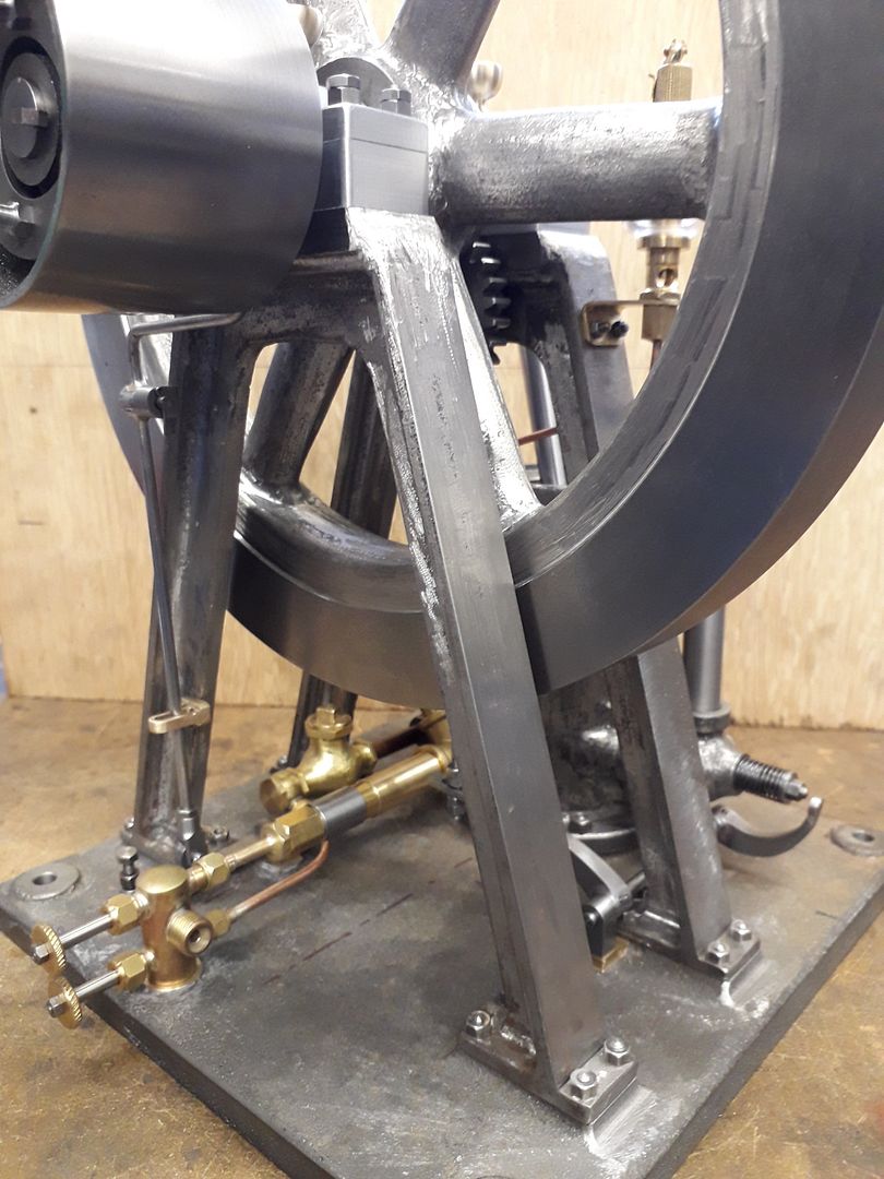

Despite other distractions I did manage a bit more on this one over the weelend.
First the insides of the two valves were machined and then all the bits could be silver soldered together before finally drilling the connecting passages. I also opted to add a small boss to the base, a spot faced surface may do for others but the surface of my casting was not ideal in this area.
With the valve in place pipework could be finalised and the nipples soldered on for a trial fit.
Another job that needed doing was making and locating a bracket for the drip feed oiler and making up a small run of pipework.
Hopefully there should not be anymore work to the base and A frame castings needed now so those working drawings can be completed.

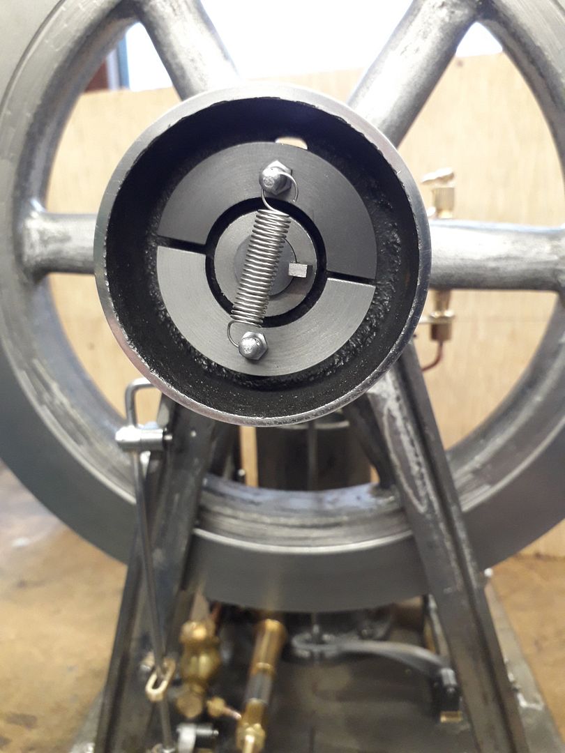

I spent most of the weekend workshop time on this engine as I wanted to get it finished ready for taking out next weekend. The jobs included
Plug for the primary exhaust as the engine makes better compression and has a longer power stroke with it blanked off.
Guide bracket for the governor rod, there looks to be something similar on the patent drawing.
Finish off the governor weights and some pins for the spring
Also made the last few studs and some oil cups and shaft keys to complete the engine. Doubt it will get test run for a week or two but fingers crossed it will go, compression is quite good even without rings or gaskets.

Thanks for the comments, it's been an interesting one to do particularly as there were no drawings and some of the castings had their own challenges.
I don't think red would suit this one, quite tempted to go with satin black as that looks good on the early engines but a dark satin grey could also be on the cards.
