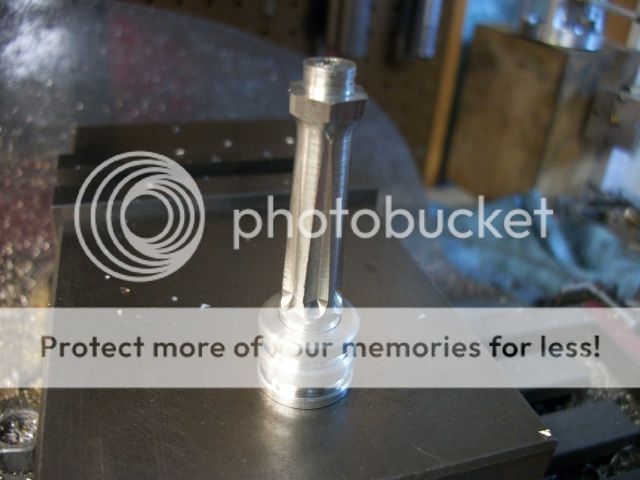

Starting with the body, turn to profile:
Bore to suit the spindle diameter:
Now we slit the end to take the arm hanger. You can use a slot drill if you want but I prefer a slitting saw and to take multiple cuts:
Which gives us this:
