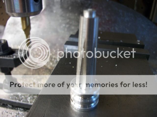

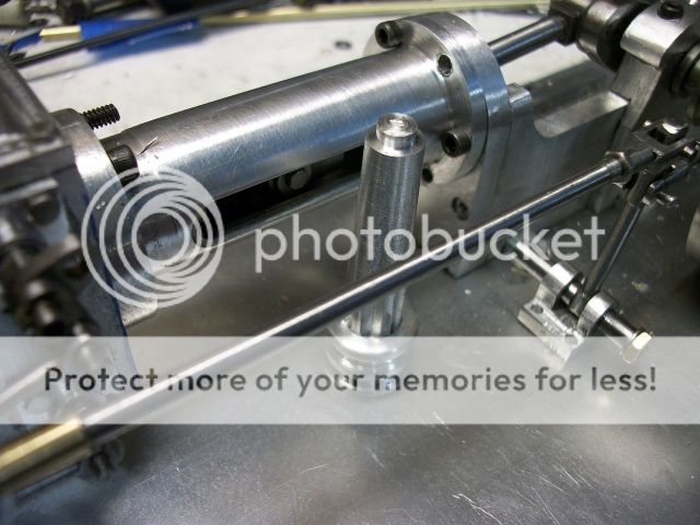

« Reply #6 on: October 16, 2012, 12:27:36 PM »
Hi Jo,
Here's a shot of my Mary governor if it helps.

This could not have come at a better time.  My "Notacorliss" is going to need one soon so in anticipation, I knocked off a pedestal for the mounting.  Six flutes on a tapered column.
I'm sure to learn some useful stuff here,
Jerry
