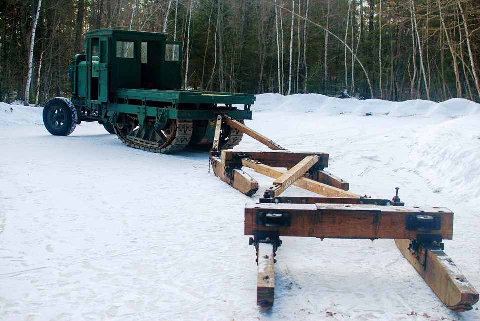

Well I have decided to build my version of the Lombard.  It will be 2 inch scale (1/6).  That will be a 5 foot long model.  I wanted to have something to ride behind.

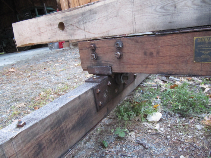

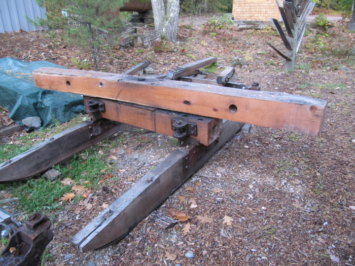

Propane,  coal is my preferred fuel.  That is the original intent anyway,  I don't see an easy way to fire it from a log sled (wagon) riding behind the thing.  That is subject to change once I get further in the build.   The projected size will be about 5 feet long and a gesstimate on weight is 4 to 5 hundred pounds.  We live in a cubed world.  I initially wanted to build in 2.5 inch scale to go with my narrow gauge trains. But that would have been just too big.  The boiler will be locomotive style with a scheduled 40 6 inch pipe about 30 inches long.  working on the drawings and stress calculations and probably operate at 110 to 125 psi.
