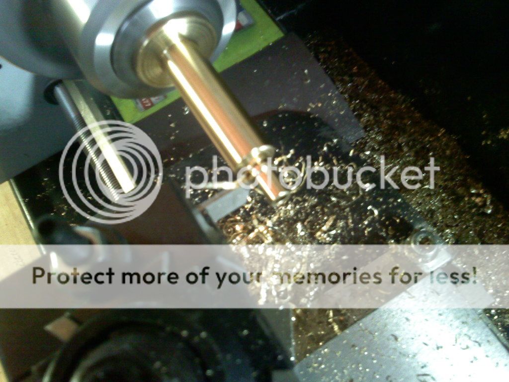

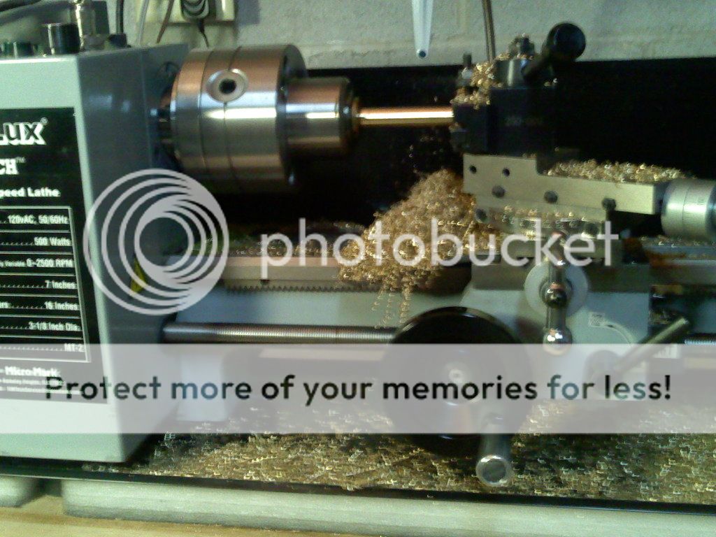

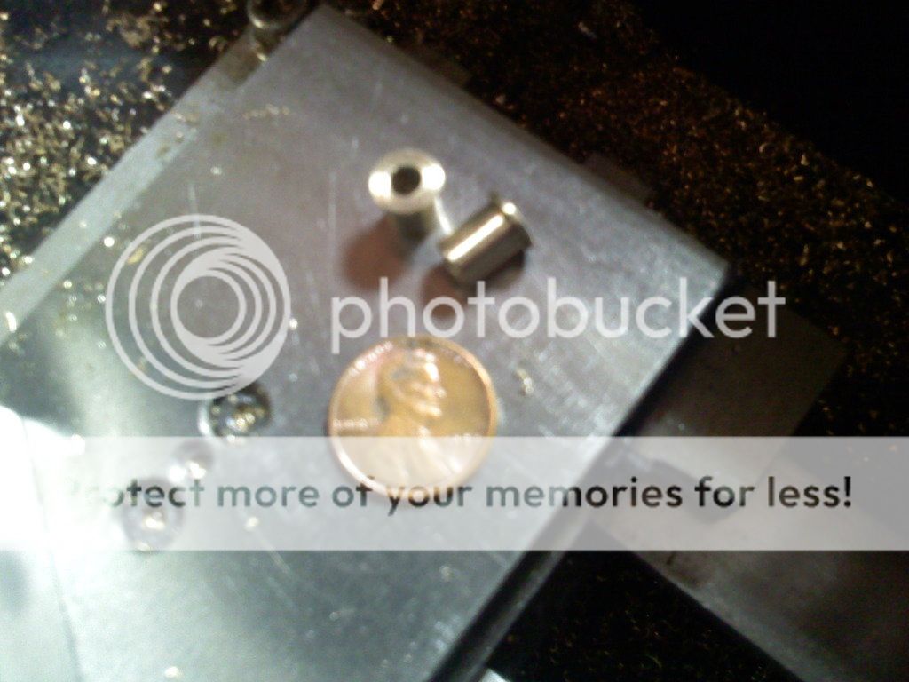

 I only had time to make a BIG pile of bronze chips and a couple bushings....the chunk started out at 1.125"...seemed a waste all that bronze but it was a free piece... I didn't realize the expense of some of the metals until you actually have to buy it !! I get a lot of mine from thrown away bits.
 Turning down to size...Bronze is some tough stuff !! I was using a black moly tapping / cutting fluid to lube, that made it cut to a better finish...

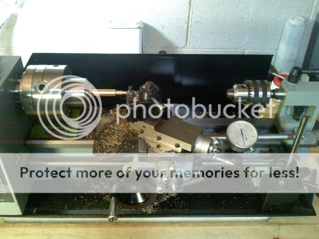

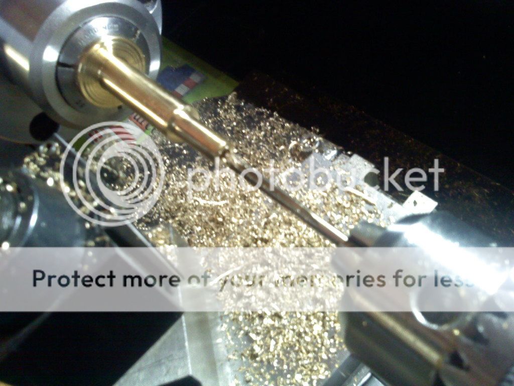

 Here is some of tonights efforts... reaming to size...
Parting off...
Two completed bushings...
 That's all for today... I know it's not much but like wine it takes some time :)
thanx again... V 45

Hey, I just caught up reading your thread don't know how I missed it. I going to be pulling up a chair here, looks like an interesting projest. How do you like your Microlux lathe? I see you installed a 5C chuck on it. I was never happy with mine, but I still have it a use it less since I purchased a Myford.  I had installed DRO'S on my microlux they are a great help. Great job so far on your engine.

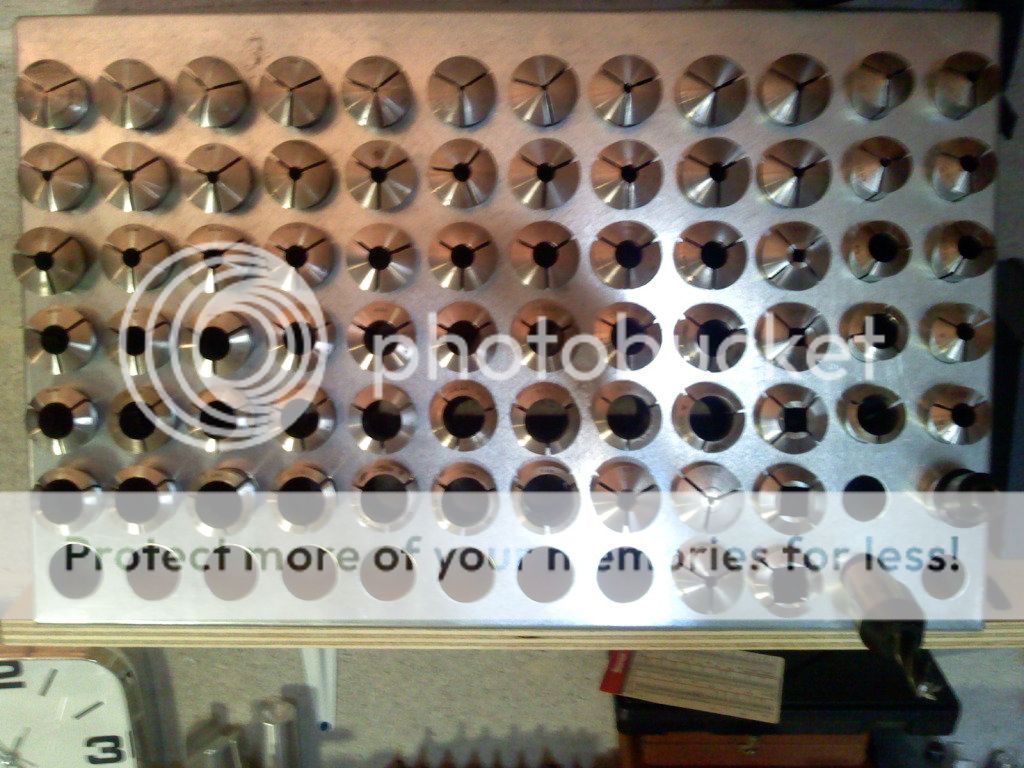

Don...So far I like the 5C chuck. Did you have the 4 inch or the 5 inch? Why didn't you like yours? I like the lathe ... I have put tapered gibs on and the tailstock mod, plus the carriage gear cover. I picked up a 12x24 lathe...but it still lies dormant in my garage !! Need to wire basement for it plus make some room for it. Then to get it down there !!!
I picked these up really really cheap...90% are Hardinge. I had my buddy make the rack, it also holds some of my R8 tools as well.

Wow!   You've got more way more 5C collets than I do!.... :ROFL:
Good for you!

Hi Dave...You would cry for what I paid at a local flea market !!!
$40.00 for all of them... :whoohoo: :whoohoo: :whoohoo: :whoohoo:
A super great find...not sure the guy even knew what they were !! The guy just said take them all...so I did !!!

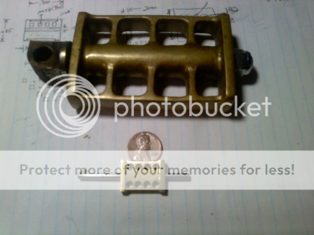

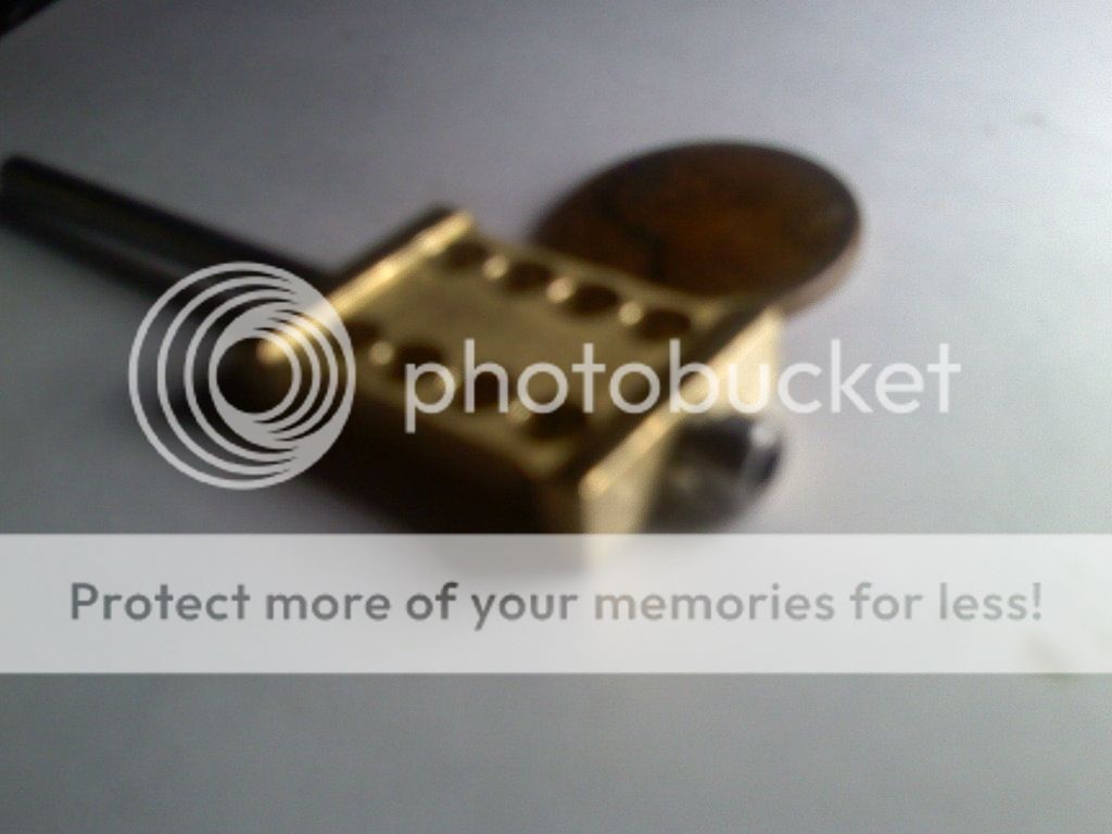

I had a little time and made a kicker pedal...almost like my full size from one of my older bikes...I will polish it later with some of the other parts...wasn't real keen on making square holes that small !!

Well got tiny bit more done...the shaft and the turn-out ...I used 1/8" drill rod for the shaft and drilled and tapped for a 4-40 screw that I turned down on the lathe. This supposed to be all one piece but I made it three. Milled out the little turnout piece and drilled for a press fit of the shaft. All that is left is to drill the hole for the mount screw on the kicker arm. I don't have a good camera, just a dummy phone...lol

Good going V  :ThumbsUp: - I hope that gash on your head heals soon  :)
I have some serious collet envy now  ::)
 ;) A couple of strokes with a square needle file could have those holes squared up in no time.
