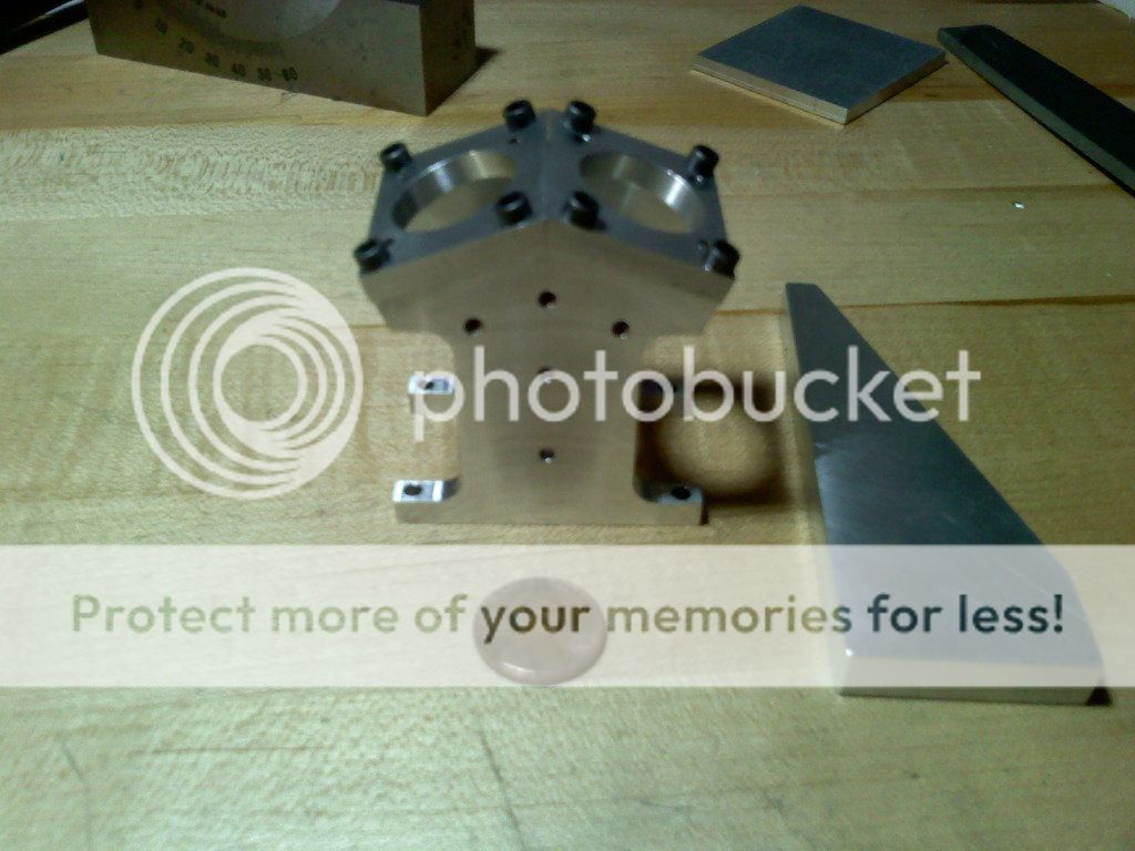

These are the crankcases drilled and tapped. Still need to drill out hole for the crank for the bronze bushings.

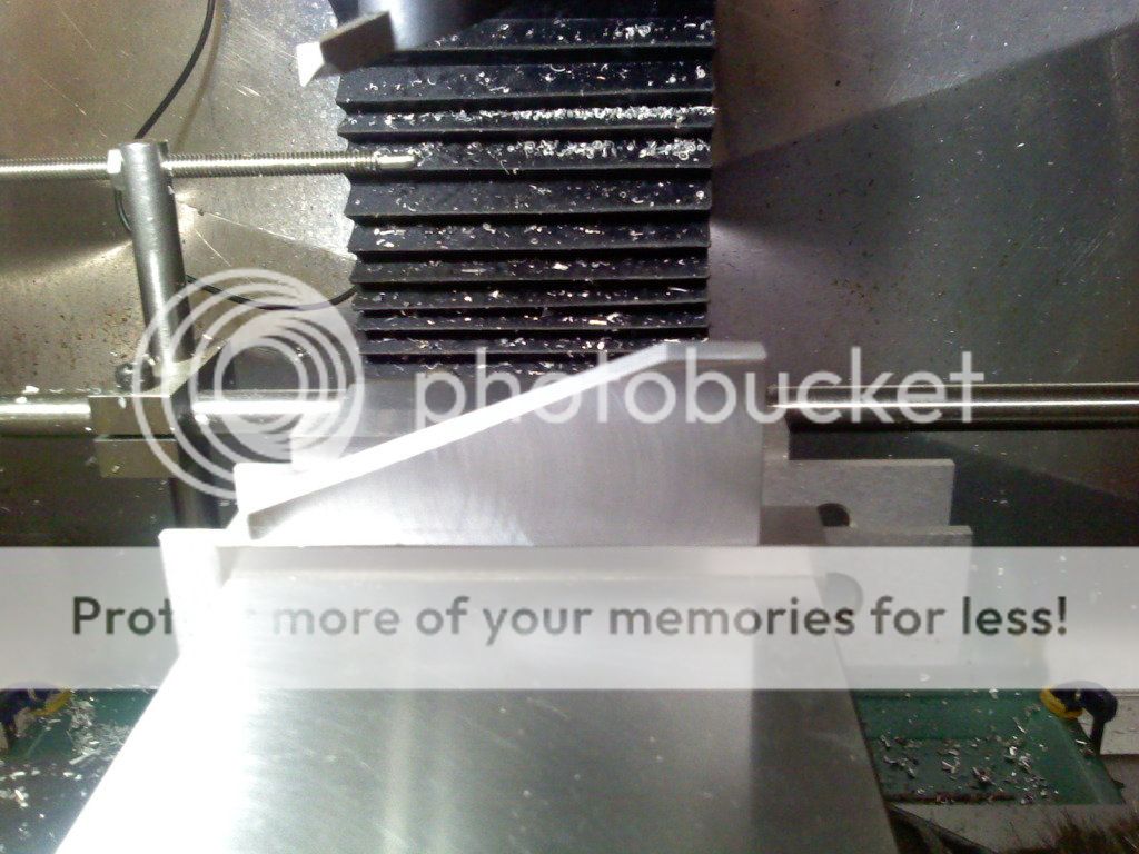

I had to make a 21 degree angle block to make the above plus future parts...here is the start of it...

Here is the finished 21 degree block...

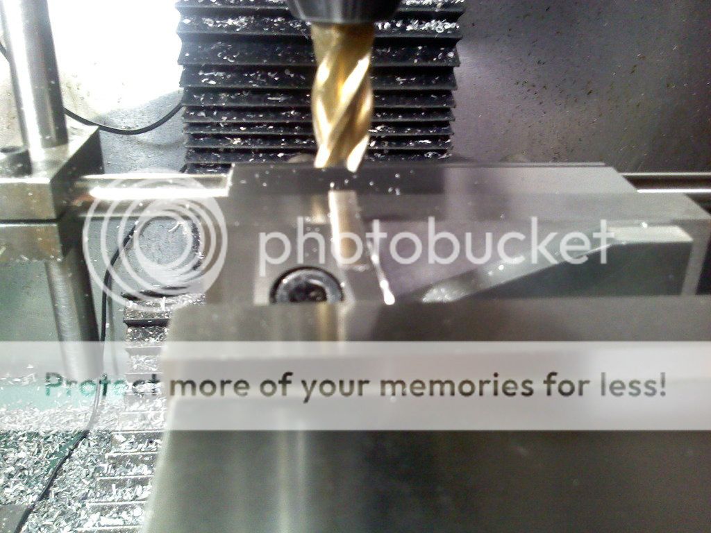

Here using a adjustable angle block to drill the holes...also to mill the top angle of the crankcase..no pic of that. It sticks out of the vise a bit...that's why I made the angle block..to the work piece lower in the vise.

Here is the 21 degree angle block used to cut the top plate angle of the crankcase. Seems I went out of order on the post...oh well...live an learn is always a lifelong journey ! Not sure if this was the best way, but it's what worked at the time.

Another pic for the evening...here is the crankcase assy and the angle block...almost completed except fot the bigger holes for the actual crank and cam bushings.
