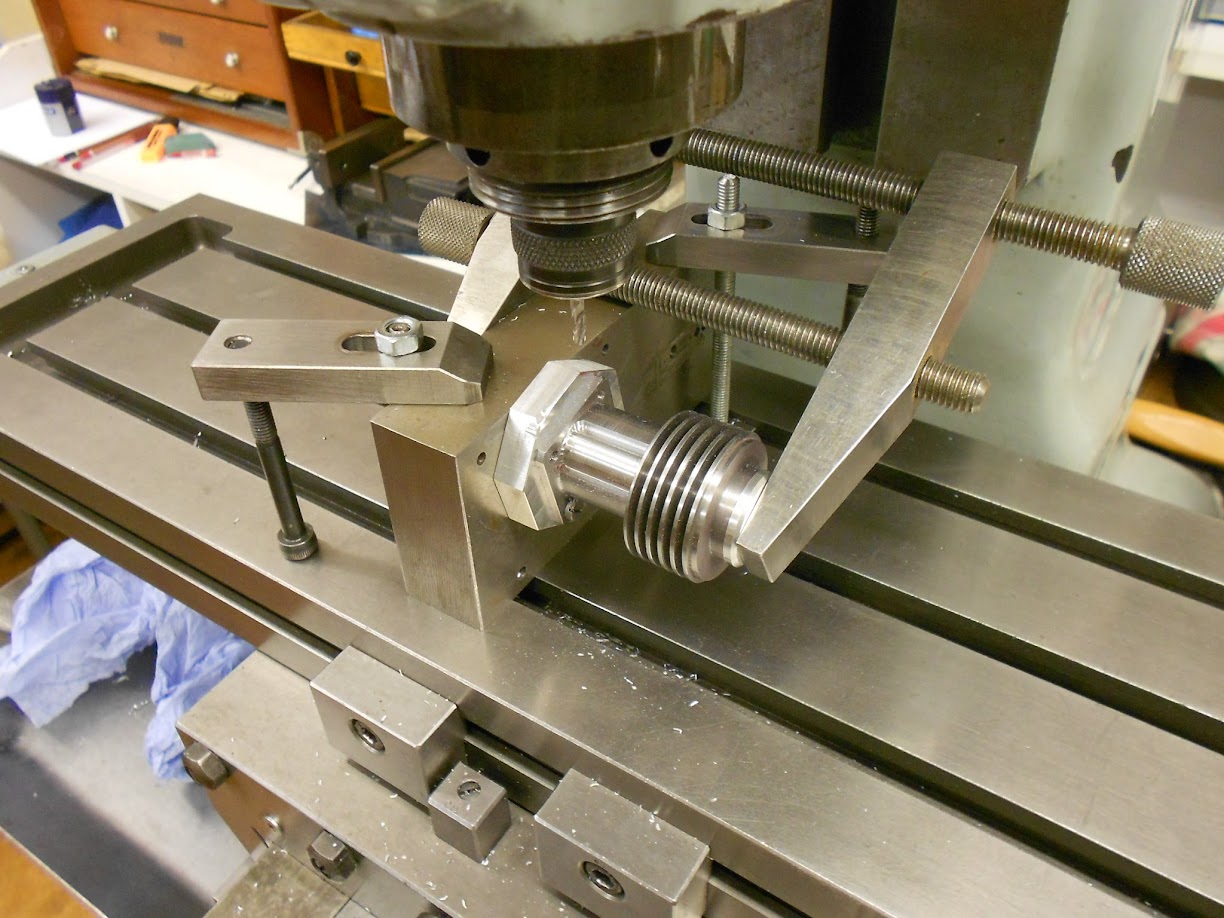

The cylinders do not have a liner and as such are turned from leaded EN1a. The machining was relatively straightforward but the two bulges that are over the transfer passages required a different approach which you may find of interest .......
First up was to finish turn the bore and rough turn the basic ODs
Make a new expanding mandrel to suit the bore and machine the fins and lower flange dimensions
Then modify an old one to hold it on the mill .....
The teeth of an end mill cutter were modified on the offhand grinder.....
...... to plunge mill the transfer passages in to an exact depth
Set back on the longer mandrel the exhaust side of the case had the relief milled in
Finished example and the transfer side to do - the bulges required can be seen in the drawing. I would assume the original was machined on a copy lathe but with no access to such another means was sought.
A fixture was made to hold the cylinder via the hold down bolt holes. The two larger holes sit on the centres of the transfer bulge radii
A block was set square to the mill table with a pin set in for the fixture to rotate about
then by rotating small movements and clamping the radius was slowly formed. Once done the cylinder was moved to the second hole and the machining repeated
Back on the small mandrel to cut the scallops out - the bulges can be clearly seen here
And finally - finished ready to lap

Slick work as usual Tug!  Can you explain why you ground the end mill in order to cut the transfer ports (~10 pictures from the begining of the post)?

If you look at the drawing on the same image you can see I have tapered the transfer passage into the cylinder to assist the flow. Modifying the cutter was how I achieved a reasonable transition. As long as the actual edge does not stray far from it's designed position then the timing remains fairly close to the designed amount. The actual shape is not that important hence the freehand grinding. Usually the passages are cut into the crankcase with the porting cut into the liner to define the timing giving much larger passages but this is how the original was made.
Bear in mind this is predominantly a model engineering exercise and not an attempt to make anything with exceptional performance - as long as it runs reasonably well I'll be more than happy - hopefully you'll 'hear' the result at Forncett ;)
