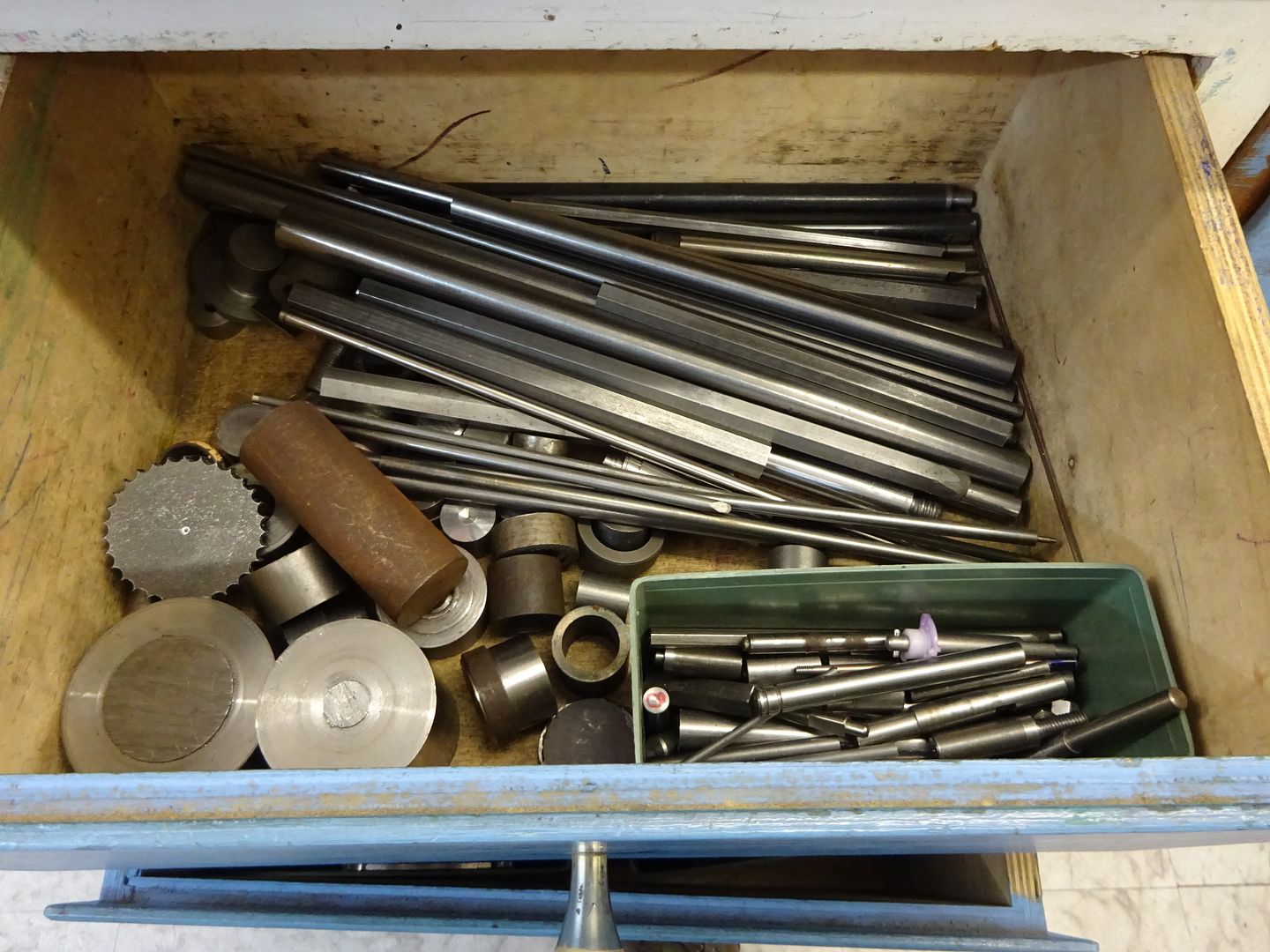

 :thinking: Looks like you are planning on storing a lot of longer material. I tend to have less long stuff and more stuff about 12" long.
What do you guys do for metal storage?
I managed to "acquire"  :naughty: an old industrial 18" deep rack from my supplier one which matched the 12" one I already had  :) As you can see I store the 12" long bits of material end on on the smaller rack and longer pieces on the wider rack. Sadly these are in the main garage so they get condensation so the Steel over the  :o 20 odd years I have had it has that brown protective coating that Jason appreciates so much.
I was also lucky to buy a little double set of secretary drawers which were deemed to be too shallow to put tooling in. My supplier when he saw what I had done regretted getting rid of it. The deeper metal secretary drawers are nice but the weight of metal in them can rapidly get a bit too heavy.
There are a few bits of steel that I don't want to get that brown protective coating on and those are the ones that I don't intend on machining all over (hex & square) and these seem to have sneaked onto the shelves in the work shop   :headscratch:

If I did not know better Jo I would have thought that was a wood storage rack - so much brown stuff. :stir:
Will take a few pics of my storage later but I seem to use metal at the same sort of rate that I buy it so there is not too much to store :)

Thanks for the pics, Jo.  I appreciate seeing your storage system.  And you certainly have a lot of metal to store!  How'd you get it for free?  That doesn't look like 'free' metal to me.  I don't have any supplier of free stuff like that!  Sure, I've gotten a piece here or there from some cast-off item, but nothing like that kind of selection!  Only a few small sheets of aluminum or a little mystery metal rod or something.  Nothing like that huge inventory!
When I buy bar stock, I tend to get 48" lengths because the price per foot usually comes down pretty quickly after the first foot or two, and then that way I'll have extra for muck-ups and for future projects.  But if its expensive larger dimension stuff, then I get what I need. So I have a lot of 24-36" stock and of course, shorter pieces too.  But this seemed like a good compromise for now.  Clearly wouldn't work for the amount you have!
The story goes: In a past life I was married  :facepalm: to a guy who was in charge of the local apprentice school.. each year they brought the materials for the number of apprentices they expected but always a few dropped out and that meant the materials the store man had prepared for the apprentices that left was scrap so they threw it out  :hellno: I got to hear about this so made friends with the Storeman and the scrap came my way.. in the end they closed the apprentice school and everything had to go in the skip so I helped :embarassed:
The HE30 came from Bluechip. Thank you Dave  :cheers: The space grade Dural came from the scrap bin outside the satellite machine shop when I was an apprentice.
I normally buy the noggins = the end of bars. I can often get rather big noggins like the Gypsy Major crankshaft at little cost  ;)
