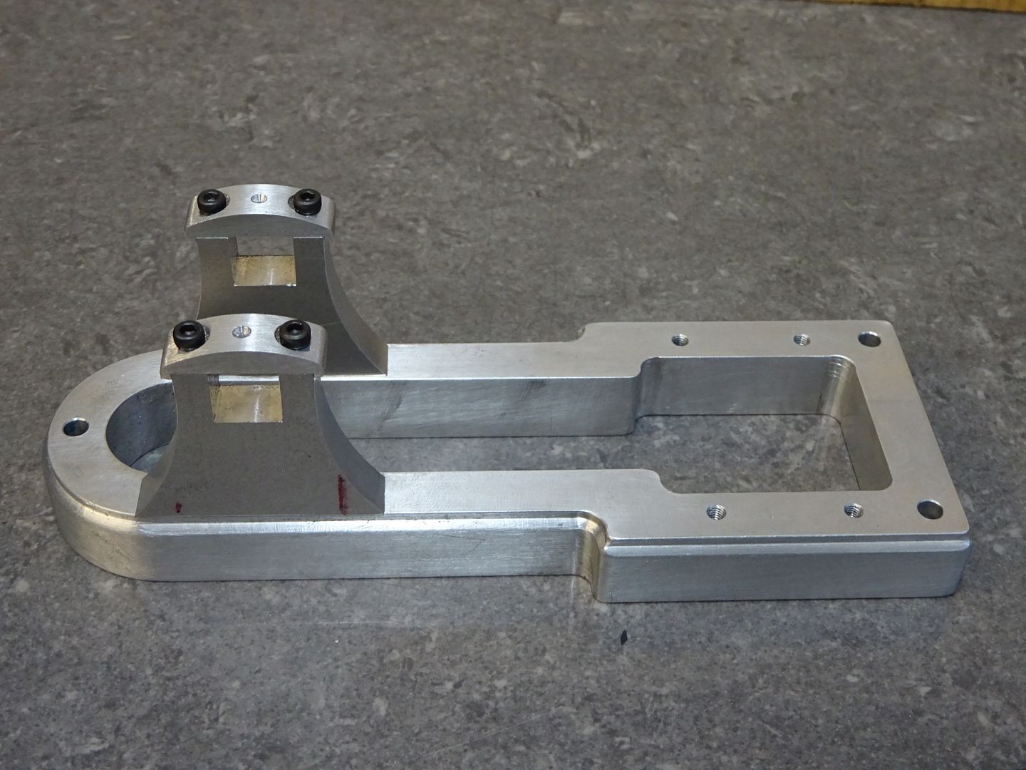

Some of you may have seen the thread discussing the pivot details of an old oscillating engien that I was thinking of building
http://www.modelenginemaker.com/index.php/topic,7715.0.html
Well I've made a start. I'm just going to put up the odd photo as the bits are done then when I know everything works will do a more detailed build together with drawings.
Sole Plate

« Reply #2 on: December 24, 2017, 07:51:22 PM »
Bill I did use the new mill for some of it, the main reason being that the table is about 5" lower than my X3 and the switches are also easier to reach when sitting as my back is playing up so I can't stand for long. Also tried out the 6" rotary table, being 72:1 rather than the usual 90:1 it is quiet nice for rounding parts as you don't have to crank the handle quite so many times. 12mm Carbide 2-flute cutter with aluminium specific geometry chomped through the 14mm thick plate at 1800rpm.

« Reply #6 on: December 27, 2017, 05:03:59 PM »
Today I partly reworked the bearing caps as I was not happy with the way the looked and have also added bosses under the fixings rather than the counterbores I had originally drawn. Also made the bearings and got the crankshaft together, when the Loctite has set I will cut out the middle of the main shaft and file the ends flush.

Looks great Jason   :)
Are the bearing block sides a circular profile?  They look like an elliptical shape so I was wondering how you managed to cut the curve  :headscratch:
  • Posts: 7273
Re: Old Style Oscillator
« Reply #10 on: December 27, 2017, 07:09:03 PM »
There is a short straight vertical section down to the center line of the bearing and from there it is a 40mm radius but as the C/L of the bearing is only 25mm tall you only get part of the circle making up the side.

« Reply #12 on: December 28, 2017, 04:43:32 PM »
I started off by machining the two flywheels this morning. You hear a lot of people saying recent Stuart castings are not as good as the old ones but these two were very good, little flash between the spokes which tool less than 5mins each to fettle with a couple of files and near zero mould shift between the two halves. Ran true in the 3 jaw and went from tool just touching surface to cleaned up with a single 15thou cut on both sides and face of the rim. Bored out the 8.0mm hole for a firm fit on the shaft which was tighter and truer than if I had used a reamer.
