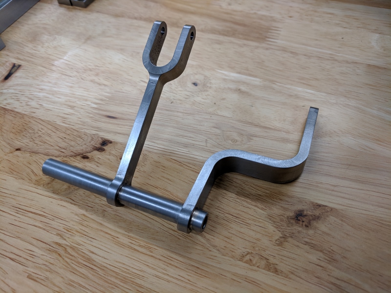

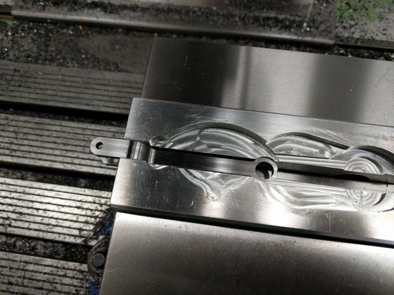

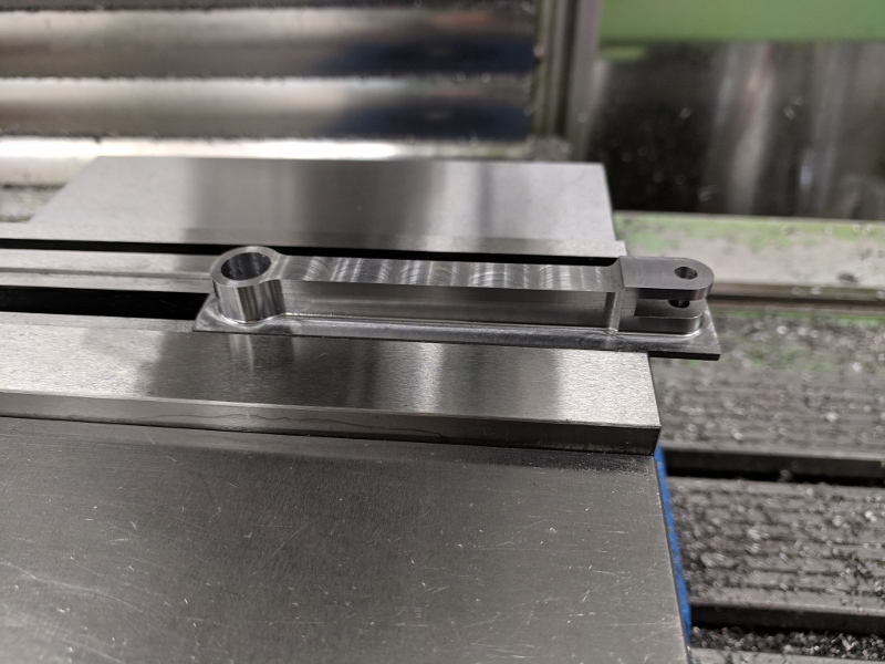

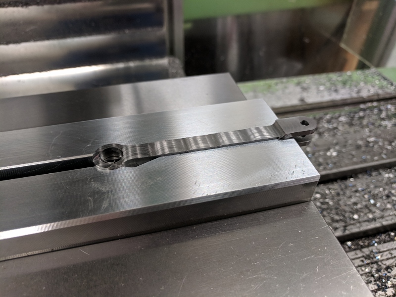

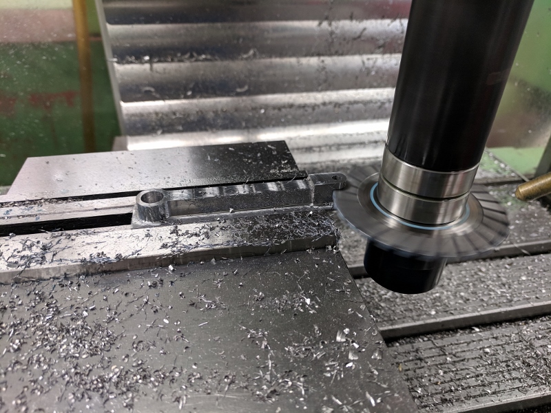

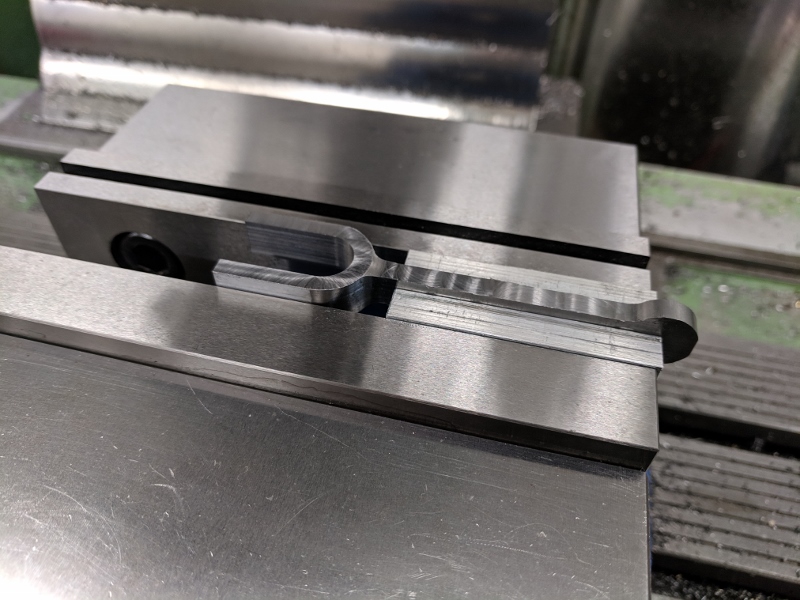

Today I make the fist "rear axle support", is it the name of it  ::) .
I used my CNC Mill and mill it of 3mm brass.
Regards Toby
Re: 1/3 Scale IHC Famous
« Reply #7 on: December 08, 2017, 02:52:03 PM »
Very nice work on the axle support Toby. The brass will look very nice too. As for wood finish, I usually use a solvent based wood stain such as Minwax over here in the USA. This is a water thin stain you can either brush on or apply with a cloth and is available in many shades depending on the base wood you are staining. That is followed by 2-3 coats of a polyurethane gloss finish from a spray can. This has held up well for me against oil and fuel.

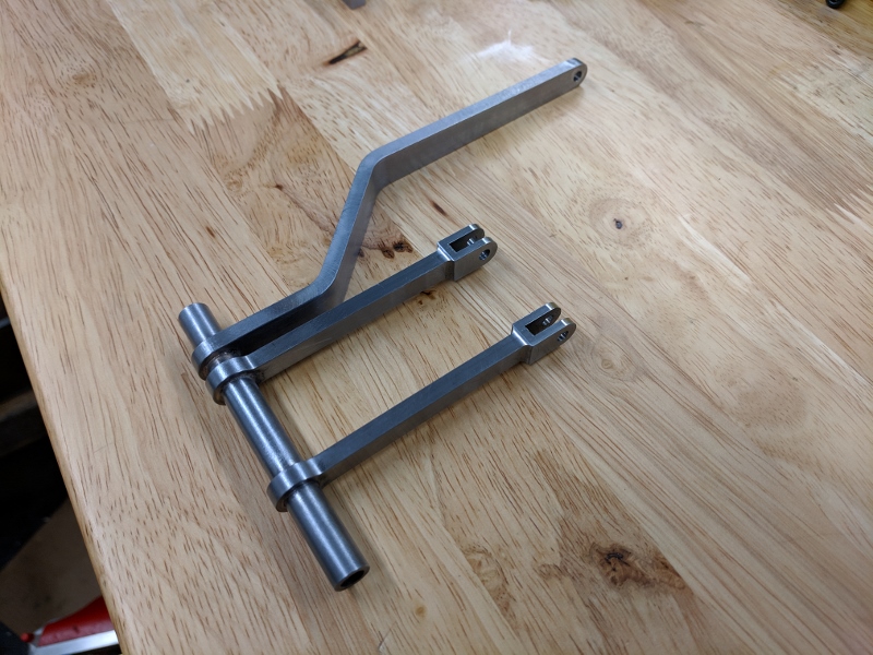

Hello,
only a little update, because I wait for some more materials ;-)
3mm brass for the other Axle supports, 5x5 and 6x6 stainless steel for screws.
At this time I begun to make the first Box and make some colour tests.
