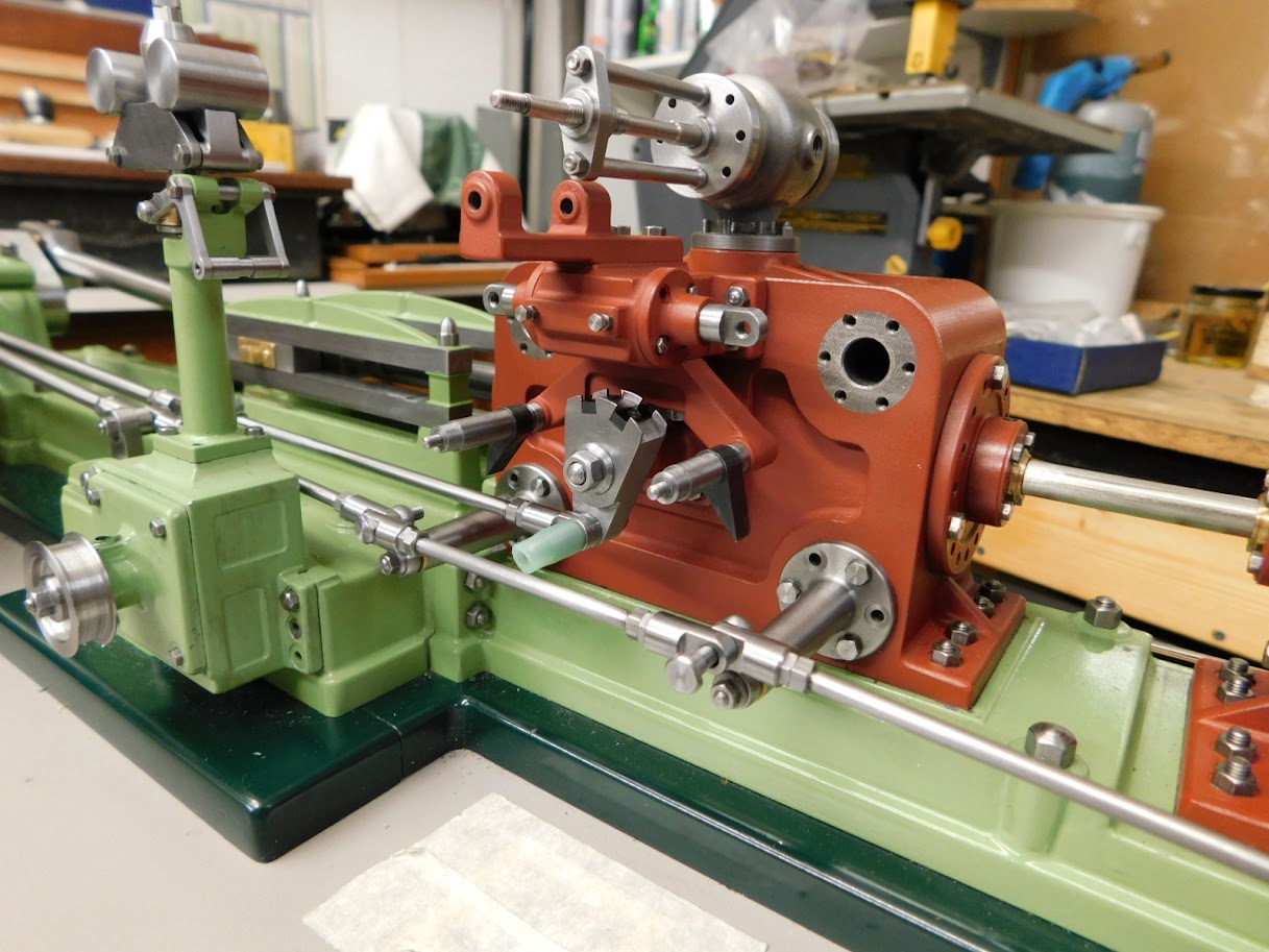

Hi Per, I shall look forwards to that Viking in due course  ;)
I've been picking away at the trip gear parts - all milled from cast iron and small amouts of JBW to give the odd fillet here and there.
Though I have found the drawings to be good overall there are some slight discrepancies in this area but with some careful jiggling and countless take aparts and reassmblies I'm getting there.
Here are a couple of pics of state of play as of this evening
The HP valve rocker is finally linked up which served to highlight the fact that any adjustment finer than half the thread pitch is out of the question. A 5BA LH tap and die is on order to rectify this situation.
The exhaust linkage had to be rearranged for clearance on the inlet linkage. New pins are required hence the loose parts
One of the things I overlooked when changing the steam stop valve to top mounted as opposed to floor standing was the bracket for the govenor linkage. I think I can get away with this by putting a spacer underneath the valve.
That's the latest - still the inlet valves and spindles to deal with plus more linkages  ::)
Regards - Tug
