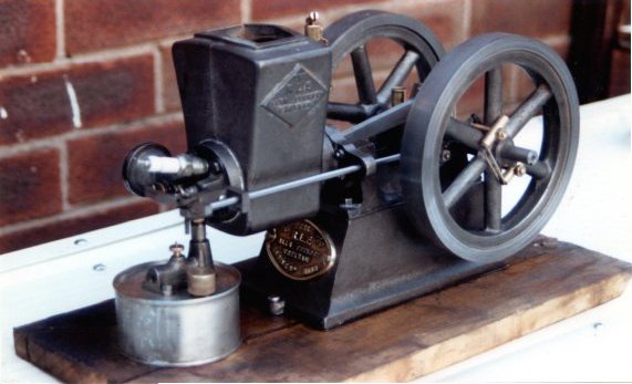

Some how or other Graham talked me into buying another set of castings from him  :thinking: I am sure I was only intending on buying a set of X Type castings but based on Jason's poking about my IC engine not running Graham recommended that anyone can get an RLE to run so I should be successful with it :noidea:
This is an RLE:
Well you know I am a sucker for a nice set of castings and when Graham showed me the castings  :-\ they had to be had... By the way if anyone is unsure you can tell it is an Alyn Foundry set of castings its by that special protective coating Graham applies to all his castings  :lolb:
P.S. How are those Sphinx castings you are looking after for me Graham  :???:

Jo, are you able to edit the title to the thread? R.L.E. stands for Roy's Little Engine after my first born son Roy.
The patina " rust " has developed over the last 10 plus years, your opening photograph shows a complete engine with the finish that was sent out to our customers. Buckley used a combined rumble and shot blast system that made them gleam.
I keep the website up for interest these days but we ceased trading in 2007 after 31 years.
I have a few spare castings here to help out with the odd accident/deficit....  ;)
Having built well into double figures R.L.E.'s over the years please don't hesitate to ask about construction hints and tips.
