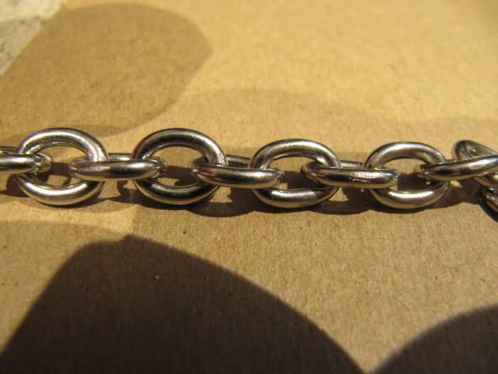

Yesterday and today I did some experimenting with making the proper size chain for the hoist chain, made it up like a typical rod bending jig with central pins, a guide on one side, and a nose that rotates around the fixed end pin to form the wire.
Does bend it fine, but cannot get it to join up the ends effectively to finish off a link. So, went onto youtube/google to see how commercial chain is made. Appears that they do both ends at once, with a pair of forming blocks, one to get the two ends around to 90 degrees, then ones in from the ends to take the link the rest of the way round. Anyone ever try making chain this way? This is fairly small chain, 0.09375 wire, links are .4375 x .3125 outside measurements. The chain I have on the model is the right size, but the links are oval, rather than straight down the sides like the original. It works fine, but its one of those little details that would be nice to do...

Ooh - on to something there!  Hammering the link flatter on the sides is tough, would need a grooved holder, so pulled a medium sized ChannelLock pliers out of the drawer, which has large grooves running crosswise in the faces of the jaws. Slipped that around one link at a time, squeezed down, and it did flatten the center section without deforming the ends much. Here is a pic of the initial test, the two links on the right are straightened, the two on the left are as bought, with a pronounced arc in the center of the link:
A subtle difference, but noticable. I think a little experimenting with the distance to squeeze, controlled either with a block between the grips or a little bit of rectangular bar in the link (which may be more consistant) will do the trick. The size of the wire in this chain is good, and the lengths of the links is good, it was that rounded center section that I object to. And I can do this with the existing chain, no need to make all those links....   :ThumbsUp:

I made up the plier tips, but they did not work well since the Channellock pliers have the pivot in such a place that the tips do not meet the same depending on the opening, causing the channel in the tips to offset. So, wound up just using the grooves in the pliers with a spacer to get consistant widths. Looks much better, just like the photo I posted the other day.
