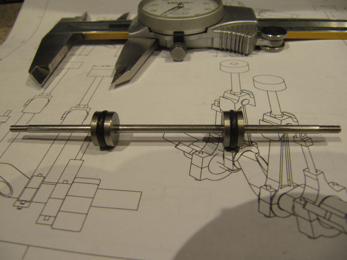

Did get time to start on the pistons, got the heads turned to size and the rings fitted (viton o-rings), and threaded the piston rods for the crossheads. The heads need to be attached and the rods cut to length, then can start on the crossheads.

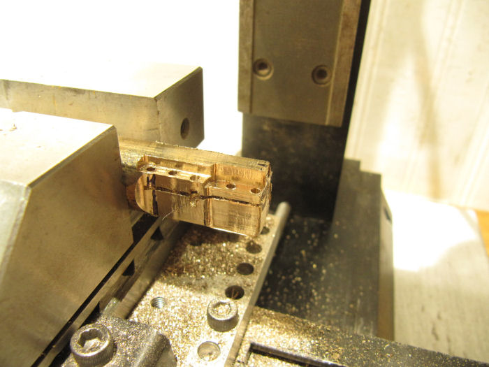

Continuing on with the piston assembly, this morning started in on the crossheads, turning to diameter/drilling the ends on the lathe, then milling the con rod pocket with it held in a collet block:

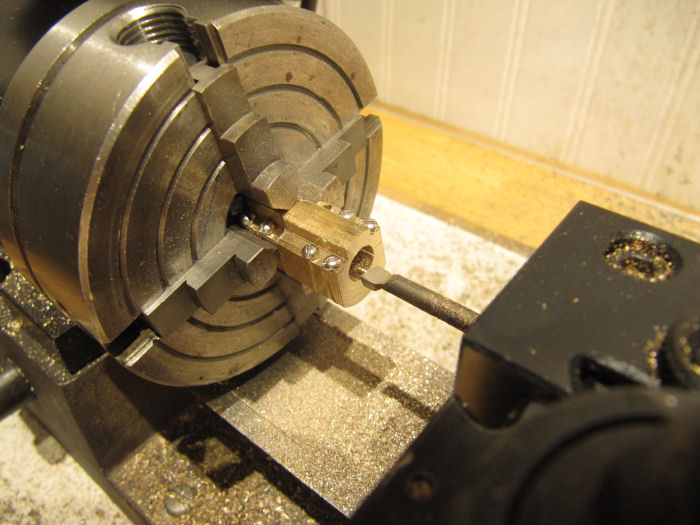

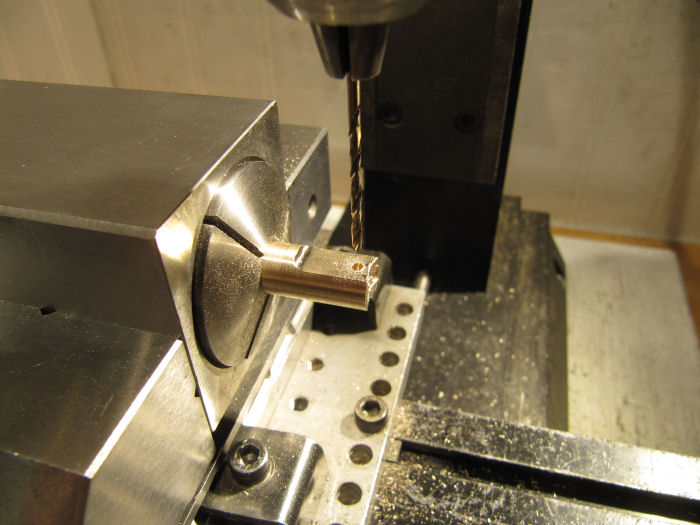

and drilling the cross pin and shaping the bottom end

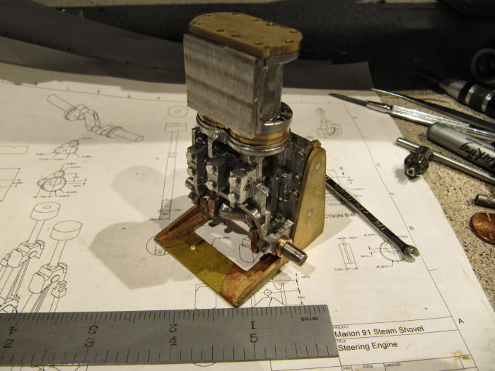

Test fit on the engine block, a little de-burring and it moves well.
Next up - con-rods. On the larger engines I made them out of steel with bronze bearings, on these I think I will make them all out of bronze, getting too small for that many pieces.

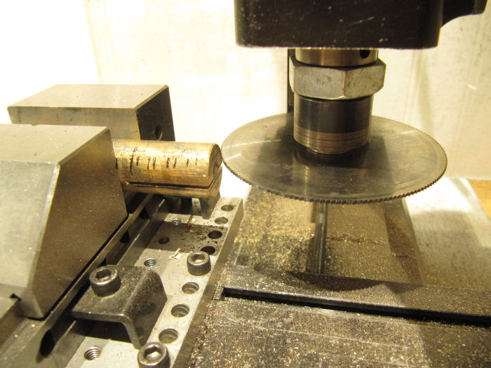

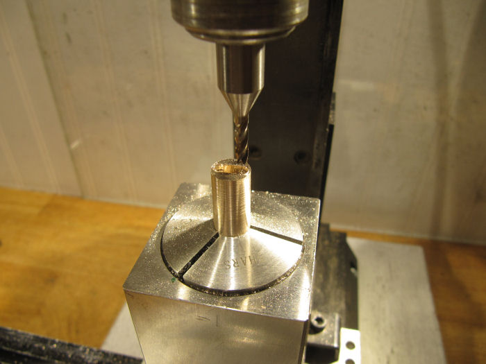

Started in on the con rod big ends and the eccentric followers, all out of bronze. The bar was first slit where the center of the holes will be:
then milled in the steps and drilled the holes for the bolts to hold the top/bottoms together for boring the holes out. These parts will be sawn off the bar, bolted together, then bored on the lathe while holding the parts in the 4-jaw.
You will doubtless notice that there are two sets, smaller is the con rod big end, large is the eccentric follower blank. Each has two sets of holes since two of each are needed. But, due to a CNC error (Count Not Correctly)   :facepalm:   I got too far out on the first set of the eccentrics and broke through the side. So went farther up the bar and did a replacement there.
So, next will saw the pieces off the bar and start cleaning them up in the lathe...

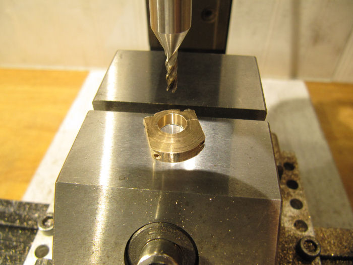

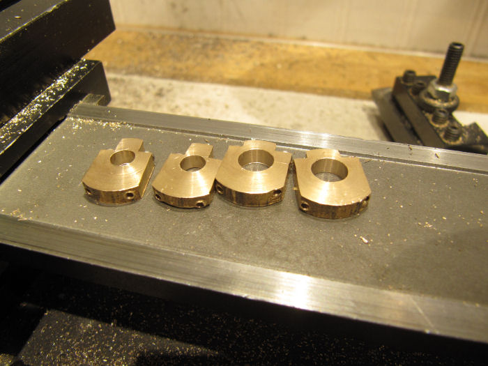

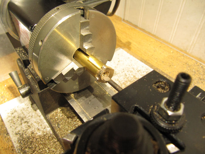

More on the big ends and followers - bored out the eccentrics to fit the inside of the slots in the cams, going by measurements since no way to test fit them at this point.
then parted off the two followers, trimming the outside face first
Turned the part around, drilled/bored the big ends of the con rods to size and parted them off too...
then trimmed the end of the caps down...
then made up a little expanding arbor, using a 5-40 SHCS with a taper turned into the end as the expanding screw, and used a small boring tool to cut in the shoulders on the inside of the bore, first one side then the other of each part
Here are the parts test fit on the crankshaft - the followers are a good smooth fit, the big ends need a little lapping in since they are just a touch snug, but I'll do that after soldering on the arms since it makes them easier to spin that way.
So, next will be to make the arms for each piece...

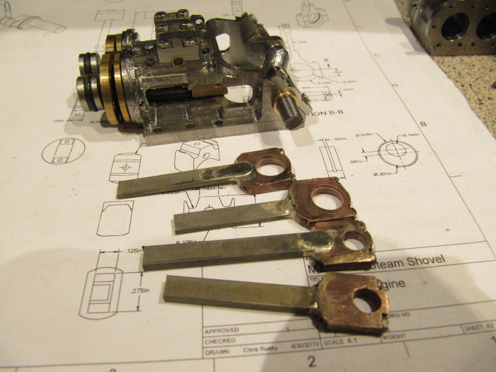

« Reply #4314 on: July 21, 2019, 11:23:20 PM »
Today saw the big ends notched for the arms, and the arms notched to match, the pairs silver soldered together. Here they are just out of the pickle bath, ready to get drilled for the small end pins and then get the rest of the profiles milled in..

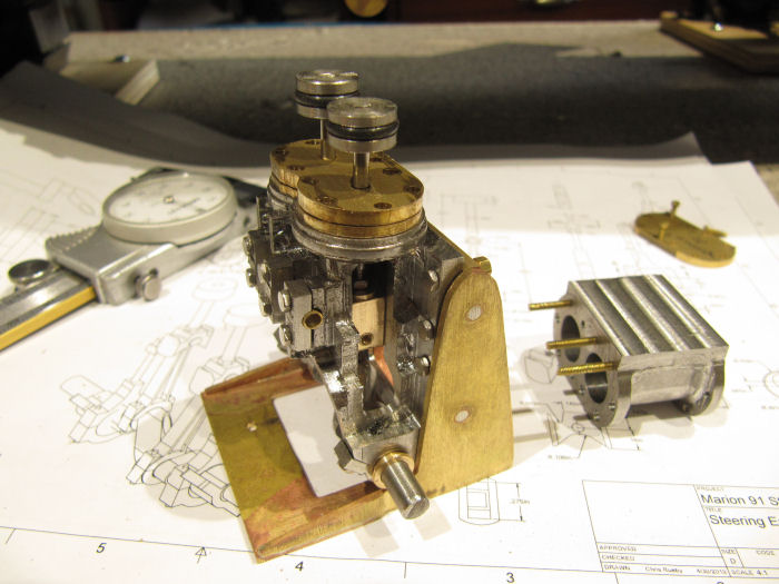

« Reply #4317 on: July 22, 2019, 05:20:15 PM »
This morning got the con rods and eccentric followers milled/sanded to profile:
and assembled onto the engine:
Here is a quick video of the parts going round and round...
[youtube1]https://youtu.be/0R4ApQlBllA[/youtube1]
With the cylinder slipped on, and the crank turned, there is smooth motion and good suction on the ends of the cylinders, so the piston rings are a good fit.
