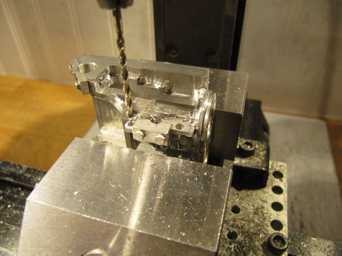

Getting to work on the valve and throttle bearing blocks this morning, started with fitting the blocks for the caps and drilling the cross holes for the valves and throttle, also the holes in the lifting rings behind the bearing blocks:
Next will shape the tops of the caps down to size...
  • Posts: 18712
« Reply #4280 on: July 17, 2019, 08:13:54 PM »
Caps trimmed down and bearings made/installed, these are simple tube bearings so quick to bore/turn/trim to size.

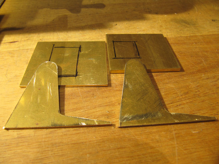

Changed my mind on which parts to make next, going to do the stand which holds the steering engine up vertical on the cab floor. This is made from some sheet stock, rough cut then trimmed down on the mill, clamped to the wood block I used when making the booms many moons ago.
Here are the parts shaped to outline, next will cut the openings in the vertical plate and the base plate, then can drill for some temp screws to hold it all together for silver soldering the joints. I assume that the openings are there for access to the big end caps and to allow the rods/eccentrics to slide in from underneath during assembly, maybe also to reduce the amount of metal needed in the castings, the openings are there in the original.
