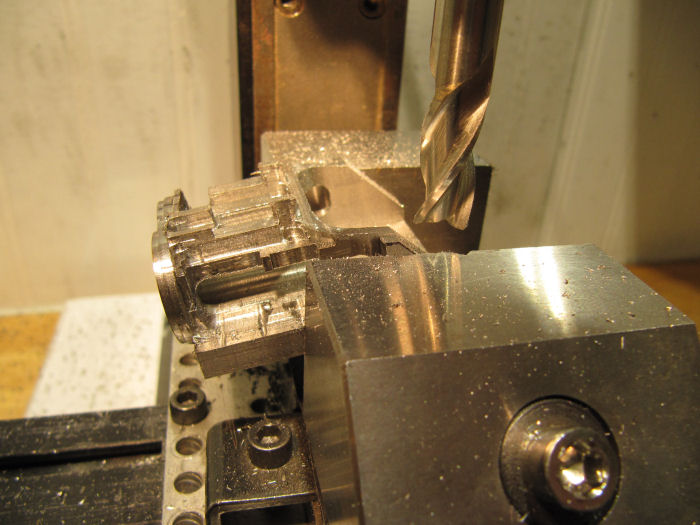

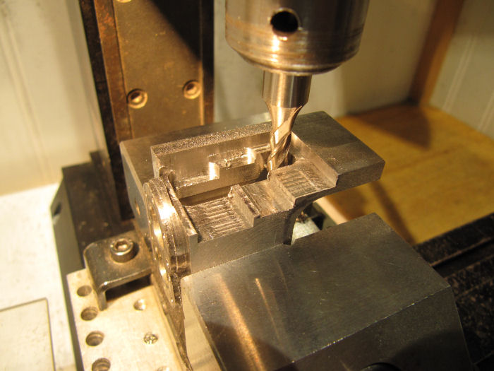

Thanks Achim!  A hawk showed up and scared the elves back into the shop today, so they, um, I... are getting some more work done on the engine block.   :Lol:
Got the recesses in the side milled down:
and cut in the openings into the crosshead tube so the eccentric followers will be exposed, for the levers that bring the motion up top. On this engine I am trying the alternate approach that I considered on the crowd/slew engines, cutting all the way through from the outside towards the crank bay, rather than broaching the notch from the inside. The remaining metal is super thin anyway, so I will add that back as a panel on the outside.
Part so far, ready for cutting in the top surface to leave the bearing block bases for the valves and throttle.

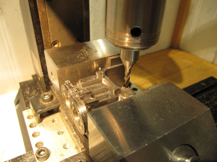

Got some more done this afternoon, took the top surface down to shape, leaving the bearing bases for the valve and throttle levers:
Part so far, ready to take the crank bearing face down:

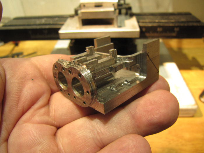

  • Posts: 18708
« Reply #4257 on: July 12, 2019, 09:24:33 PM »
Some more nibbling away at the engine block, sawed off the angle of the crank bearing block, then trimmed the last bit with the end mill:
and trimmed the top of the crank bay back at a slight angle to match the originals:

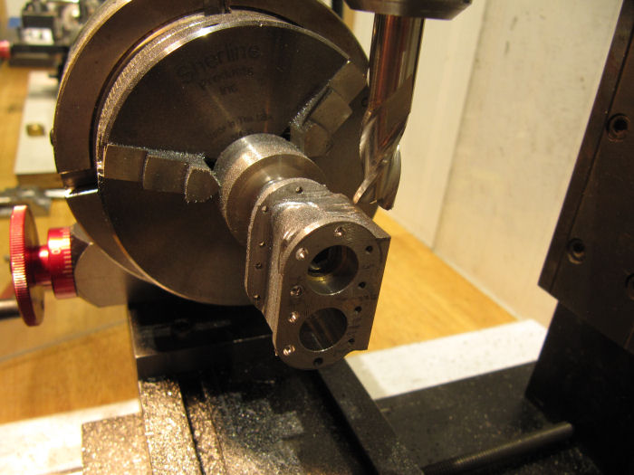

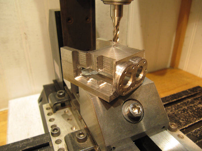

Now back to shaping the outside of the cylinder block. The center section needs to be taken in to leave the end flanges. Started by taking the bottom flat area down to size:
then setting up the arbor on the vertical rotary table again to shape in the curved section, ending where it meets the steam chest base:
One side down, one more to go...
