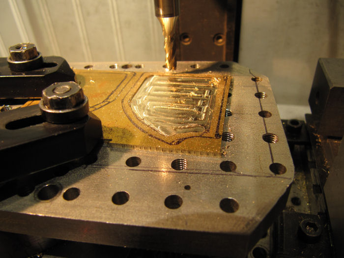

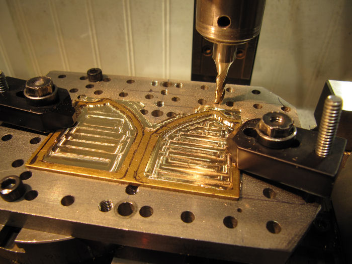

More on the smokebox assembly, started in on the doors by recessing the centers with the two doors still attached in a larger piece of sheet stock:
then going around the edges to trim then mostly to shape, to be followed by cleanup on the belt sander after they are cut apart.

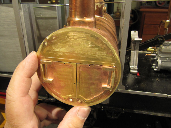

Before cutting them apart, drilled/tapped some 1-72 holes in the perimeter for the hinges and the steel heat shields that will be on the inside of the doors.
Some sanding on the edges, and attached the posts for the hinges. The posts are held on with screws for the silver soldering step, then the screw heads will be filed off. The screws holding the blocks on the main ring were replaced with some countersunk head brass screws, sunk in just a little so the heads could be filed off.

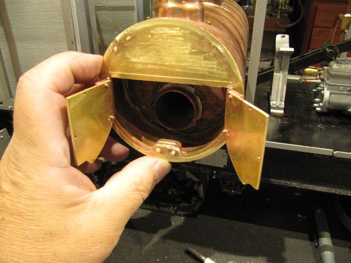

This morning saw the hinge posts silver soldered onto the smokebox front plate, and the hinge posts on the doors drilled and trimmed to length:
Took a little filing on the edges to get them to open/close fully, but working well now.
Took a little filing on the edges to get them to open/close fully, but working well now. Next step is to install the name/number plates, and make the steel heat shields that go on the inside of the plate and doors, simple plates on little stand-offs. Then will drill/tap the mounting holes through the boiler shell.

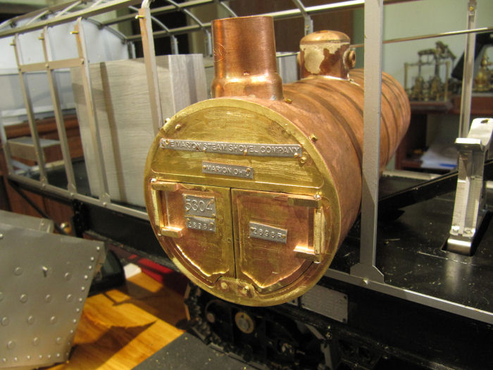

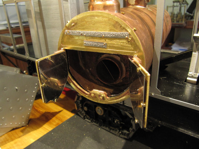

Getting close to finishing the boiler parts - got the name/number plates riveted on with some 1mm rivets, and cut out/drilled/tapped for the inner steel heat shield pieces, which are some thin stainless sheet stock I found at the local hobby shop.

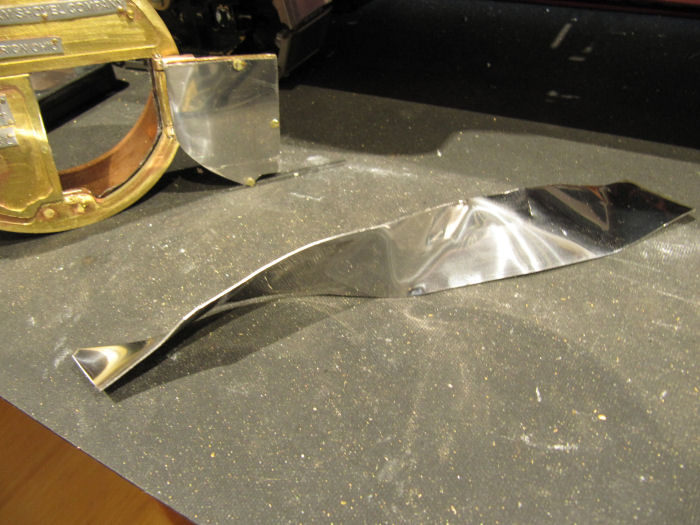

Inside the firetube I am taking the advice from Rod and putting in a twisted piece of stainless to act as a turbulence generator to get the hot gasses to flow along the tube sides. I've never tried this before, but he says that it will increase the efficiency, sounds like it should work out.
Here is the smokebox front wall/doors installed, with the lettering on:
Doors open to show the heat shields in place, offset from the brass with nuts to leave an air gap. This is not just for the model, the real one has the same thing on it.
I think the only bit left is the adapter ring for the burner, which is made for a 28mm OD tube, my firetube is 1-1/4" so it needs a little step-down ring to make it fit. Then I can give the boiler a coat of paint (I am using automotive ceramic engine paint so it can take the heat) and get things assembled and pressure check the joints to the fittings.
