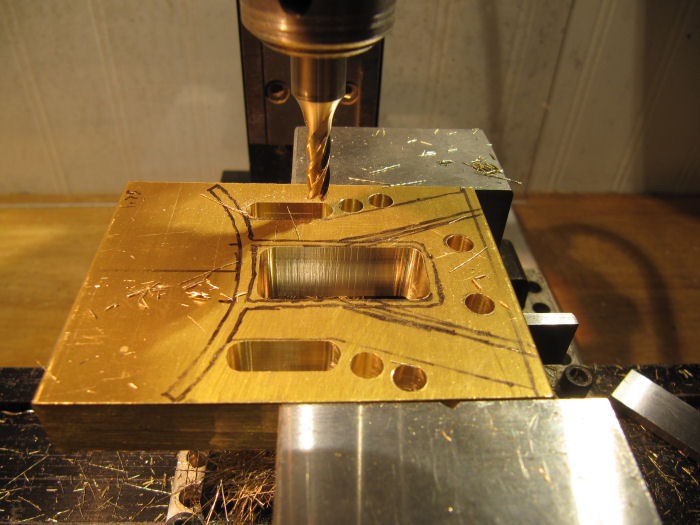

With the boiler well in hand, time to hold it up - starting in on the front support frame, which on the real machine is a big casting that holds the smokebox end of the boiler up, straddling the middle of the A-frame backstay bars. Laid it out on a chunk of brass left over from the track frames, and chain-drilled around the openings:
That made the initial milling go faster - the center is cut all the way through as is the top arms, the areas around the center will only be taken partway through to leave a center flange.

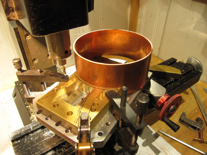

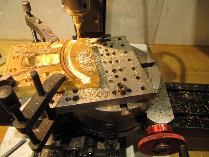

Then set it up on the roatary table, with the top arc centered on the center of the rotary table. Took a series of cuts to remove the upper part of the bar:
and trimmed that till it fit the boiler closely:

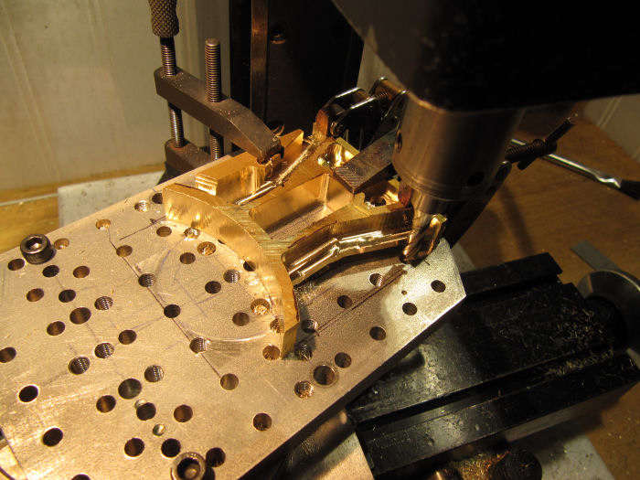

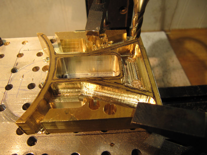

Then started taking down the flange areas - the bar is 1/2" thick, cutting .200" in to leave the .100 flange. The rotary table was handy to do the angled sections too, rotated till they were lined up with the axis of the mill table.
One side done, will turn it over and do the flanges on the other side next, then trim away the sides - they are useful for holding it till then.

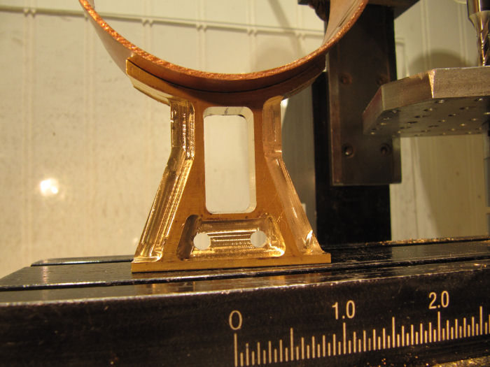

After lunch (uuurrpp) got the other side of the support stand milled in, then started taking off the outer pieces:
and here it is, with a offcut of the boiler shell, ready to drill the mounting holes to hold it to the boiler and to the brace in the main frame:
