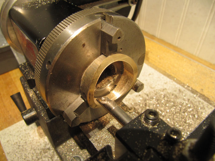

Time to steam up the dome... Or make the steam dome...

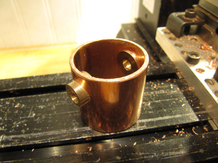

Started with a short length from the firetube, and drilled/bored holes in the side to fit the bushings made the other day.
test fitting the bushings, flanges on the inside:

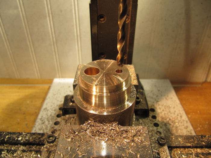

Then turned up the cap piece from some bronze. The base is stepped to fit the tube, and it is drilled/tapped through for the water fill fitting and the safety valve.

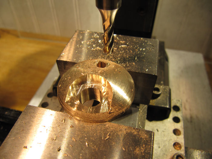

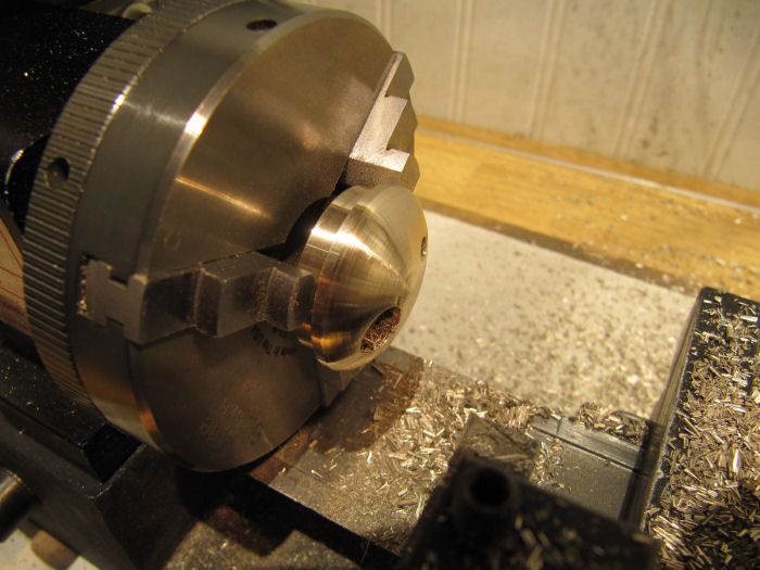

Then cut off the piece from the longer bronze bar. Back on the lathe, the top is domed to look more like the original:
To get the fittings to fit down flat, milled in around the holes:

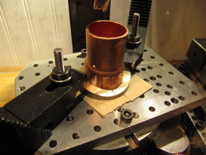

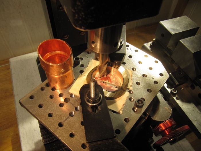

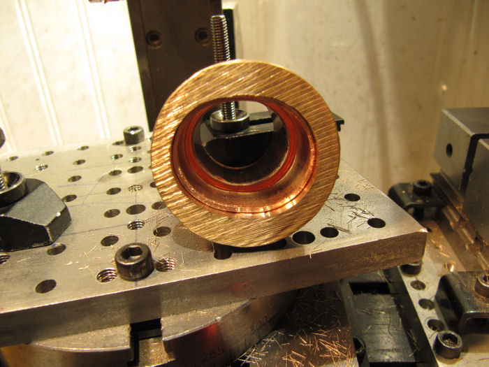

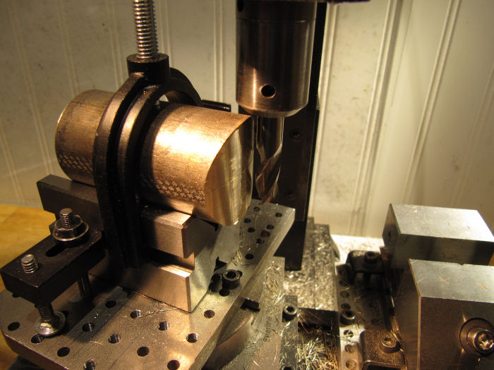

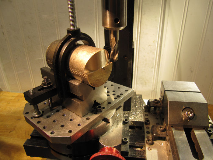

To hold the dome in place on the boiler shell, I made up a curved piece to fit the inside of the boiler. Started with bronze bar held in a V-block on the rotary table, set to get the proper radius, and started milling. The cutter was long enough to reach halfway through the bar, so started with the top half:
then lowered the mill head to do the bottom half:
Checking the fit on the boiler tube, using the offcut from trimming the tube to length:

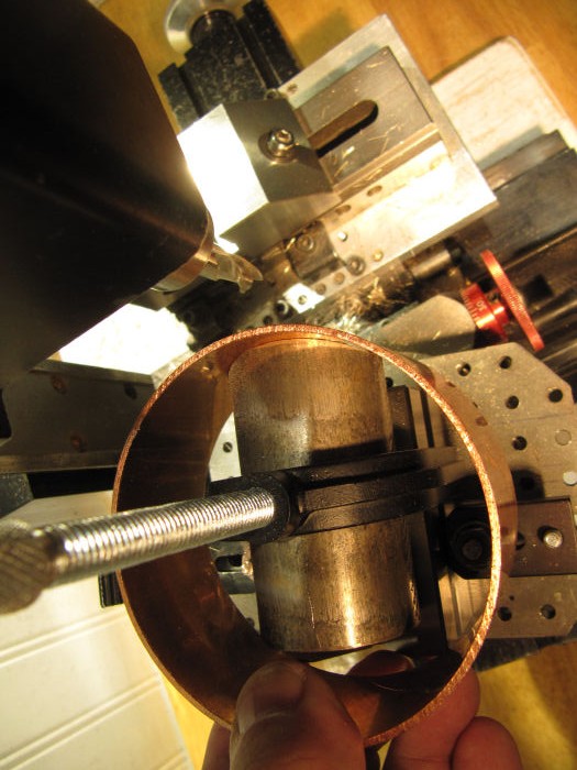

Cut the part off the bar on the bandsaw, and mounted it on the lathe to drill/bore the center out to fit the outside of the steam dome tube:

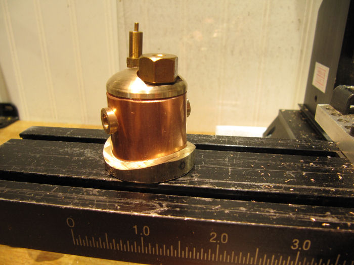

Here are the parts so far:
The top assembly will be silver soldered up seperately, then it will be assembled onto the shell with the lower flange inside and then soldered to the shell. The lower flange gets a brass setscrew to hold it in place for soldering - this is not structural, so should be okay - Kozo did this a lot, so I am assuming it is okay to do.

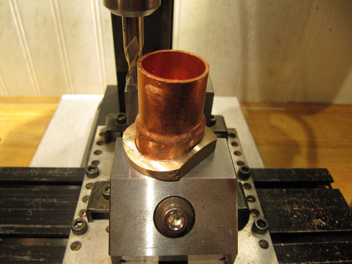

This morning finished off the stack base, had forgotten yesterday to flatten the sides of the flange so it fits in the smokebox:

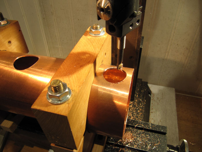

Then got out my handy-dandy boiler-shell-holder-clamps - made these for the Lombard model, just needed to enlarge the arcs since this shell is 1/2" larger diameter. It bolts to the mill table, and the threaded rod on either side clamps down on the tube to hold it for drilling/milling. The centers of the arcs on the bottom halves are lined up on the centerline of the table, and are at the same height, so it holds the tube level and square to the table.

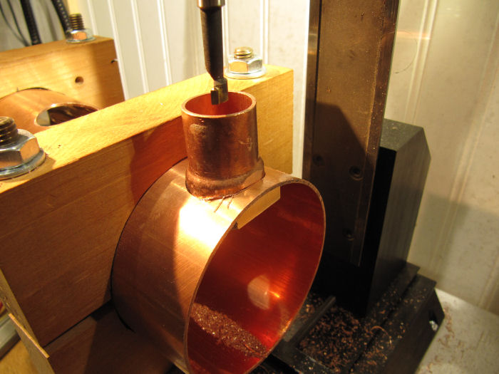

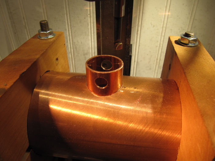

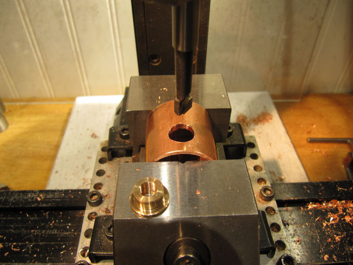

With the tube and clamps positioned so that I could do both the steam dome and stack holes without having to move any parts (to keep them in line at the top of the tube), drilled the starter hole for the boring head.
and then bored the hole out till the steam dome tube fit through. Fortunately this shell is large enough that I can get a hand in from the end to insert the dome, otherwise would have had to make a holder for it.
Then cranked the table over for the stack hole, starting to drill/bore that out as well...

Continuing on with the boiler, bored out the hole for the stack base to the front-to-back width of the base, where it was flattened.
Then, moved the table in a bit at a time and took a pass with the boring head till it was half the difference between the short and long dimensions on the stack. Then, back to center and did the same while moving the table outwards. This enlongated the hole for the base. A couple of test fits and took a few thou more off till it would go through the hole.
To hold the stack in place, drilled/tapped for a couple of 1-72 screws. The stack base does not need to hold pressure, so this joint will not need to be silver soldered, the screws will hold it on.

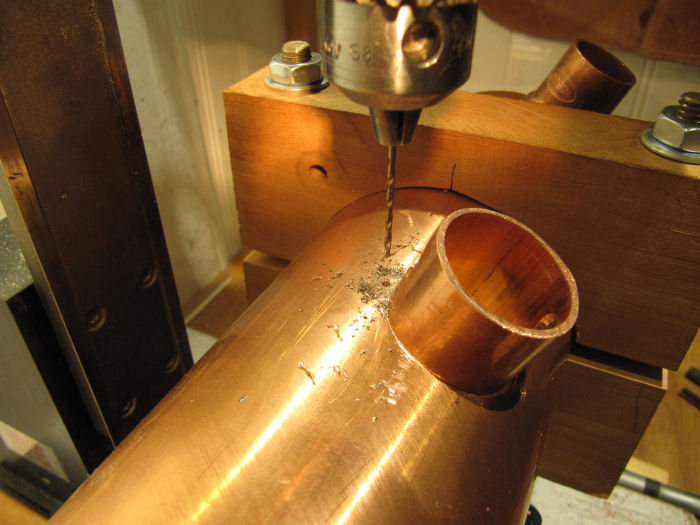

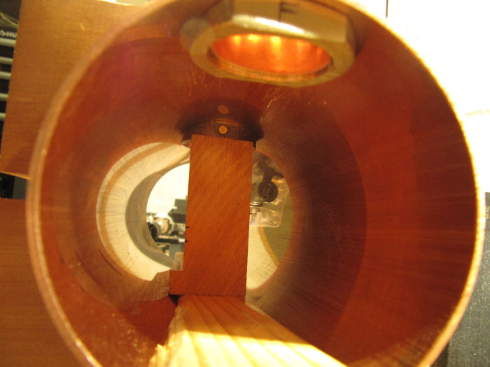

The steam dome WILL be silver soldered in place, and to keep it from shifting while soldering I drilled for some small screws there as well. To hold the dome in position for drilling, found a block of wood and a wedge the right size from the inside since it is way too far in for a clamp to reach:
and drilled/tapped from the outside, down through the base flange.
Here are the parts so far, almost ready for soldering things up:

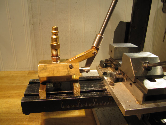

Been making up the blanking plugs for the boiler static testing, also got a new body made for my hand pump that uses o-rings and flat plungers rather than small ball bearings for the check valves, like someone posted a drawing of here a while back. Curious to see how that works out, I always have trouble getting a good seal with the bearings, they work for most use but for static test they tend to seep just enough to cause a slight pressure drop. The rest of the parts on the pump are from the old one.
I have a long bar of surplus hex stock that I have had on the shelf, made a great blank for the body withouth having to silver solder anything up for the shape, it is large enough for all the passages as is.

It was me that posted some drawings of the hand pump I made using flat valves and O rings which works really well.
When testing my boilers I also use a one way valve in the pipe from pump to boiler
Rich
